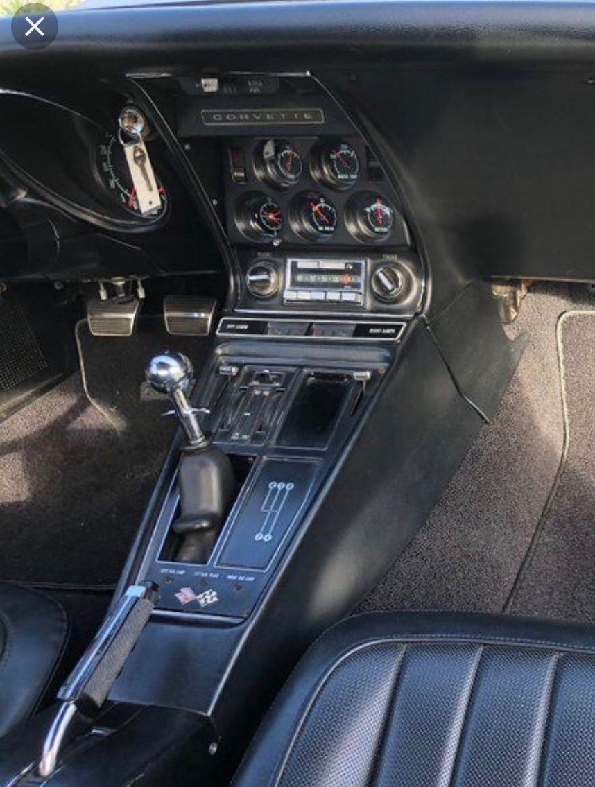

Not the best picture but the plate just below the radio holds the lenses for the front lights.

I had that part of the console stored away ! Yes, I see them now.
But I cannot find the optic tubes coming from the front lights inside of the car. I don't find them anywhere in the harnesses ! The 3 for the rear lights are there coming out of the main harness !
