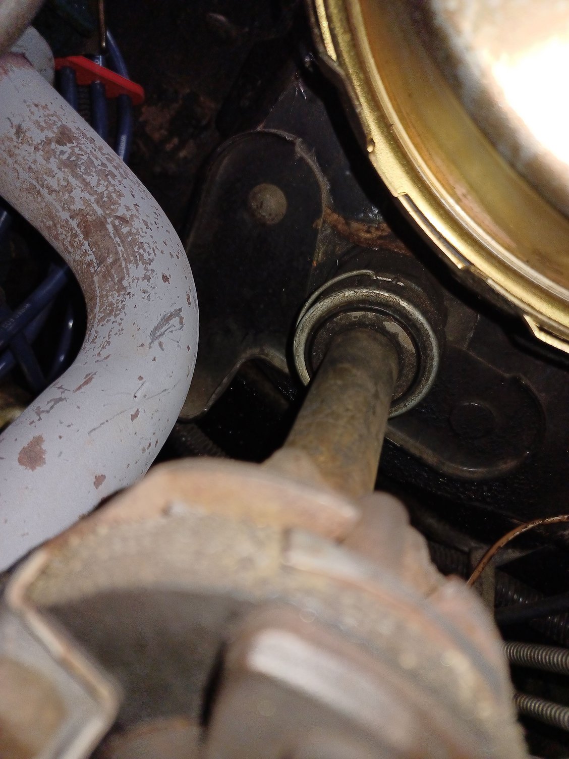

Open the hood and look for a rod sticking out to the right side of the steering column and see if that 'rod' is all the way up.
Old Jul 25, 2022 | 08:02 AM
Budltbeard's Avatar
Budltbeard
Joined: May 2021
Posts: 65
Likes: 5
From: Jacksonville, FL
Thanks Peter. I don't see a rod anywhere. What am i not seeing?

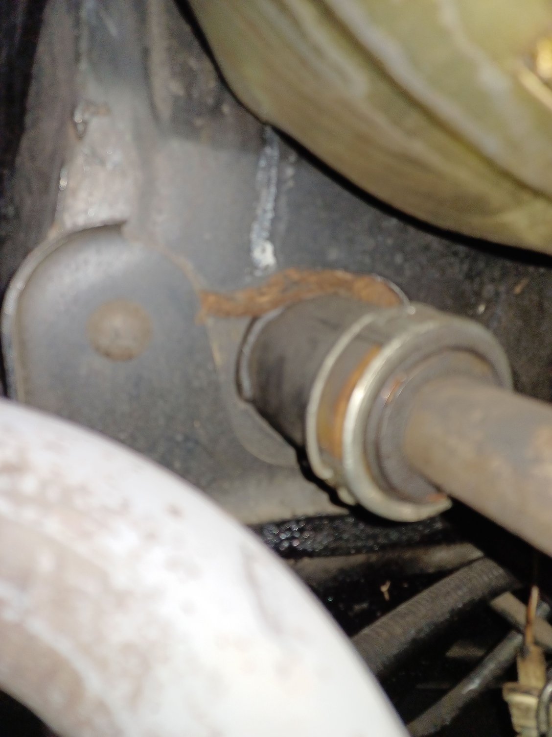

Old Jul 25, 2022 | 08:07 AM
Budltbeard's Avatar
Budltbeard
Joined: May 2021
Posts: 65
Likes: 5
Old Jul 25, 2022 | 11:59 AM
Bikespace's Avatar
Bikespace
Joined: Mar 2017
Posts: 11,949
Likes: 4,507
79s don't have that rod. I think that went away in the mid 70s, and was often bypassed with some wire. The 79 does have a little lever at the ignition switch that you push down to remove the key. Is that still intact.

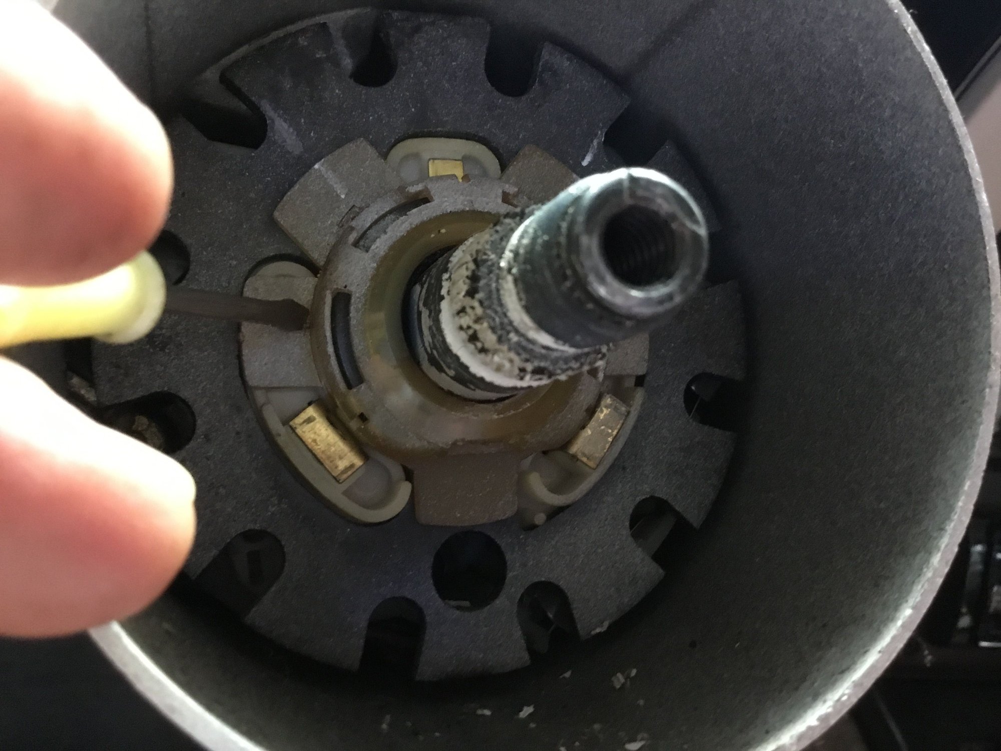

I have gone through Jim Sheas papers but I didn’t see anything about removing this part. It is now cracked in multiple places from gently trying to pull it up. I think it has to do with the turn signal but I am not positive. Does anyone know what it is called and how it it is removed? Thanks!

1979 with tilt and telescoping. Cruise control on the blinker too.

Is this the part that is about to break?
https://www.zip-corvette.com/69-89-t...-retainer.html
Old Jul 25, 2022 | 06:00 PM
Budltbeard's Avatar
Budltbeard
Joined: May 2021
Posts: 65
Likes: 5
Yup, that’s the part.

Have you tried to push something down between the inner part of the plastic and that center spoke? Just can't believe that will not pop out. Good luck with your project.
Old Jul 26, 2022 | 11:11 AM
70s's Avatar
70s
Joined: Jun 2018
Posts: 282
Likes: 139
From: NH
The C-clip is probably backed out of the shaft slot enough to put pressure on the retainer (stuck plastic part). Not the difference of the spacing between the retainer and the shaft and how at the C-clip has pushed it. Push/Seat the C-Clip back into the shaft then try removing the plastic retainer. Use a flat screwdriver tip aimed into the slotted hole (top of kansas123's pic near arrow) in the retainer opposite of the flat side (bottom of pic).
