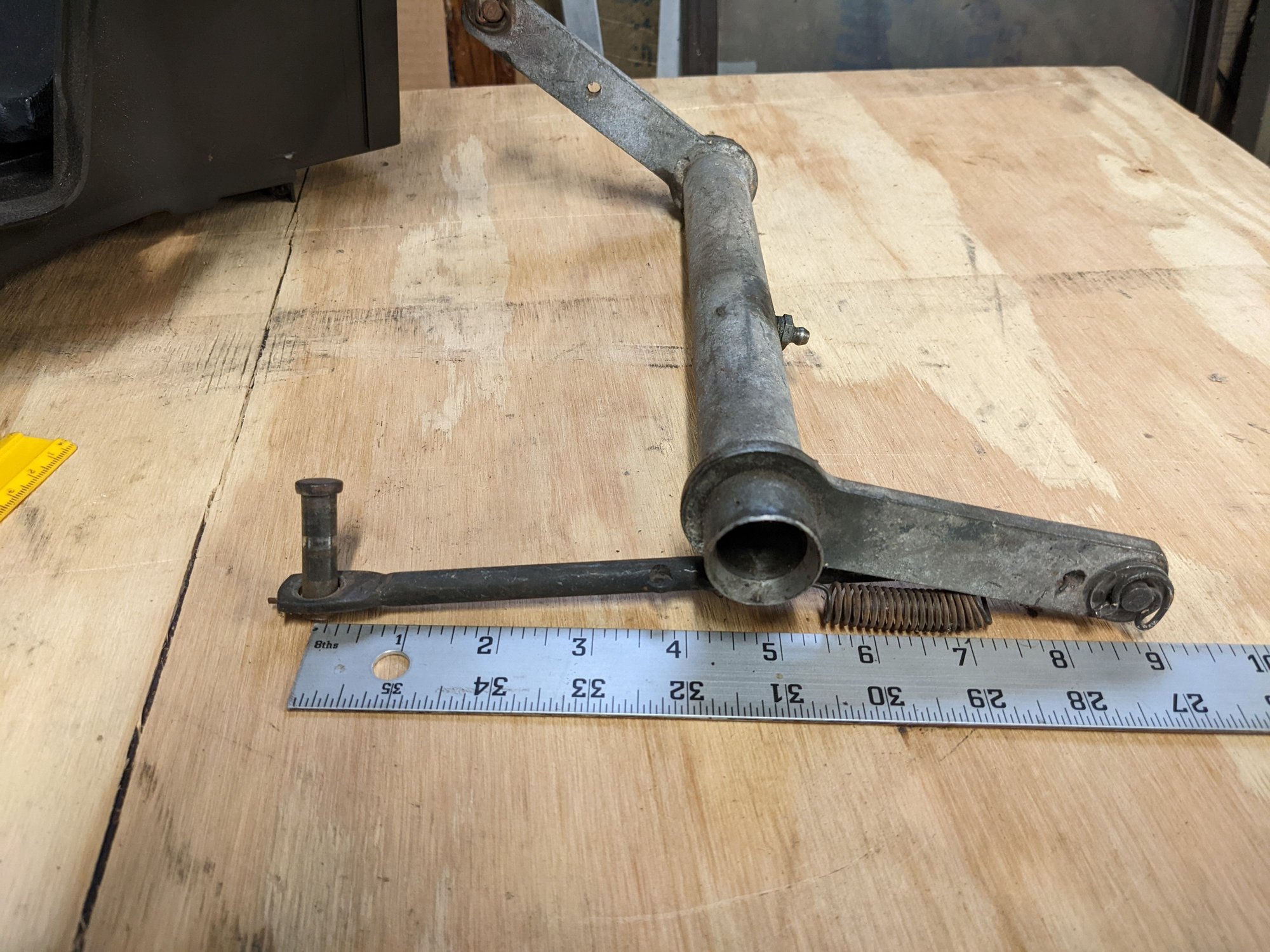

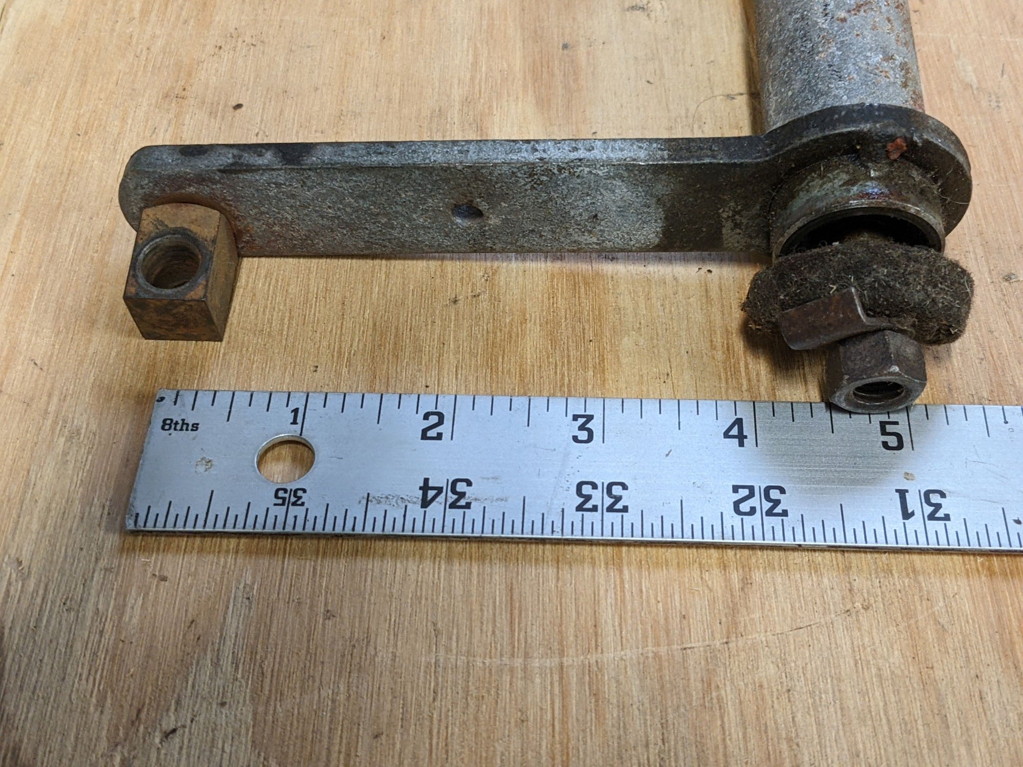

Could you please send me a picture of your Z bar. I modded my for shorter pedal assembly throw. I use a manual clutch and it's easy
Gkull: found my 72 z-bar and took pics as requested with a ruler. Am curious how you modded yours and how did it work out?
4.0" and 8-3/4"...block side?
4-3/4"....clutch pedal rod side?

I had a hard time getting a picture on the car! From the Z-Bar cross bar I drilled extra holes. Upper top is 4 inches, middle is 3.5 inches and lower is 3 inches. bottom has a 3.5 and a 4 inch hole.
Presently I'm 3.5 top and 4 inch bottom. Making for less foot pedal movement to open the PP from the clutch and flywheel.
