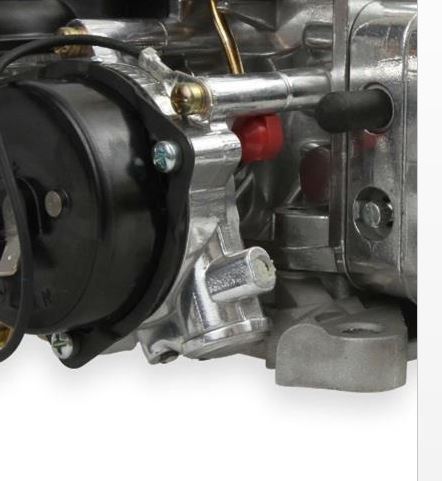

Originally Posted by Eric P
Those models don't have choke pull offs
Yes, they do. The choke pulloff is an old, horrible design used since the 1960's. It's a vacuum-actuated piston contained inside the choke housing, and it opens the choke a set amount depending on the resistance applied to the piston (choke housing windup). Vacuum is applied to the one side of the piston from a vacuum passage from the housing piston bore into the carb, and there is a fixed "bleed-off" channel to allow the vacuum to bleed, allowing the pulloff to vary its stroke length depending on the spring resistance of the choke cover.
The Holley choke pulloff is a piston located inside this bore/cylinder inside the choke housing:
Lars
