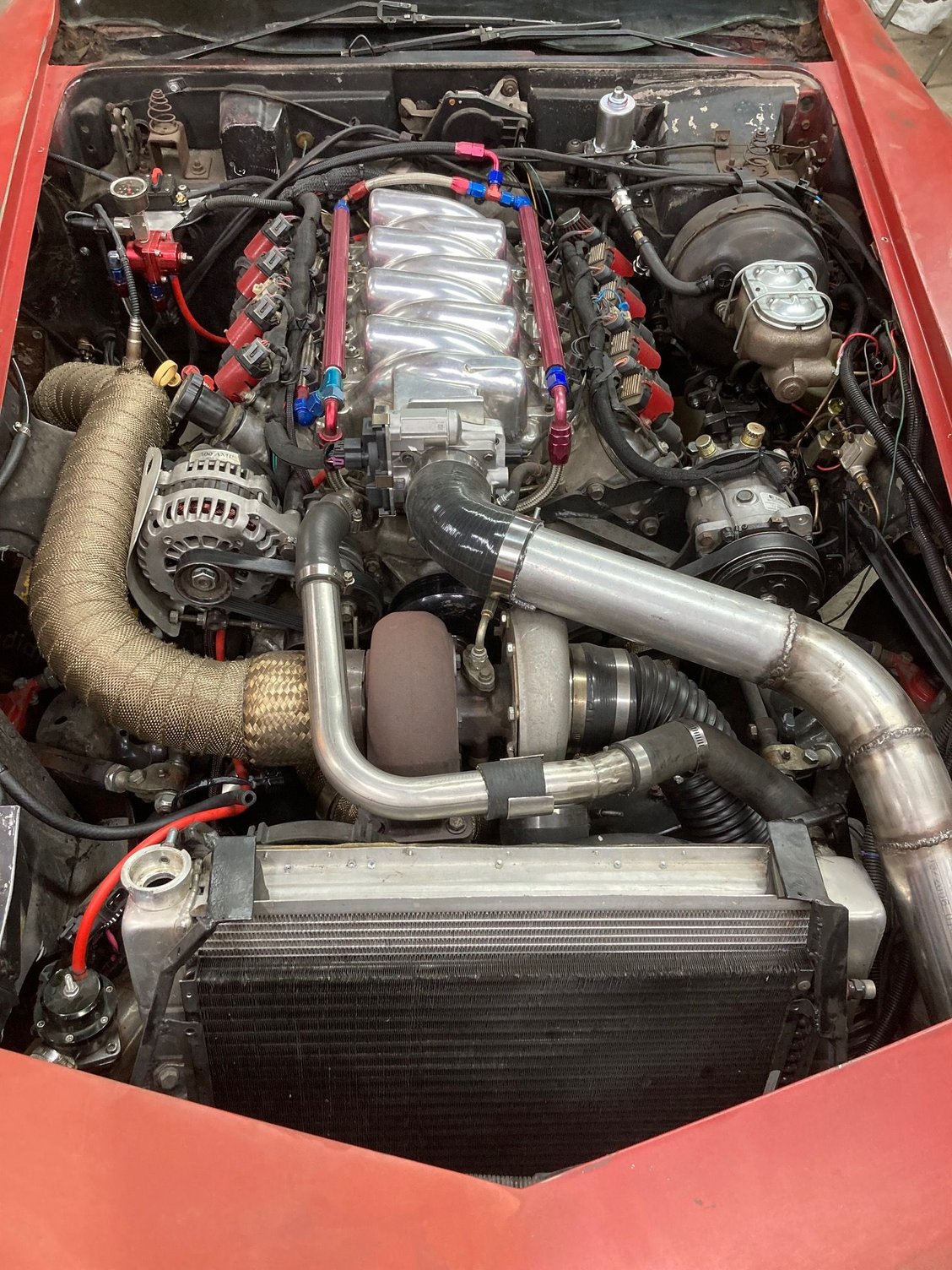

The LM7 5.3L 2002 engine are practically free, they can be found in the corners of many shops and overwhelming in number from junkyards.
Turbocharged and essentially untouched they will easily 600rwhp for 200,000 miles and longer, like a factory engine, extremely reliable. My sig has an example.
As reliable daily drivers go there isn't much that can beat an older chevy truck from 02-05. Those ideal years because the electronics of Gen3 and Gen4 is simple, adaptable, very basic, easy to wire and control. Less features in the engine means less crap to go wrong, no DOD or AFM or VTC or whatever. Just the basics.
Put an LS1 intake on the 5.3L LM7/L33 and it will clear the hood. Use the OEM fuel rail "dead head" and it will give reliability of a single inlet port, without all the fittings and extraneous garbage that aftermarket rails carry.
Avoid AN fittings and use basic hose clamps to make most of the fuel system work (example in my build thread at 600rwhp track legal)
Keep factory lifters, pushrods, heads, etc... Do not port or modify the heads. The quality isnt there enough to invest the money and time of port work.
Definetely swap the cam/springs. I use TFS-30602001 and PAC1218 because this is a very slow ramp cam rate, mediocre lift, works with stock pushrods and lifters, and weak springs that will last 100k and longer mileage. Together these components support 600-800rwhp using a turbocharger fwiw so it's not like you give anything up with forced induction.
The key to valvetrain longevity is the low lift, slow ramp, weak spring as above, even if power isn't forced inducted if the goal is daily driving and low maint you need these ideas.
Compression of LM7 9.5:1 means 87 octane friendly. I've successfully 400rwhp using 87 octane and 5psi of boost. Good tuning is essential and monitoring of fuel, oil, exhaust temps is critical to getting the most safety from gasoline fuels.
Use synthetic oil obviously. CHange all the seals, gaskets, etc... use a seal alignment tool. Get the updated BARBELL from saccity corvette and their alignment tools if you can swing it. Most of the cost of the LS swap is in the small details. I recommend a budget of 15k just in nickle and dime parts.
The transmission is a touchy subject. I recommend 4l60e for low power (< 400rwhp) daily drivers but they are hit and miss with respect to junkyard pulls.
A rebuild properly will set you back several thousands. It's a tough decision there.
The 4l80e is great for 500rwhp+ But it will absorb so much fuel economy for <400 than its kind of crazy.

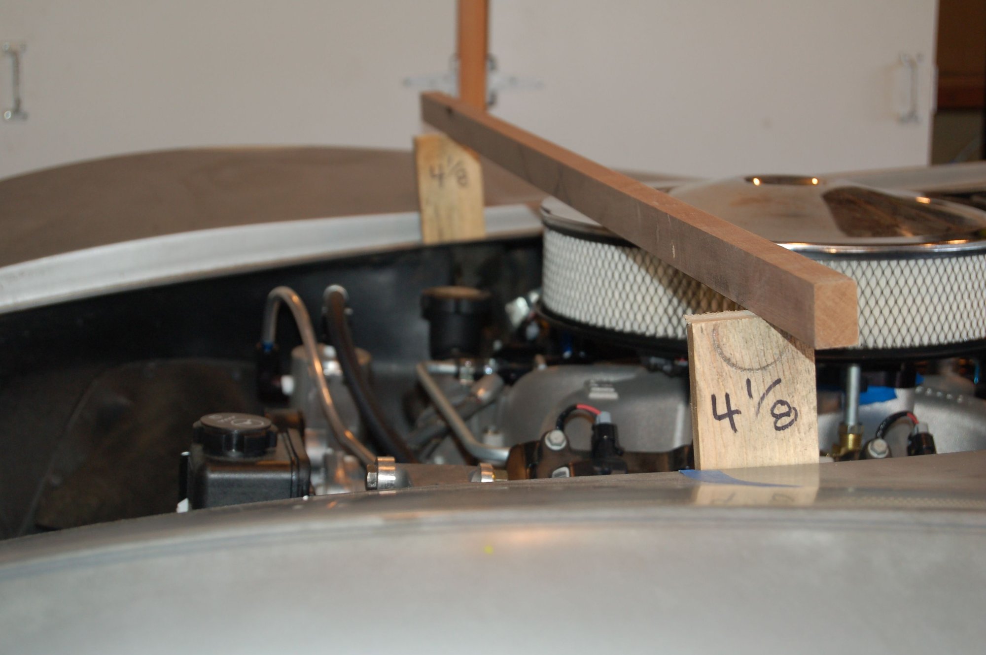

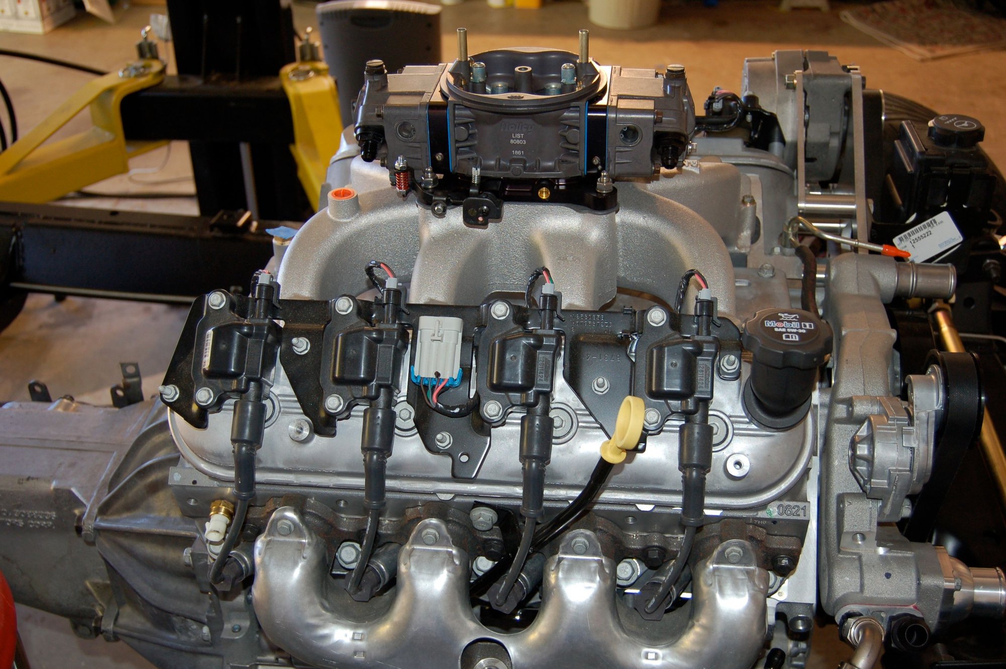

ignatz, looks like your carb/intake combo will fit under c3 big block hood, but, do you know for sure?
Old Aug 6, 2022 | 01:36 PM
  #34
ignatz's Avatar
ignatz
Joined: May 2004
Posts: 4,364
Likes: 1,588
Originally Posted by wolfk
^ All good reading and info, thanks
It very likely could fit but I don't have all the measurements. Right now I have a drop base and a 4" air filter so there is room, my hood is not that huge. I probably have a 3" somewhere. If you have a serious interest in going carb'd, I can duplicate these pictures. As I remember I made a mistake somewhere here when I took this picture, but what it was escapes me at the moment. I think it was that the body was not attached to the frame, but it sure is now!
If you are simply curious, well ...... it might be a while! Otherwise PM me and tell me what you are up to and if I can help.

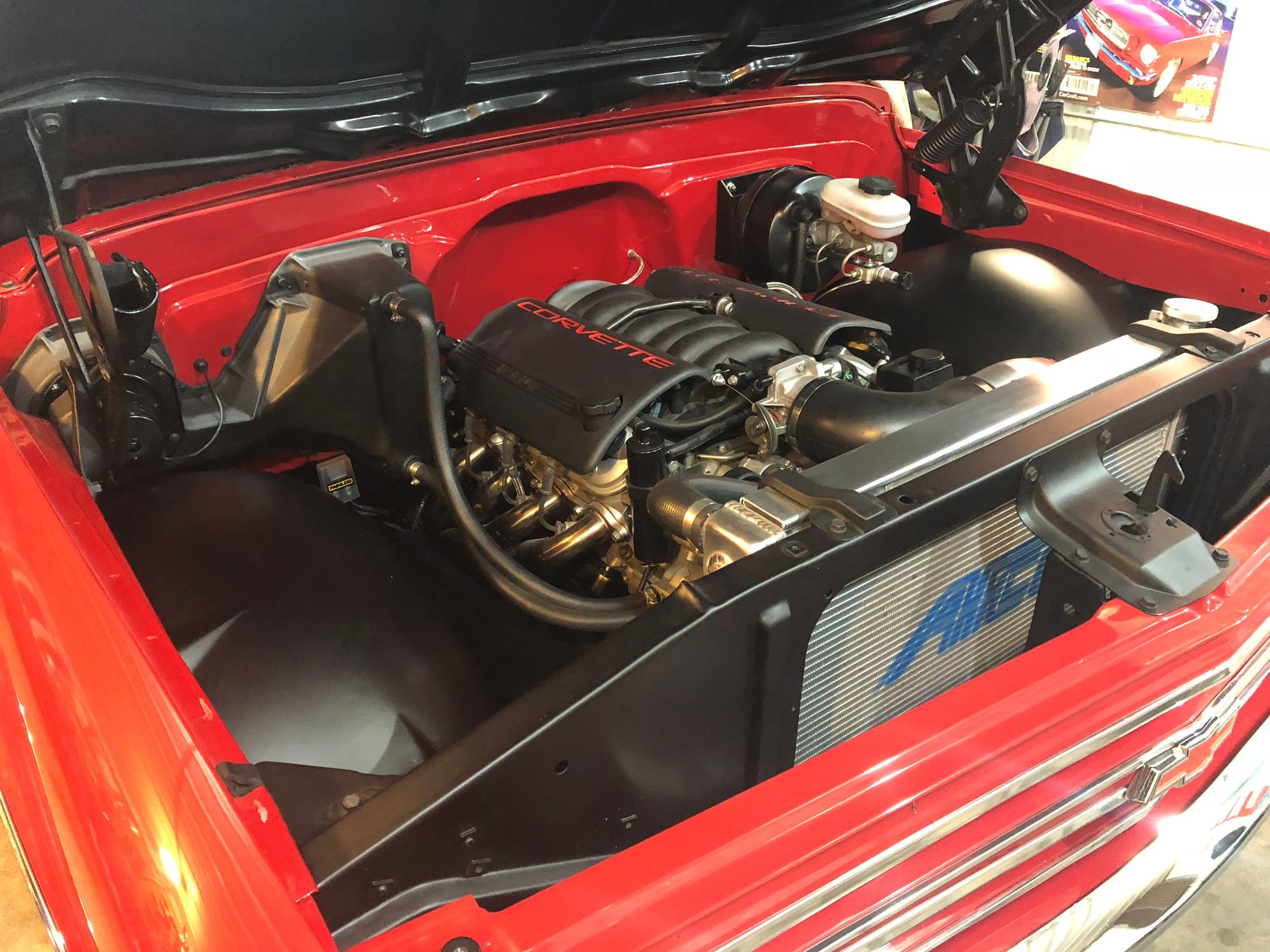

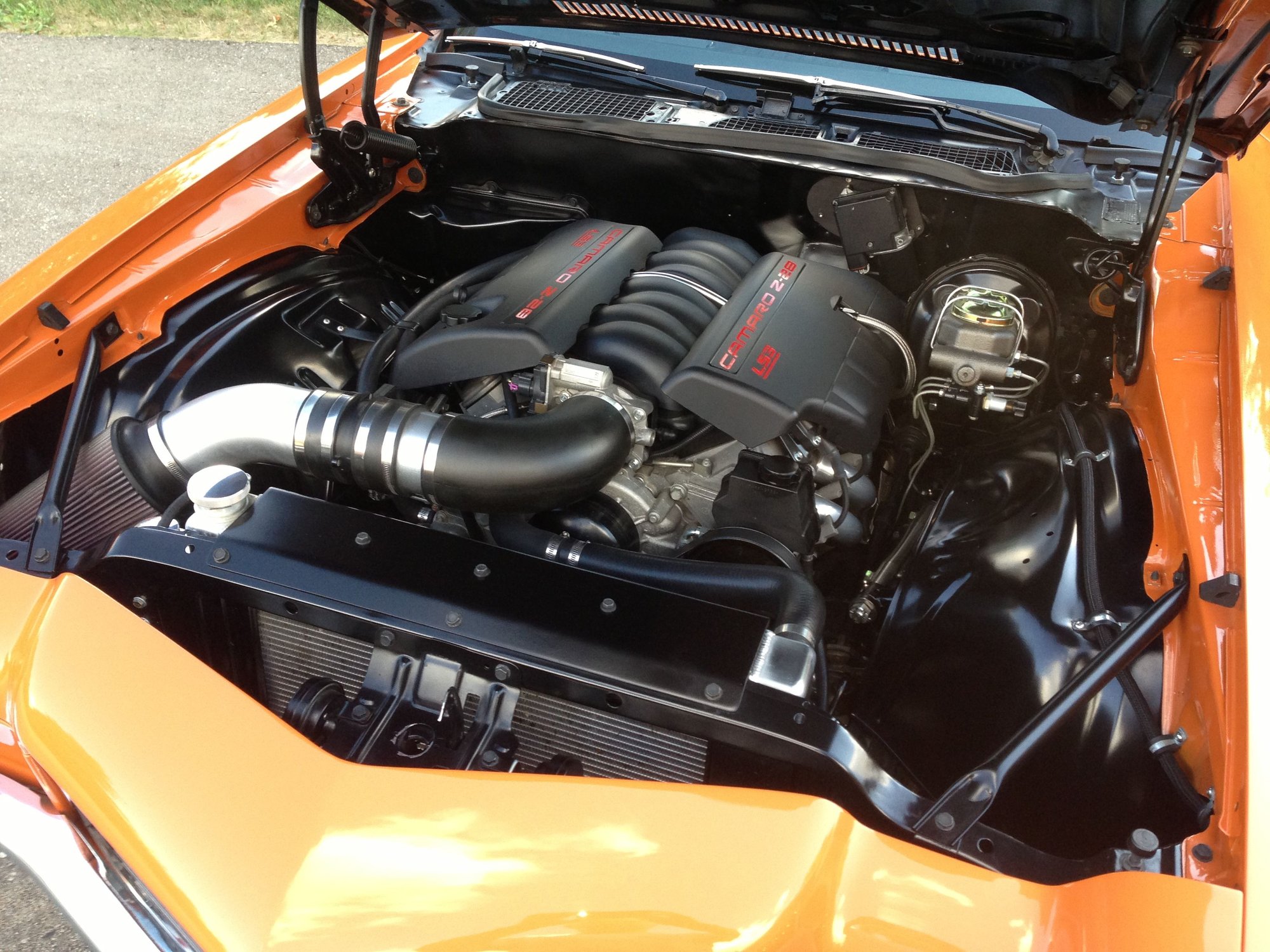

On my last few LS swaps I've used Yank billet converters and they have worked well. Just a single disc and 2800 stall. They drive like a stocker until you punch it. I don't tune anything but the couple tuners I have talked to and used have said some? torque management is a good thing.
My first LS/4L60E swap was a 2002 LS1/4L60E combo completely stock. The first time I drove I was shocked at the lags between shifts due the torque management. I thought there was something wrong with the trans. Took it to the tuner and he said they all shift like stock. He made it much better via the tuning again leaving in "some" torque management.
I think you can make a LS engine look good.
Couple of pics of my swaps. I try to hide every wire I can.
