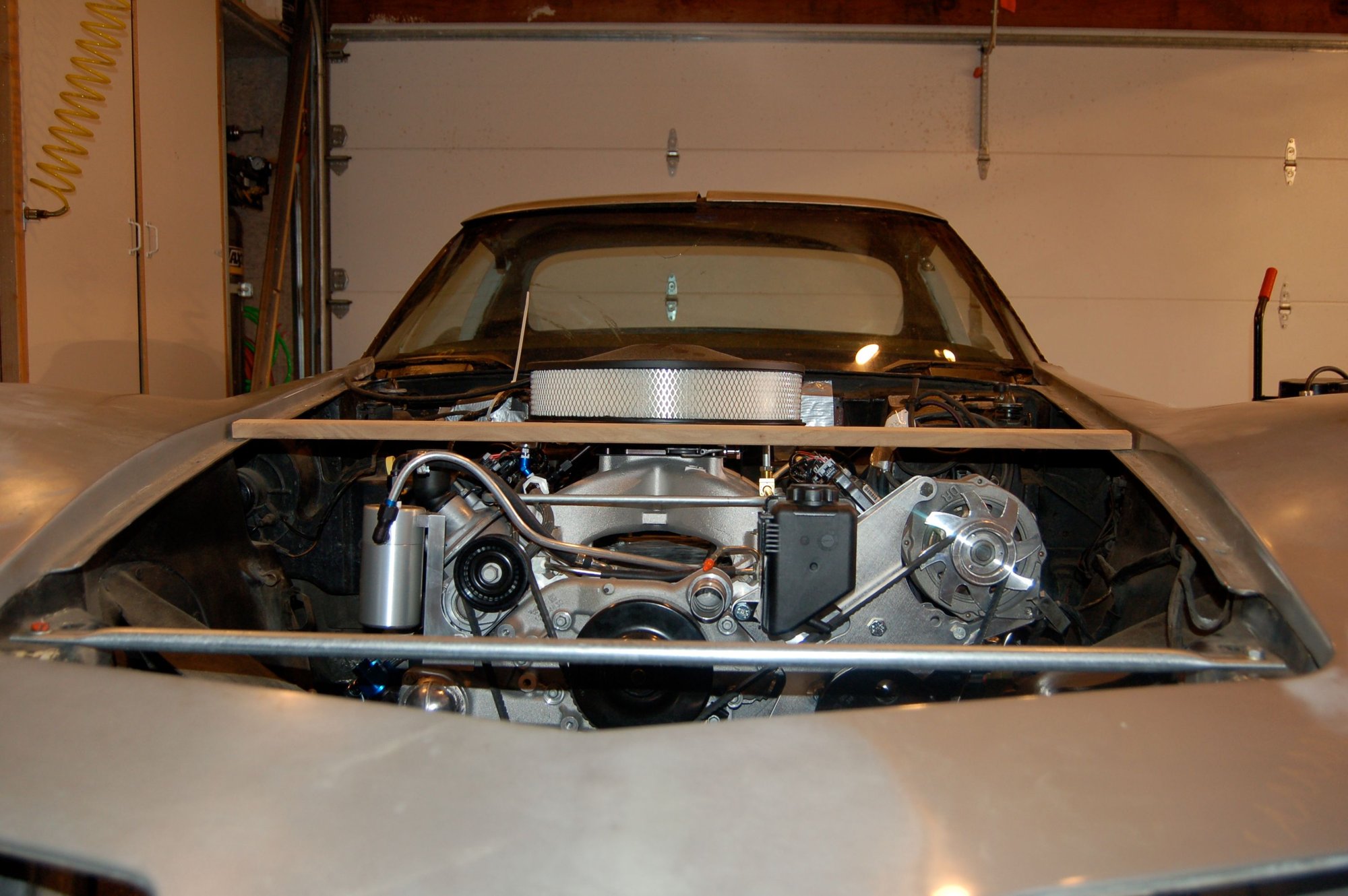

"might"? Ha. You will have a hood clearance problem! Plan on it or go FI. This is single plane but I don't think dual plane is much better. BTW there is an LS carbureted forum you should look for. You can find pictures of my car here with the hood on if you search a bit.

Your driveline is different than mine, so I can't say for sure, but since these motors sit higher, the driveline is likely to be outside the normal parameters for vibration free operation. I modified my differential mount to accommodate that and have had a decades worth of clean power. What solved my problem may not work for you but I ended up something called a W-arrangement. Keep that in mind as I encountered a lot of nay-sayers here who had never heard of it. Quote here:
The installed angle of the rear determines whether the driveline is Z or W arrangement which affects the angular velocity fluctuation in driveline differently during vehicle vibration. When the swing angle of the driveshaft is smaller than that of A frame, Style W is better than Style Z. Equations are given to solve the installed angle of the rear bridge in Z and W arrangements.
Mocked it up to reassure myself, not the usual angle setup
