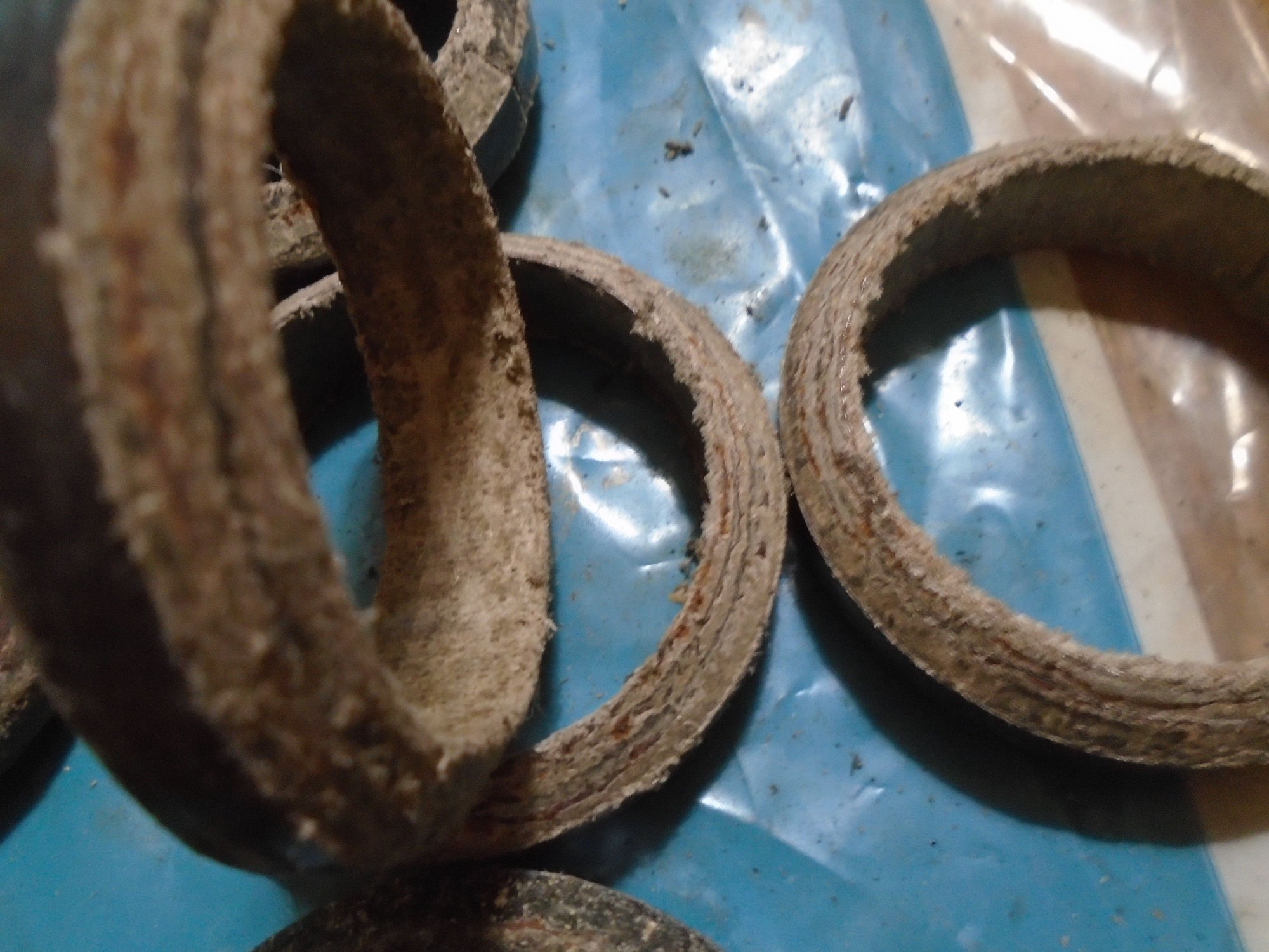

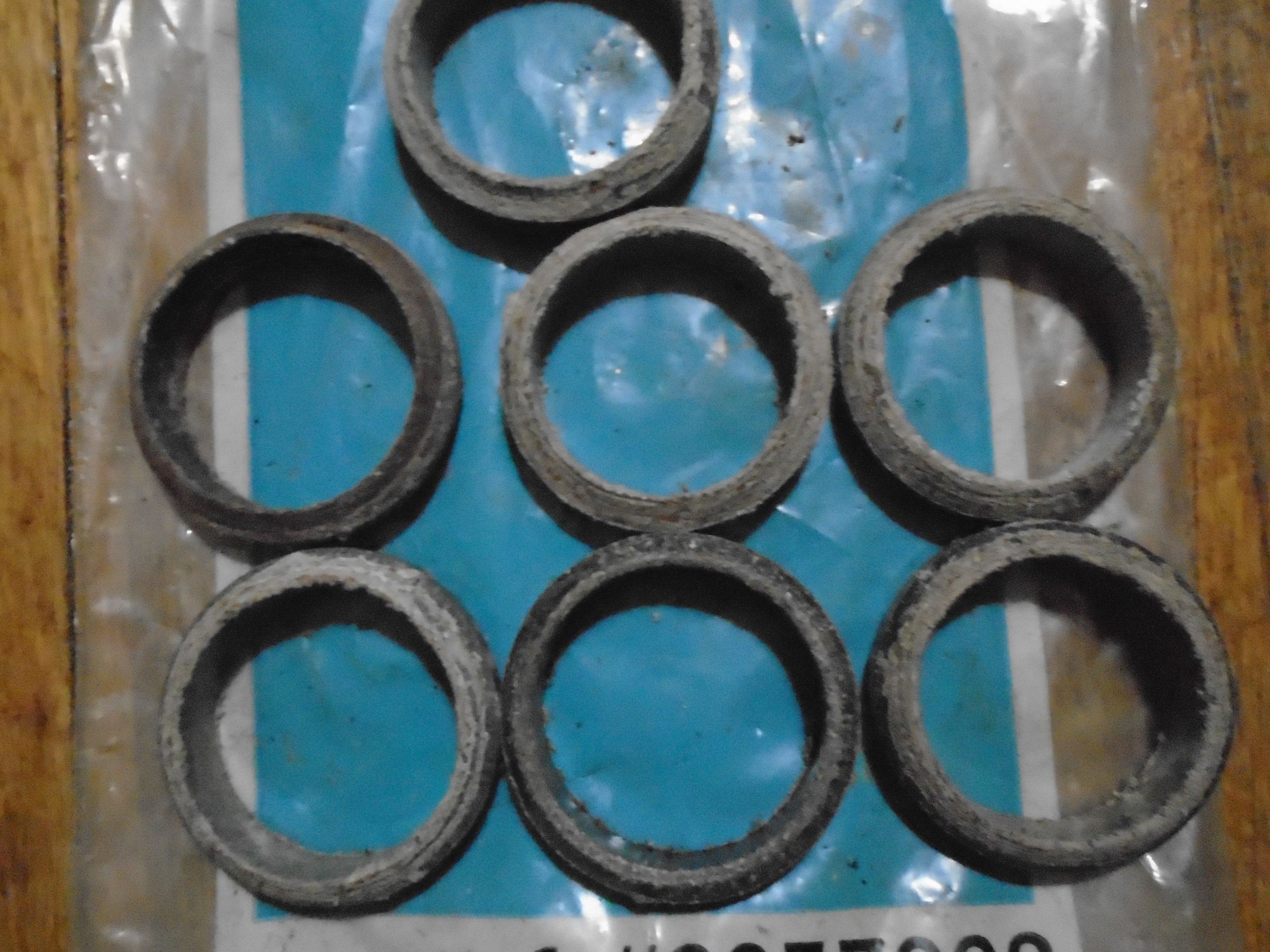

Old Aug 3, 2022 | 06:58 PM
ralphspears's Avatar
ralphspears
Banned Scam/Spammer
Joined: Nov 2011
Posts: 2,966
Likes: 991
From: MA
THESE ARE 50 YEAR OLD GM FOR A SMALL BLOCK THEY APPEAR TO BE ASBESTOS
Old Aug 3, 2022 | 07:22 PM
farmerdick's Avatar
farmerdick
Joined: Apr 2021
Posts: 142
Likes: 10
From: Readfield, Maine
Ralph, that is exactly the material that was used until whatever years after 1971. Of course they stopped using asbestos for health reasons. I guess i will be calling RockAuto and Summit tomorrow and give them some measurements.
