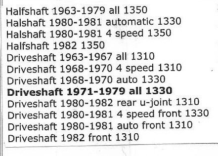

So i bought new U Joints and flanges for my 69 BB car. well, the ujoints don't fit the halff-shaft but they do fit the new flanges. They are 1/8" too long for the stock half-shaft. Any ideas on this?

Posts: 7,427
Likes: 1,560
From: mount holly NC
Default Does this help?

What u-joint did you buy (brand / part number)?
The spicer 5-1350X u-joint is 3.625" across the caps in both directions (1/2 shaft and flange)
Are they all the same?

I just posted this 2 days ago. All 63-79 1/2 shafts are 1350. Spicer 5-1350X will fit them all, unless the flange or yoke is bent.
Solid Spicer Install - CorvetteForum - Chevrolet Corvette Forum Discussion
