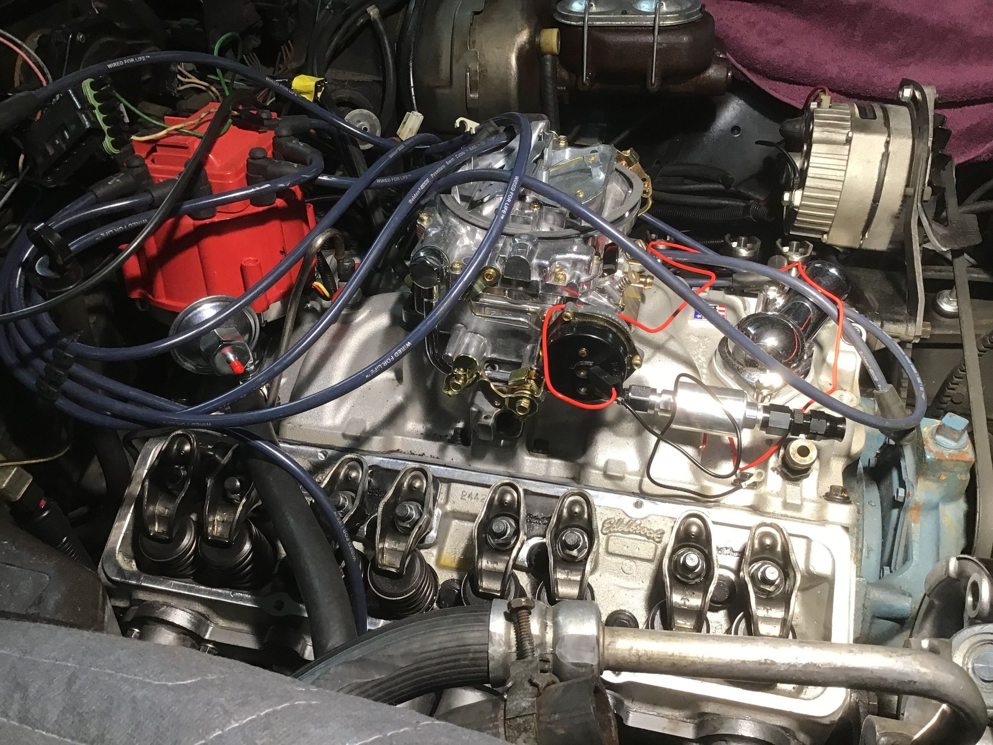

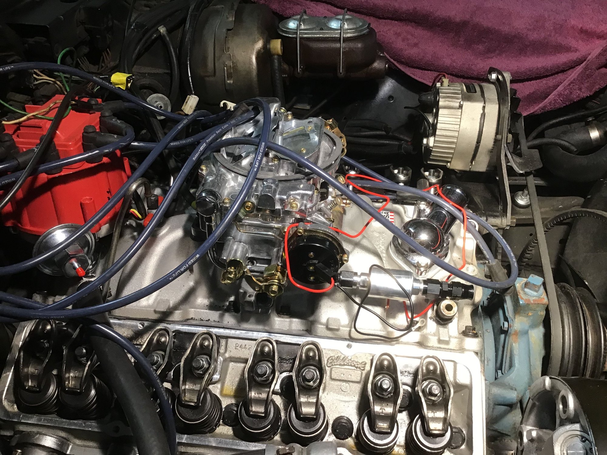

I bought one 1981 5 months ago,and at a 190 hp,stock engine,isn’t suitable for me,so,opened those can of worms,lol....I replaced heads,intake,carburetor and long tube headers,and hei distributor,just fired it up for the first time a few days ago,now just getting all my vacum lines and linkages hooked up.I live 2 hrs from Myrtle and everything on my before I opened them worms ran like a charm,took the computer out behind drivers seat,in battery box,so, have a lot of parts if you’re staying stock.
