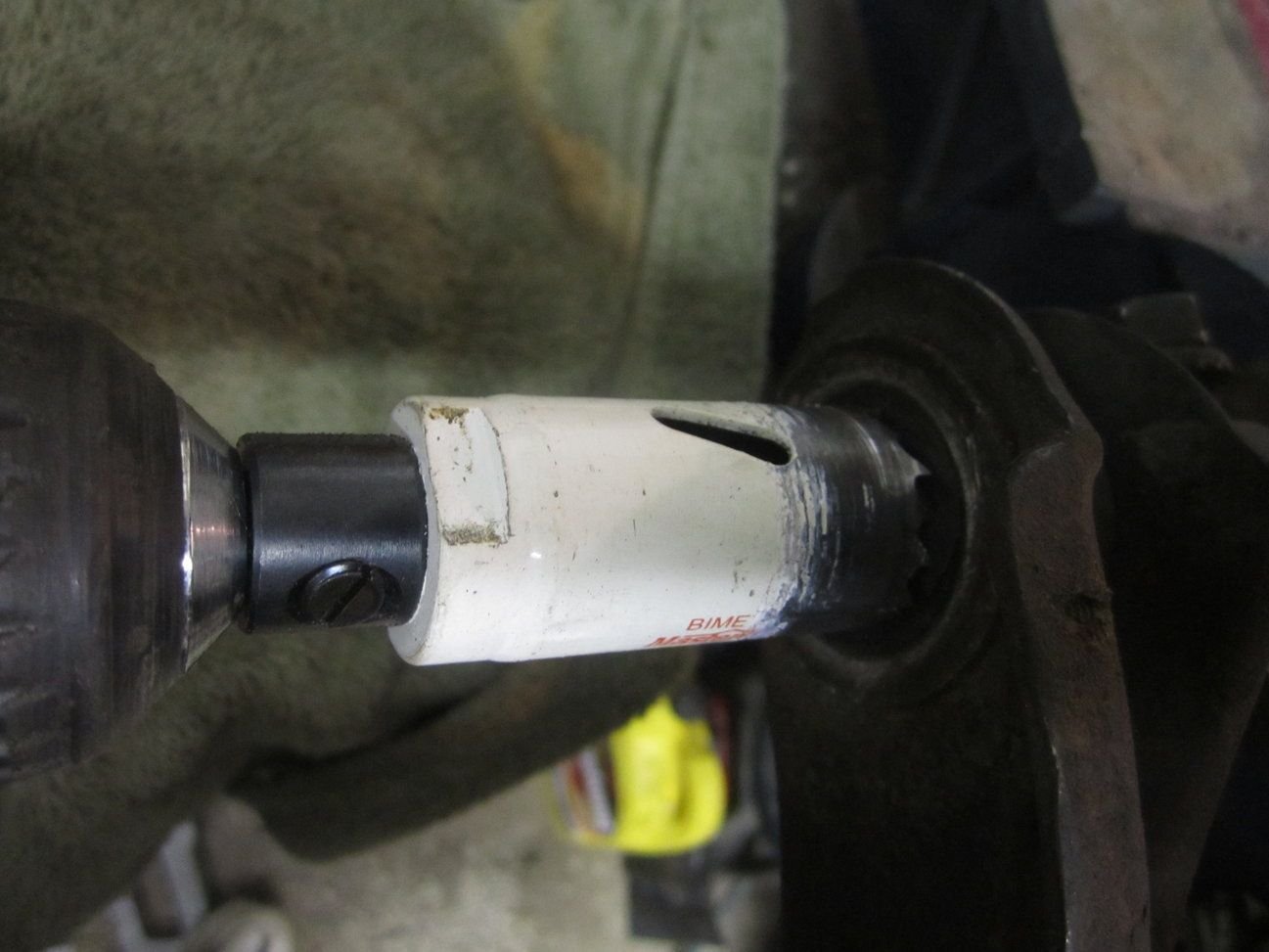

I don't like hammering the crap out of the control arms with air-chisels so when I do them I cut the rubber out with a hole saw without any guide drill bit
When that's gone, I use a hacksaw to cut most of the way through the outer sleeve
A few hits with a hammer and chisel on either side of the cut will collapse the sleeve and it pops right out

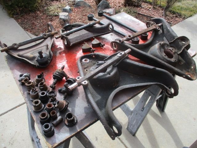

Well,,, I got the lower control arm off. I tried the BAH and punch, that didn't work. I tried drilling the bolt end out, this might have helped but didn't get it to come off. I was able to pull the mounting rod down, on the loose end enough to twist it back and forth and it popped off. I don't want to even think about what I went through to get the first bushing out. Lets just say it came out in about 15 pieces. The second bushing was easier. With the rod removed, I used a sawzall to cut two places on the inside of the bushing and a chisel, and it came right out. Even if you cut a small slot in the control arm bushing hole, it won't hurt anything. I used a round sander to clean up the bushing hole on the control arm. This is a MUST! It didn't seem to make a difference how much I beat the hell out of the arms, after cleaning up the inside edge, the bushings pounded in ok. Bushings in the freezes, propane torch on the control arm. OH,,,, now to try and get the spring into place.
DON"T screw up and install the mounting rod the wrong way!!!!!!! Check 10 times, install once.
