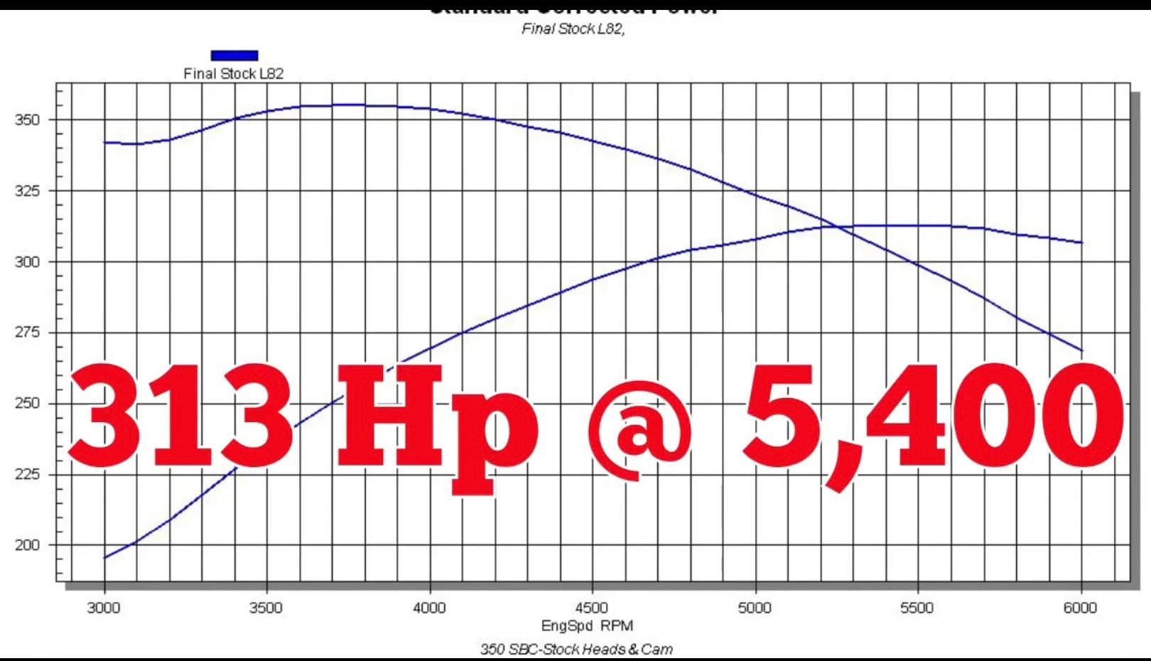

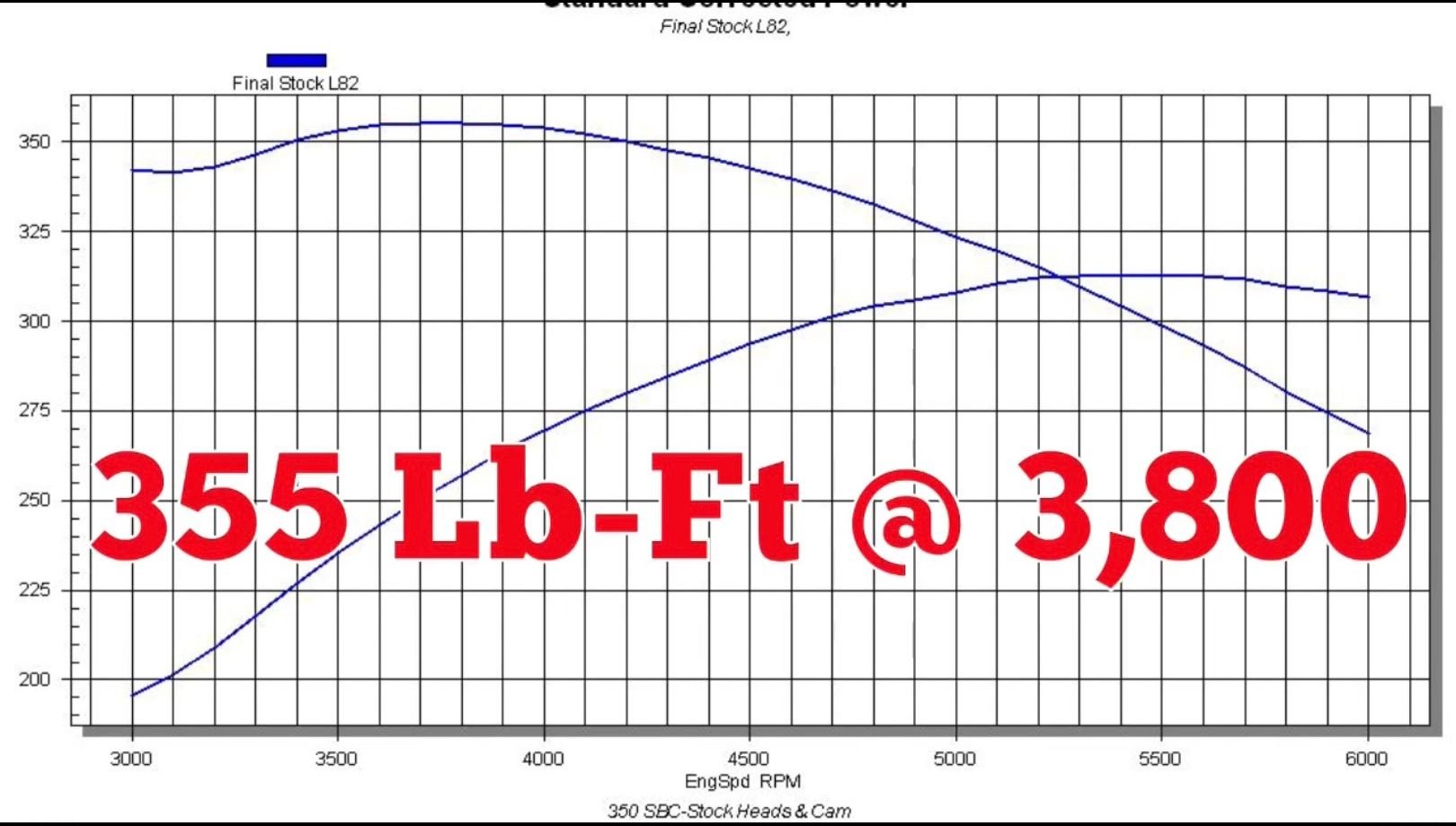

I agree with @wilcar
but i cannot wait to see what heads and roller cam do for you! Following…
fyi l82 stock, tuned..
Gross
