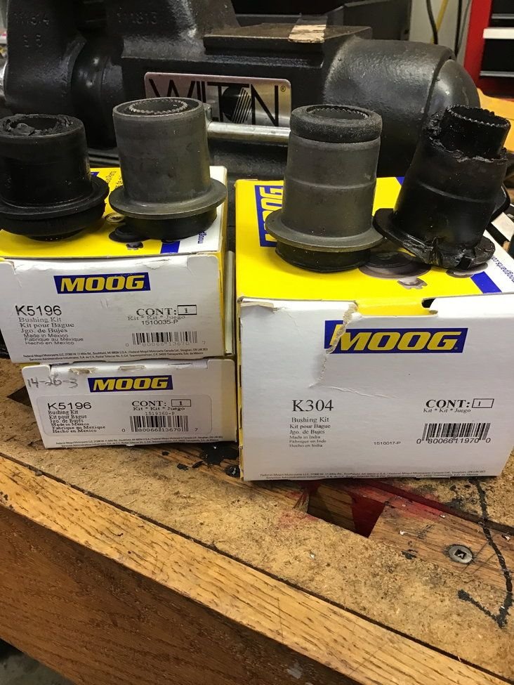

Well a great chance to check out ball joints etc springs?
fyi moog i got no longer 🇺🇸
India and Mexico
here is mine
https://www.corvetteforum.com/forums...-method-2.html
