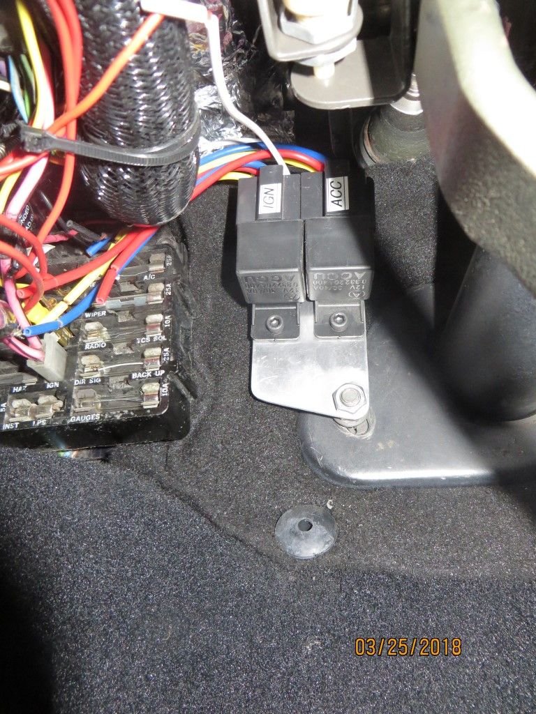

The connection to the fuse panel is a pink with black stripe wire that plus into the ignition terminal in the center of the fuse panel, you can see it here on the left side near the bottom
First thing I'd check would be to make sure that is plugged fully in

I have the console off doing carpet and trying to fix this issue. The breaker on the firewall is fine and has power on both sides. All my other lights and stuff are working fine. It is just that the pink wire from the fuse box does not have power. If I put power to it with my probe the relay clicks and the windows work. I am probably just going to run a wire from the extra switched power from the fuse box to get them working.

Thanks for the fuse box picture. The pink wire was not plugged in for some reason and was tucked up where I could not see it. Problem solved. Thanks everyone.
