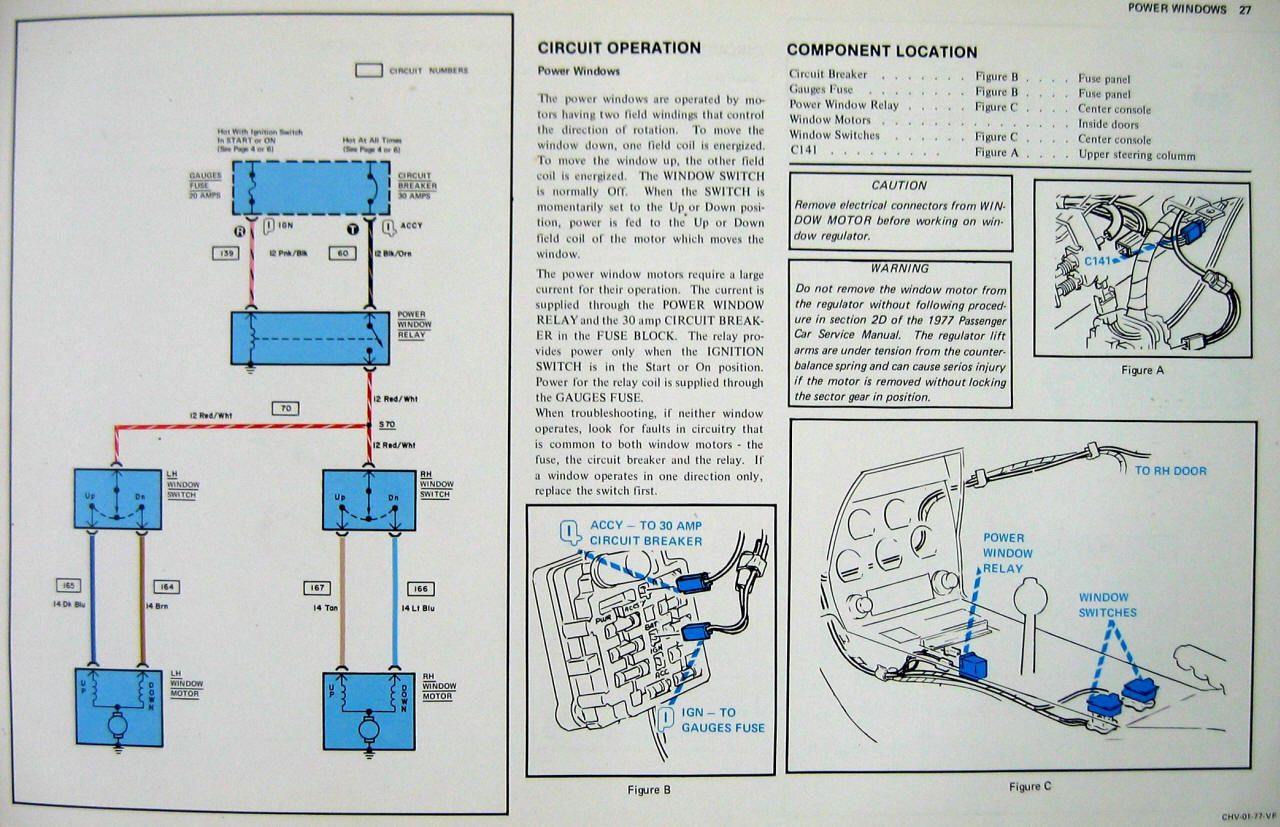

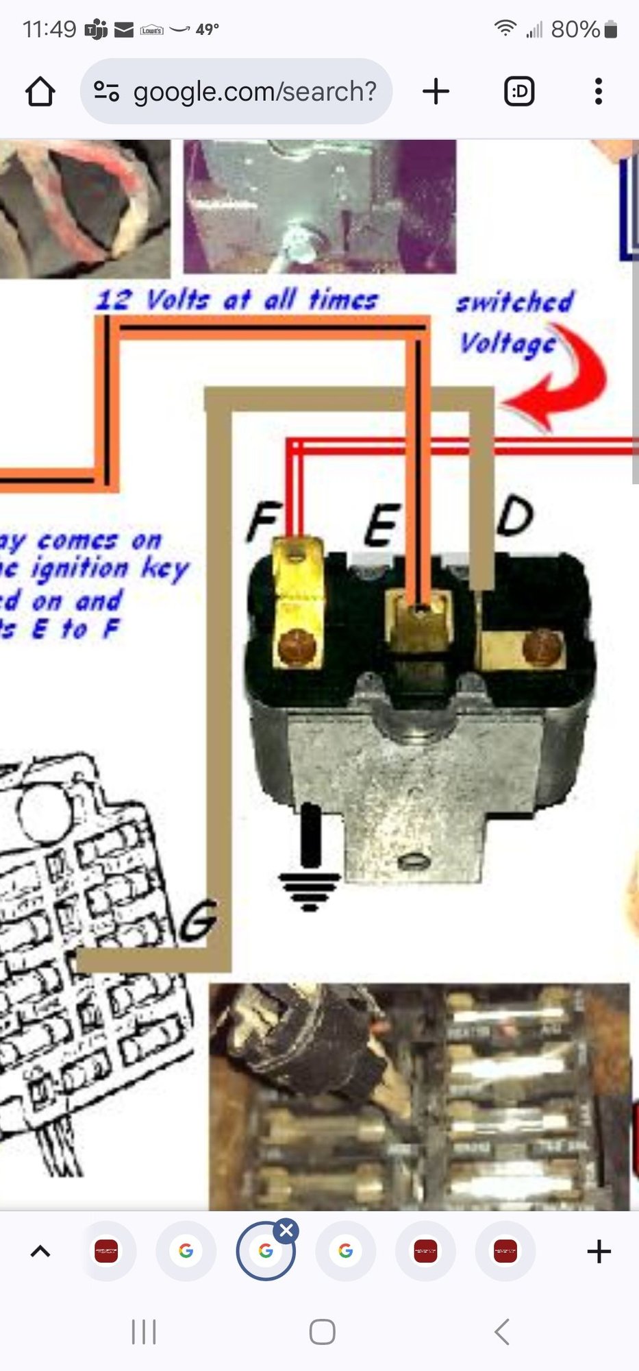

I need help figuring out the electric windows on my Corvette. I have traced the issue to the window relay terminal D not getting power from the fuse box. When I look at the fuse box I don't see a fuse for power windows. Kind of stumped at this point.

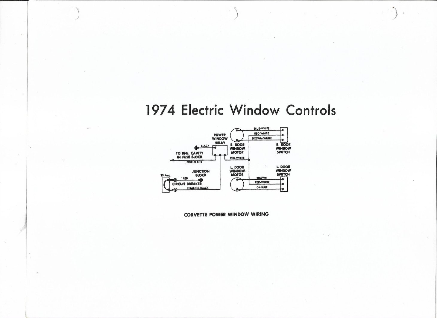

Is the PINK/BLACK in the IGN terminal?

In your diagram and my vehicle the pink wire should have switched power and It does not.

That wire should get power from the gauges fuse
