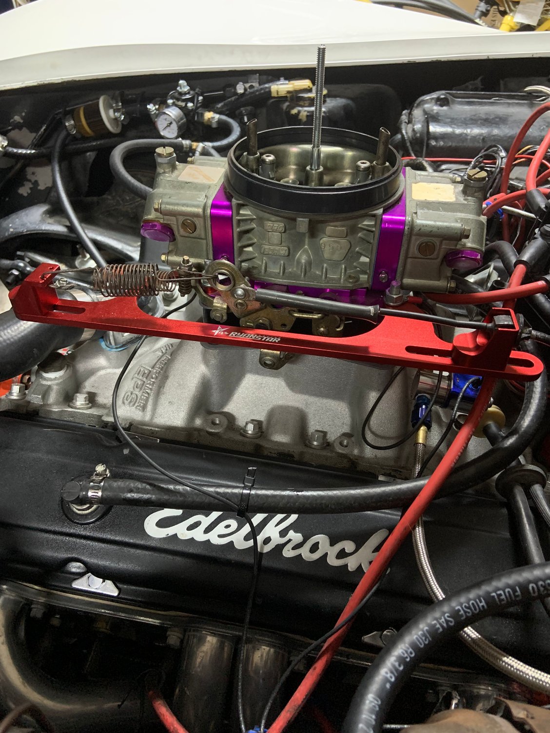

Good Mourning, I will try and get some pictures and maybe a quick video,but bought a 1981 in February,drove it twice once when I purchased it,and that was about 60 miles to get her home,realized real quick that this stock motor was not enough,so,replaced with Edelbrock E street heads,and intake,carburetor AVS carburetor,headers and HEI distributor,and new lifters and pushrods and flat rocker arms,I know should of bought roller rockers,fired it up,set timing and and she’s running very smooth,although did adjust carburetor as it said in institutions.still have a few vacum hookups,but still have not found a bracket to hook up my throttle cable or tv cable,I know Edelbrock 8041 is the bracket,but every where I look,out of stock,I think I ordered one a few weeks ago,for $70.00,but,can’t remember where I ordered it,Summit or JEGS, or speedway,but they have never taken the money out of PayPal,so not sure if I should keep waiting,although it did say would be here on the 23 of this month,but getting inpatient now.but other than that,the engine is good,and next will be doing interior,new carpet,and cover seats,everything else is good.carpet is old and faded.

Unless you have a stout valve spring or lots of lift stock rocker arms are fine.

Amazon(2 day delivery!) has some universal setups that work just fine. I can’t speak to the trans hook up, but the square gm throttle cable works great with it.
When I ran an edelbrock carb I personally used the stock set up and made some bolt on extensions using metal from ace hardware.
when I switched to a proform I used the above mentioned universal setup.

Thanks,the one I was wanting was had two slots,one for cable throttle,and tv cable.but might have to get that one and go from there.

according to what ive found these wont work well with a tv cable or at least I havent found any advertised to or pics of anyone using one with it. ebay is loaded with different brackets as well. https://www.ebay.com/sch/i.html?_fro...acket&_sacat=0
