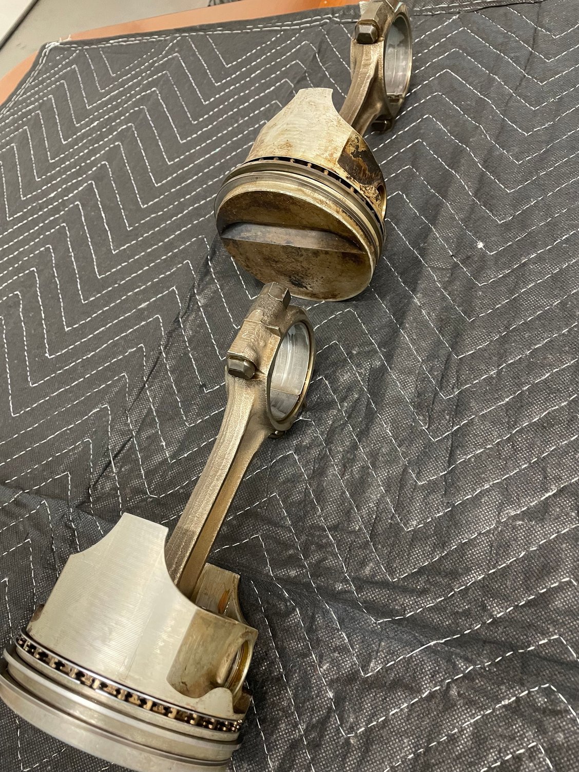

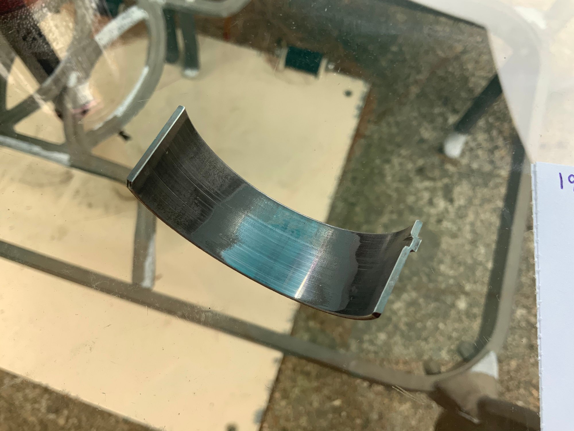

Just started taking mine apart the other day. 68000 miles. Wanted to do a fresh up on the engine while everything else was apart.. It is hard to post sounds even exhaust sounds. You could have some piston slap if it’s like a rattle knock or lift gone if it’s a loud tick tic tick. This is my connecting rod bearing and piston. Good enough wear for the mileage.
