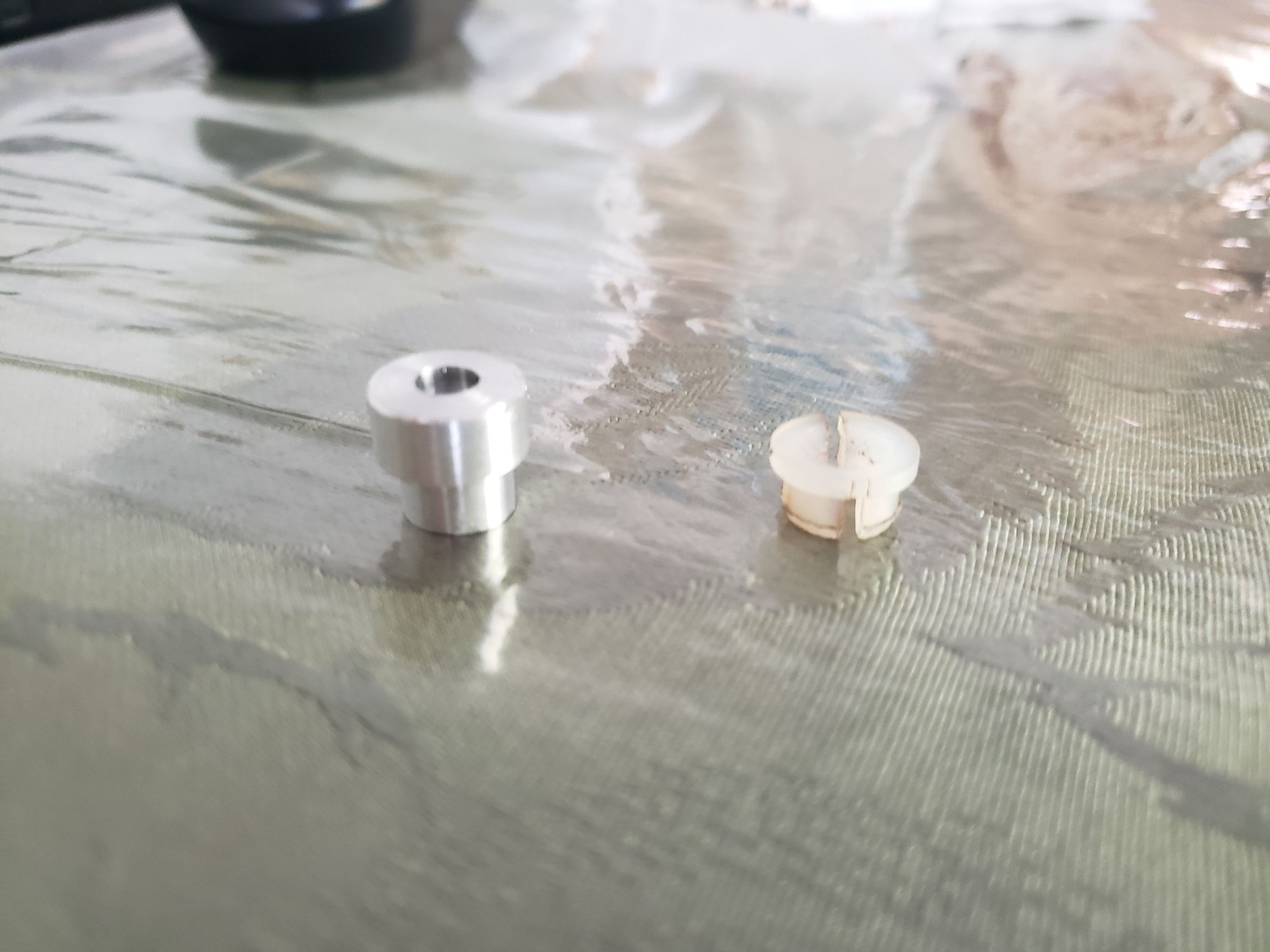

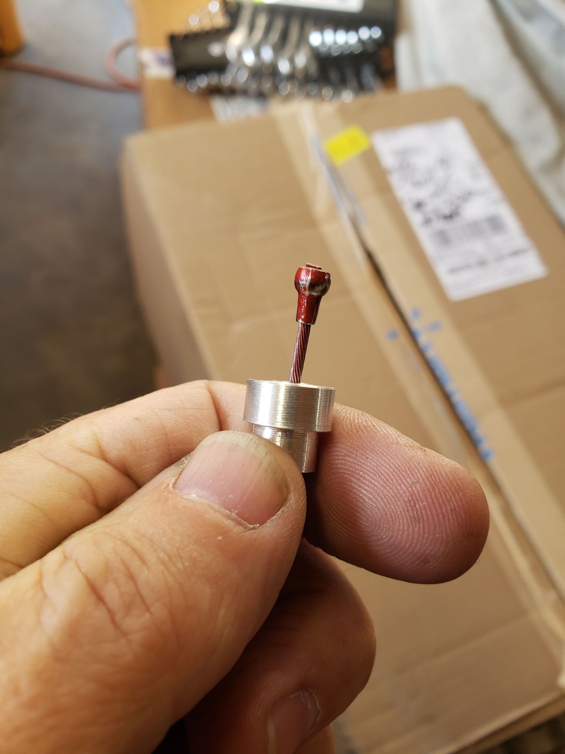

I had a friend machine a replacement piece for the cabin end of the Lokar cable. He machined it out of 1/2" aluminum round stock on his lathe. Works well and won't pull through like it did with the plastic piece. Pics.
Cable set in end of keeper.
Lokar cable in machined piece.
New piece and factory plastic piece.
Side view of new and old pieces.

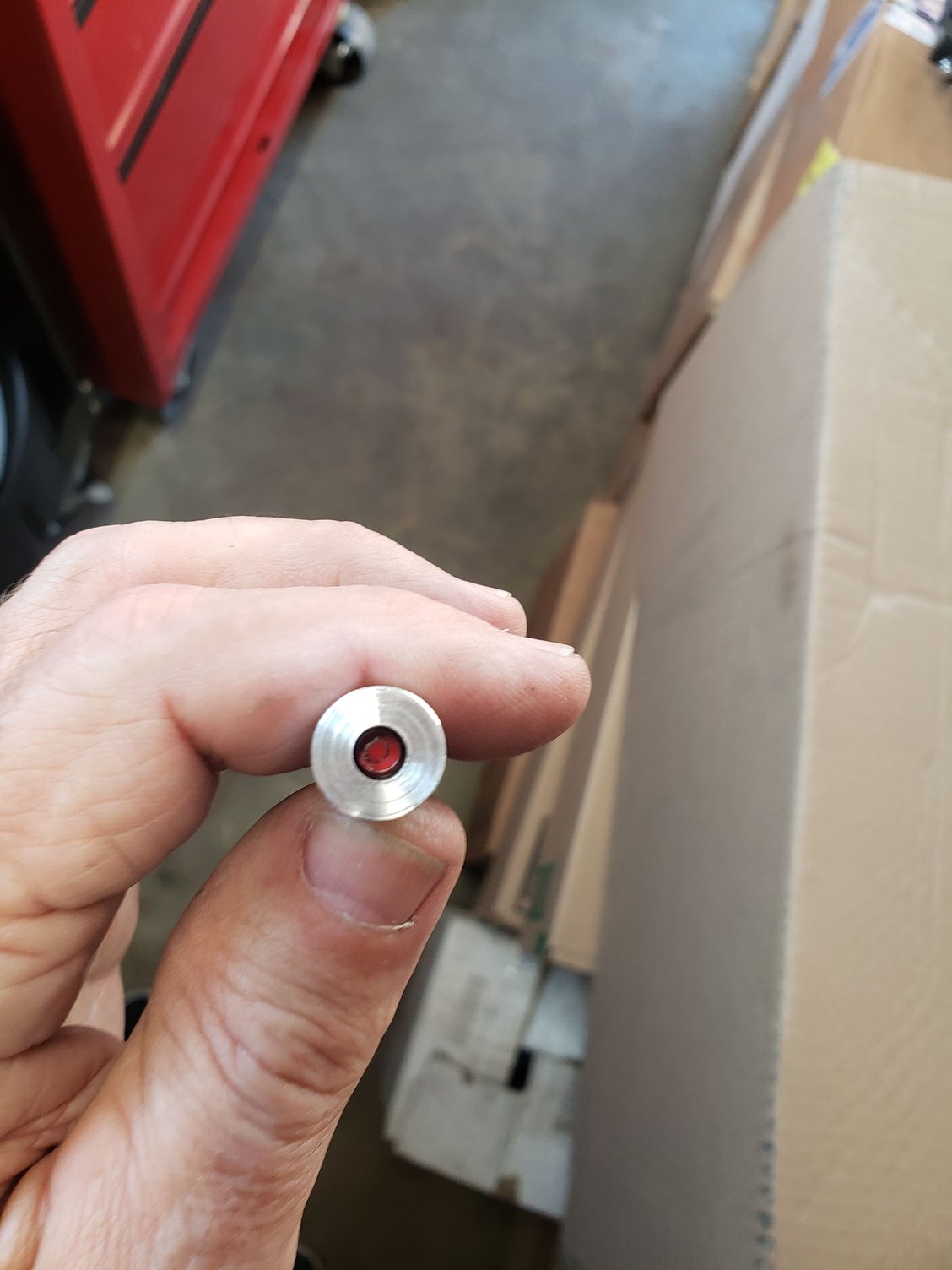

I meant to take pictures of the newly machine accelerator pedal rod to throttle cable end piece in the rod but forgot to do that!?
So today I got my trusty borescope to smart phone app and took some additional pictures (attached).
I also forgot to mention that after I got my accelerator cable fix project done, I found that my interior lights would not go out when the door was closed! So, I'm thinking to myself, dummy, now what wire did you manage to screw up while your arm was flailing around under the dash!? I search the CF archives and most things were about the dimmer switch or gounding issue or maybe the headlight switch was turned to engage the interior lights, etc. Well, what I didn't find in my searches was anything about that the courtesy light needs to be in its retainer bracket for it to work correctly! Pushed the light (driver's side of course) back into its receptacle, problem solved! lol
Machined piece in accelerator rod with cable (partial view, sorry)
View of cable in A-rod going thru Lokar bracket in firewall
Backside of A-rod with machined piece
Another view of cable in A-rod to firewall exit to engine bay

I had a friend machine a replacement piece for the cabin end of the Lokar cable. He machined it out of 1/2" aluminum round stock on his lathe. Works well and won't pull through like it did with the plastic piece.​​
That's a nice solution. Certainly more elegant than my washer. I gotta get me one of those machinist friends. Seems like they would be handy to have around.
DC
