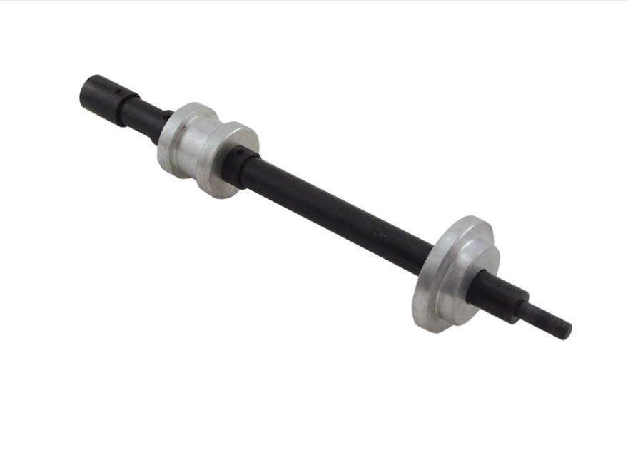

Maybe in your quest to asses the bearings you could remove the distributor and use one of those oil priming tools to see if you get somewhat okay oil pressure.
I think most would say you should be getting at least 20 lbs at idle, so if you get more than 20 lbs while turning the priming tool, you should be okay.
You could/should even make it more precise by only turning the priming tool a similar speed as the engine would be going at idle.
Let's say you run 750 rpm at idle, so you'd want to have around 375 rpm speed on the priming tool since it's being turned by the camshaft (1/2 as many turns as the crank).
I have this old rpm meter at my house for other projects, but they are cheap (like $20), and much cheaper than new bearings and your time.
Amazon Amazon
many auto parts stores will rent you the priming tool.
