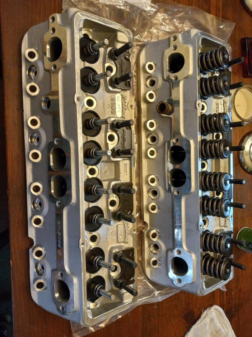

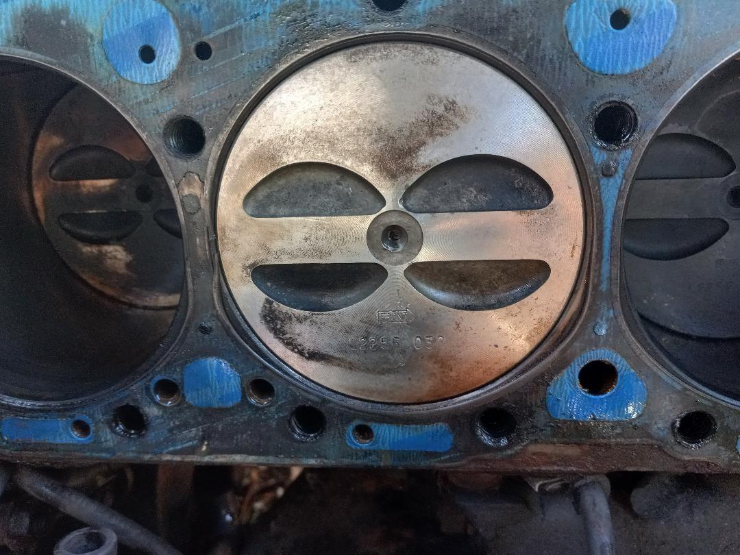

Well I took off the heads. Easy to see where the gasket had failed. Looks like I "'steam cleaned" that piston. Nice and shiny.
I ended up buying a set of Edelbrock E-Street heads. Well to my surprise I discovered this morning one is not complete.
So much for having it finished by today or tomorrow.
