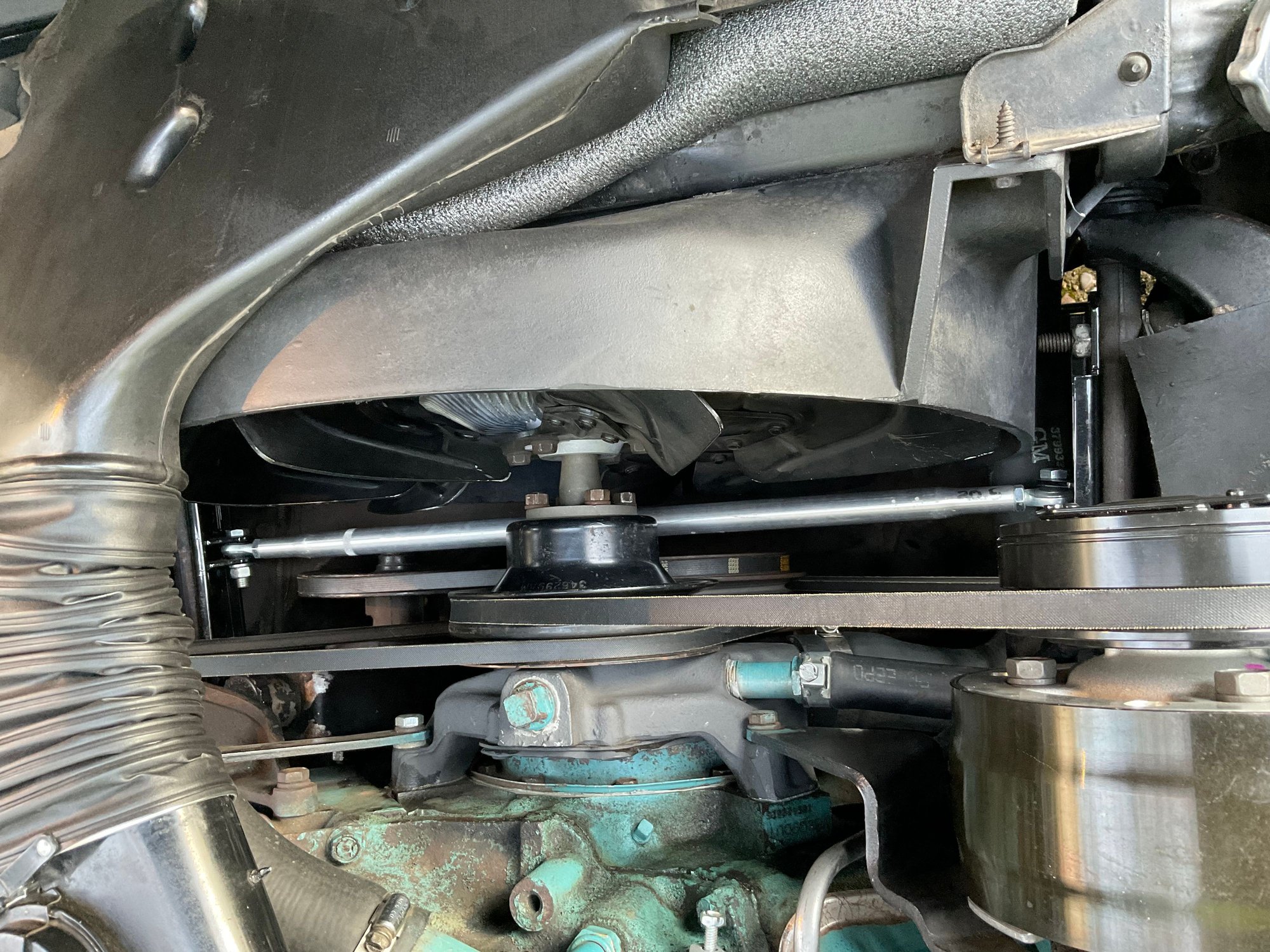

How much clearance do I need between the fan and the spreader bar, right now I have a little less than 1/4th inch on each side. This is with the front end lifted in the air. Seems pretty tight to me compared to other threads.

In theory the fan should pull away from the bar if anything, that said it looks like you've got some thread left and could add a shim (1/8?) to the fan to help the clearance

I couldn’t do it..in theory it fits but most have electric fans. And with ac and belt guards..my hats off as it is tight.

I think you’re good. My PS pump has two belt groves, which limited how far back I could mount the spreader bar. The fan would occasionally kiss the spreader bar with a little “ting”. I put a 1/8” spacer behind the fan clutch. Problem solved.

You should be. Fine check it with the car on the ground

That would a be a little tight for my liking. As mentioned above; check it on the ground, and if then, if still that tight, then space the fan forward a skosh. How close is it to the underside of that pulley?

Are you sure the bracket isn't backwards?

I’m pretty sure they are on correctly. If you scroll down in the link I provided, you’ll see the brackets are symmetrical. There is no long or short side.

There is a lot of flex in the c3 frame and this bar makes a noticeable improvement even with street driving.
Mine fits fine but I upgraded to electric fans last year.

mine is so close, I can't change a fan belt.

I added a thin spacer because I had contact.

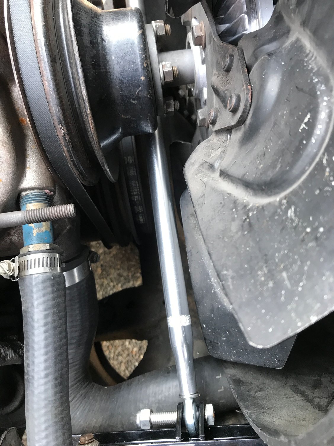

Here's an old photo of mine. I have maybe 1/8" - 3/16" between the fan and bar. No problems at all and I've had mine on since 2016. No modifications at all.

If your spreader bar doesn’t already have slotted mounting holes, you could enlong them a bit to allow for front to back adjustment. Spacers on the fan mount as mentioned above sounds good too. Couldn’t find a picture of the actual mounting holes on mine.

When accelerating, the engine lifts up and to the right. Forward/aft motion is near nothing. 1/4 inch clearance should be fine.

My spreader bar is just like that and never touches
