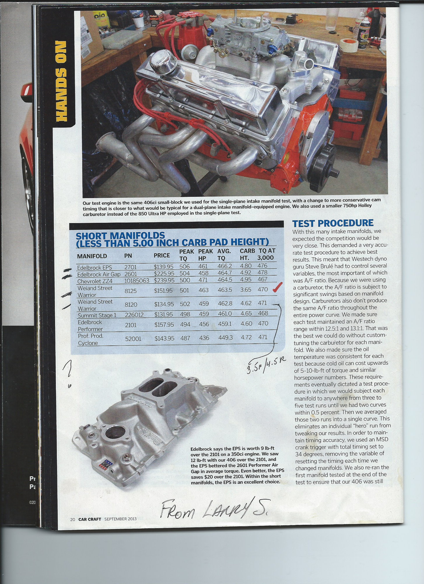

Back when I ran a small block, I used the Performer RPM Q-Jet manifold (same height as most of the RPMs). Stock hood with Moroso drop base air cleaner. Air cleaner has a 1” drop, 3” filter and a dome so was probably getting 2.25” to 2.5” above the carb. Worked well enough for my 350 and fit under stock hood. Just had to dimple the base for the Q-Jet pump arm.
Old post: https://www.corvetteforum.com/forums...post1601757056

I have a 78 with an Performer RPM Air Gap and Fitech EFI on a 383. Air cleaner is a 3” X 14” K&N X-Stream Air Flow filter assembly (filter element in the lid) with a 1” drop base mount. No clearance issues and no noticeable power restriction. I agree that if power restriction is at 5000 rpm or above it is a non-issue for a street car.

The 73 and up C3 hoods are 3/4" taller then the 68-72. Is the fitech the same height as a q-jet? I disagree that over 5000 for a street car is a non-issue
