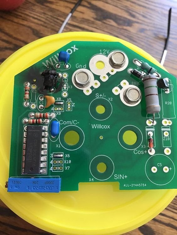

i had a nasty voltage spike on one of my replacement boards..and i had a filter on! Fried board , bright flash, and smelled bad,I thought i was on fire
