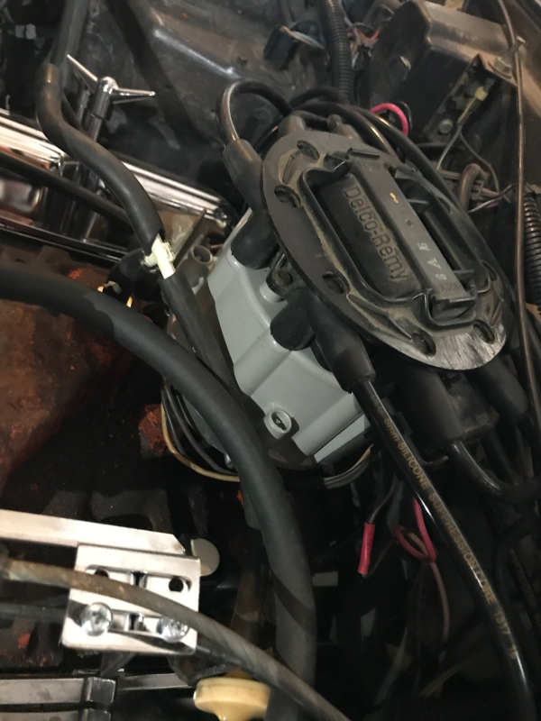

I bought a 77 today. It needs some things fixed before its ready to drive. One issue is a PO replaced the carb, air cleaner, and distributor. The air cleaner he bought is 14" across and it just bumps the distributor causing a spark. So the air cleaner is not installed on the car. I was going to purchase a smaller air cleaner thinking quick fix but a search of the forums shows some saying air cleaner needs to be 3" tall. And it looks like to purchase one 3" tall it will be 14" across. So is this distributor just too big and I should replace it, or can I just use a 10" x 2" or 12" x 2" air cleaner?

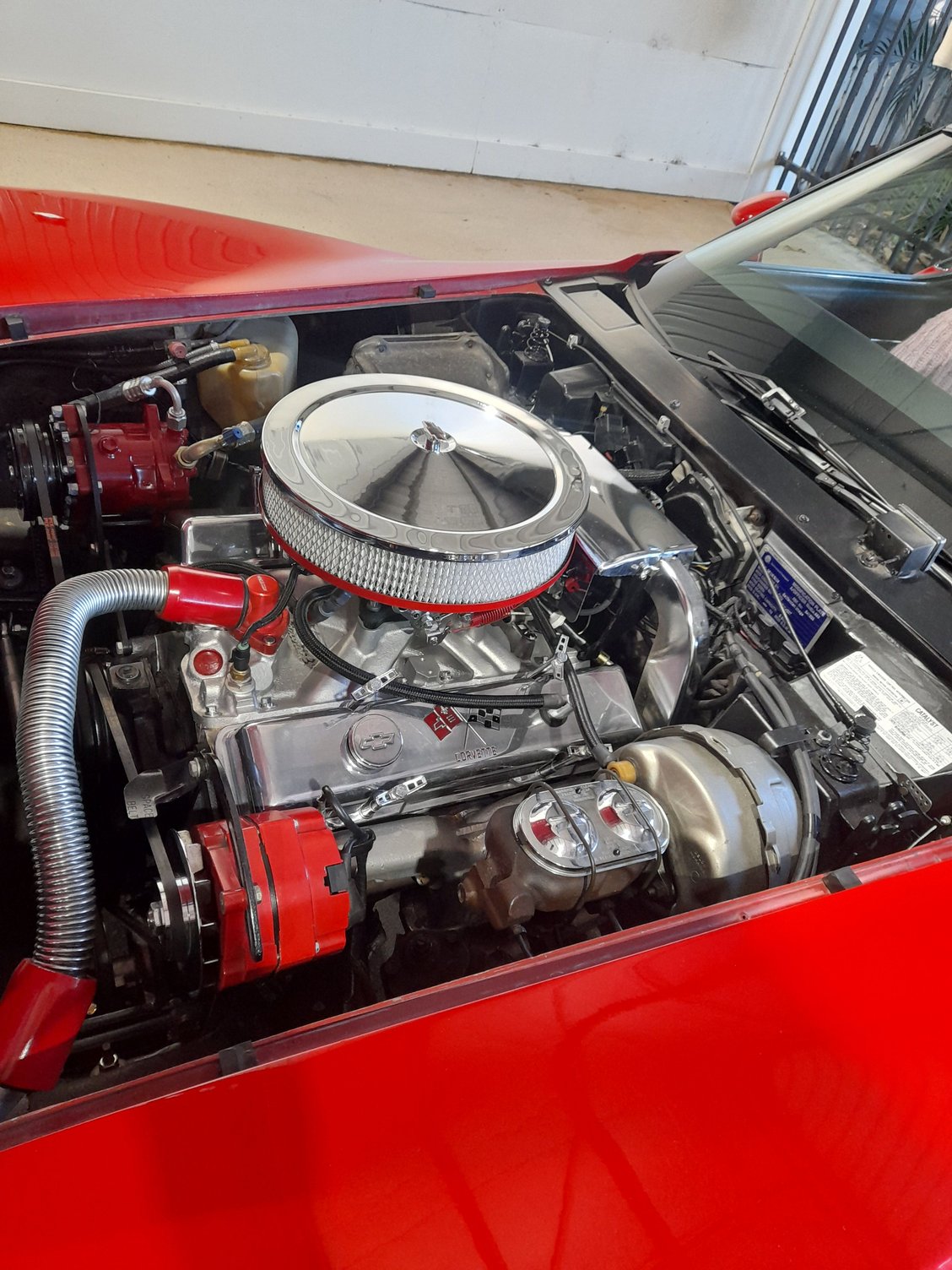

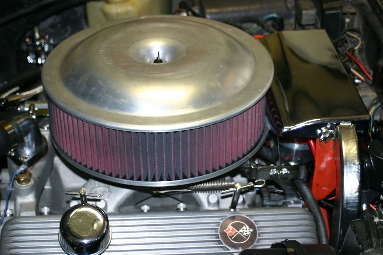

Here's my 77 with 14inch airfilter, HEI Distributor and all the factory distributor covers.
I went up. many simply notch the airfilter base a bit.
At anyrate. Shouldn't cause a spark. unless your cap or wires are leaking. Any replacement HEI will be the same size.
There are aftermarket small cap HEI Distributors available however. But repairing the electrical leak and notching the base of your airfilter would cost far less.
And where are all your covers?

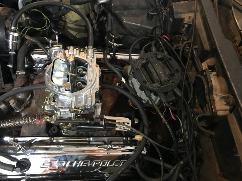

Oh, And that rubber fuel line to that aftermarket carburetor looks like a fire waiting to happen. I would be very concerned about that.

I see that after market carb is bolted to the original intake manifold. So I have to ask, is that even a spread bore carb? or is it a square bore bolted onto an adapter plate?
Do yourself a HUGE favor and get rid of that carb and all that idiotic after market adjustable linkage, springs and rubber hoses. They will never work properly.
Then buy yourself a period correct Rochester like this:
https://www.ebay.com/itm/30462431851...Bk9SR9T10cbtYA
and have it rebuilt my a reputable mechanic. You can even try contacting CF member Lars here for this service. Or contact the P.O. and see if he still has the original Rochester and have that rebuilt. This is a direct bolt on, easy replacement that will solve ALL of your problems with fit and function.

One thing I noticed from your picture is that maybe if you pulled the distributor and dropped in back in straight it may give you a little extra clearance for your air cleaner.

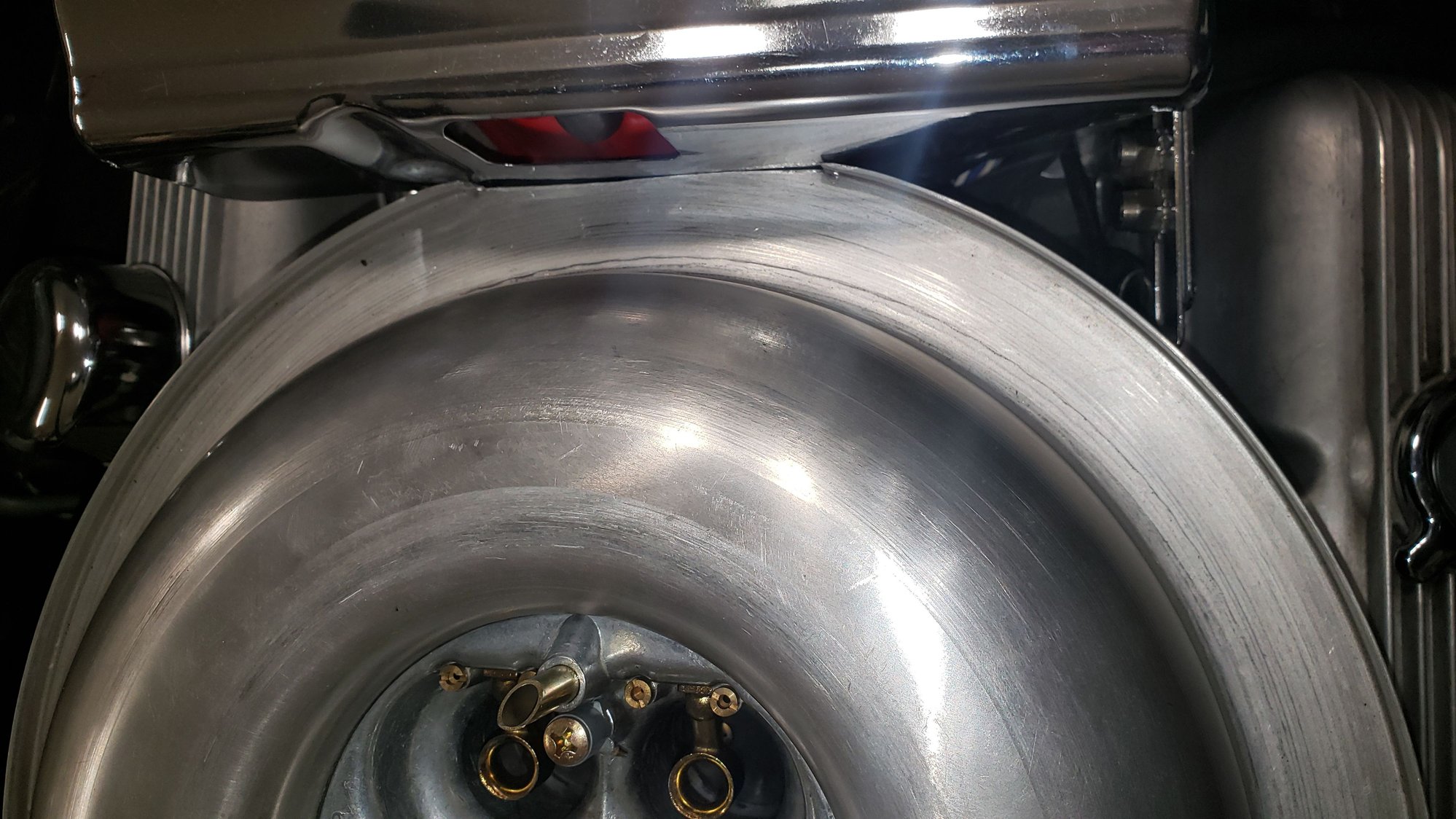

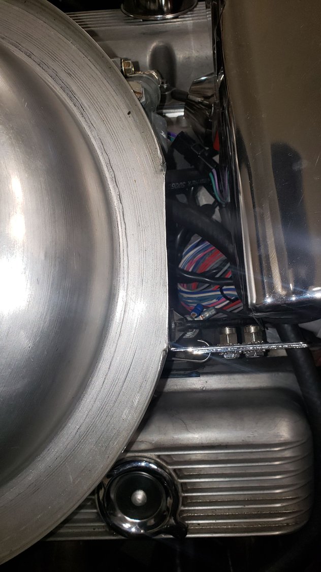

I also notched my drop base air cleaner. No need to replace your HEI.

Looking at your 1st engine photo to me it looks like the car was originally equipped with A/T A/C and also cruise control.
I'm guessing your 1977 is a standard federal emission L48.
If so the correct carburetor number is 17057204.
There are several on e-bay now but I would take a look at this one 7 days left in auction LINK: https://www.ebay.com/itm/27547456494...Bk9SR7ay4uvvYA
Also, if you are missing the correct accelerator cable support bracket same part was used from 1975-1980 cable support bracket part number is GM #352279.
With Cruise the additional cable support bracket is part number GM #342407.

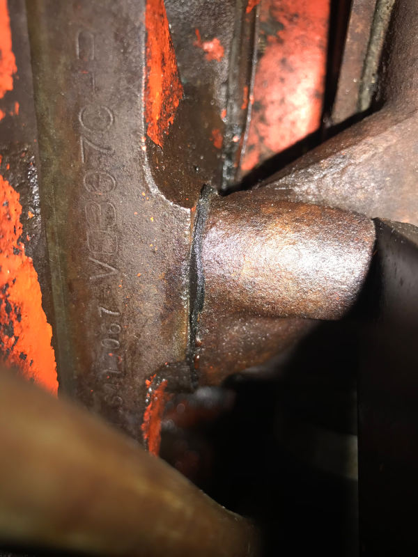

Latest bummer. Located the engine stamp. Hard to make out the whole thing but it looks like it is not correct. So hunting down a 1977 correct quadrajet is probably not my next step. My vin is 1Z37L7S434280, stamped vin derivative ends with 067.

Try to make out the 3 letters of the suffix code, to me they could be CHP or CHR?
In General:
V = Flint engine plant
03 = Month, March
07 = Date, March 7
Year(s):
CHP = 1988 305ci 190HP TPI
CHP = 1997 350ci 285HP TPI
CHR = 1975 350ci 205HP 4bbl
CHR = 1978 350ci 170HP 4bbl
If it is a CHR it's possible it came out of a 1975 Corvette, AT transmission, California emissions...
205HP vs. the 165HP standard equipped 1975.
4 bolt main in the CHR?
The 17057204 is still a really good carburetor, just something to keep in mind...
Last edited by bmotojoe; Sep 27, 2022 at 04:19 PM. Reason: Added CHR Possible Corvette Engine AT Trans & Calif. Emissions

Did some more digging on my car. Looks like my 77 is a thrown together setup:
Block is V0307CHB: 1975, L48, AT
Intake manifold is 6263751, 1972, Iron, Qjet
Carb Qjet is 7044213: 1974, Quad, Chevy, MT
Im looking for a rebuildable qjet carb now and will get an Edelbrock 2101 intake manifold. I’m exchanging emails with Lars about it.
