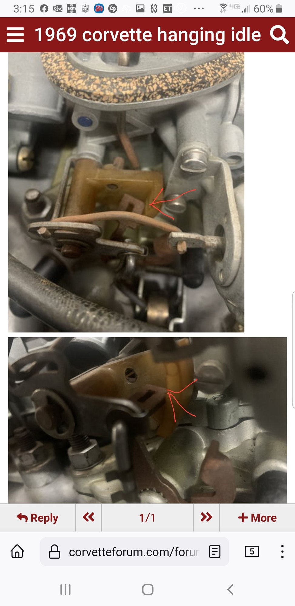

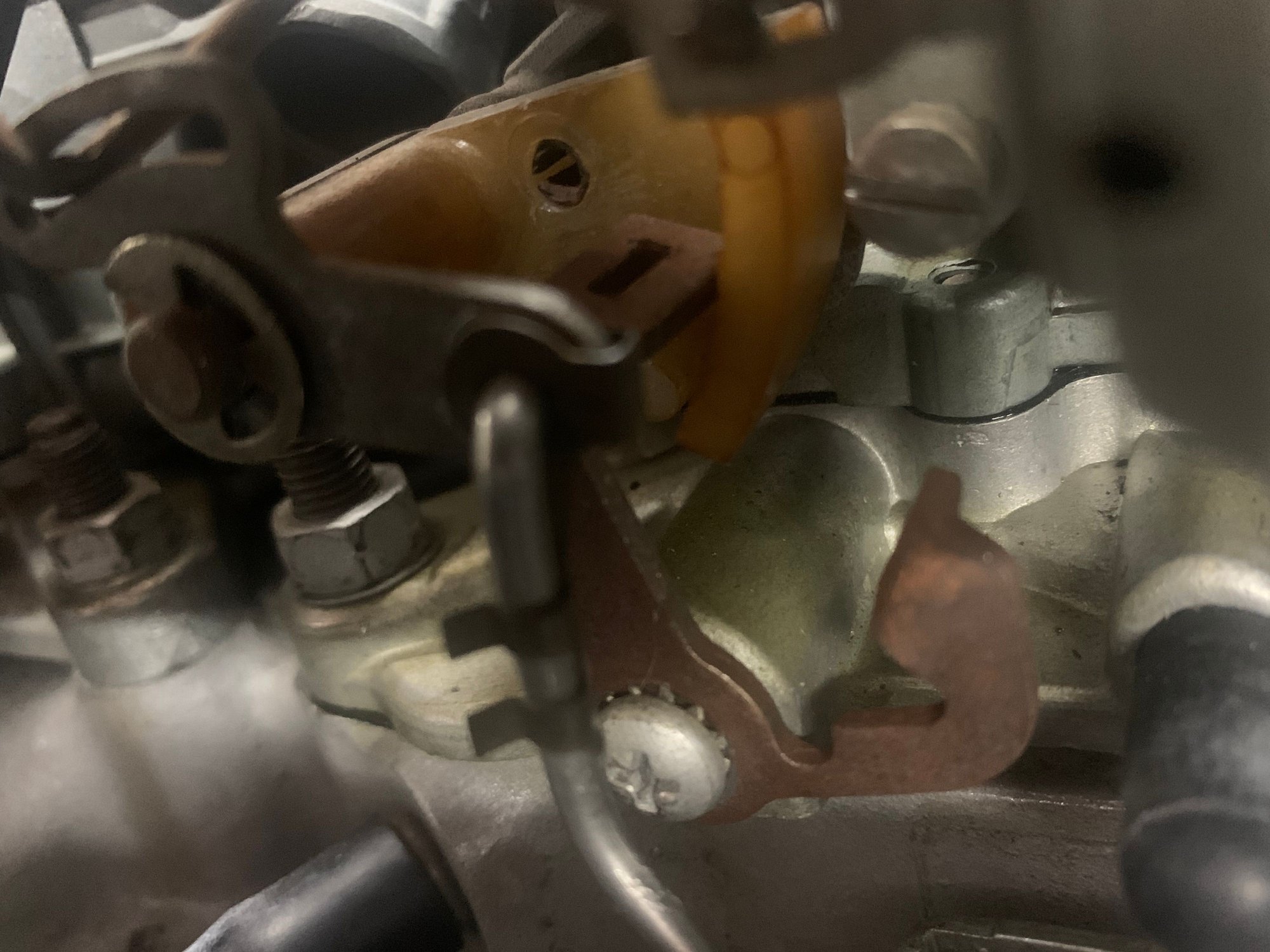

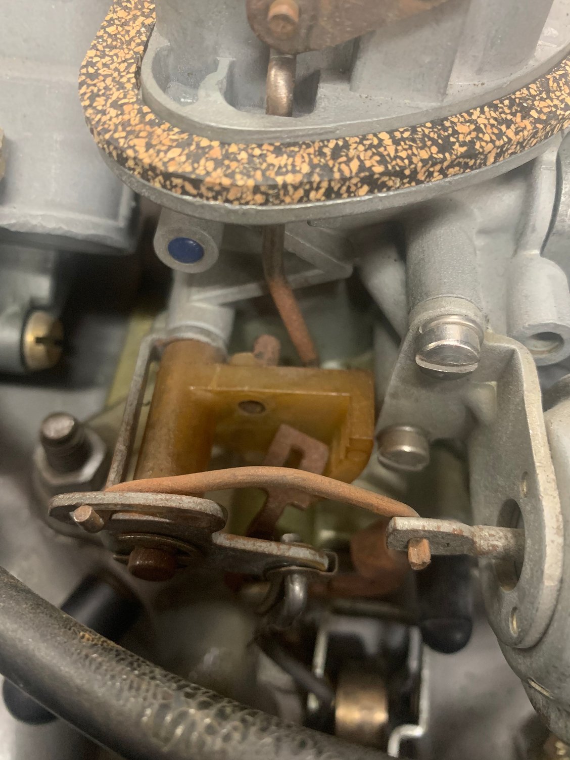

Here I’m going to attach a few photos of my car’s choke linkage. Let me know if you guys think anything looks out of the ordinary. The pictures are also taken with the choke fully open
I also would be tempted to fully disconnect that fast idle cam because I have no use for it as I live in San Diego and the coldest it ever gets is high 40s or low 50s
You can see where the square is touching withe red arrows. Just use a screw driver in the slot and twist it so it doesnt touch when its warmed up

Just twisted that linkage and it doesn't rub it now when warmed up. It made the issue better from reducing it from getting stuck at 2000 rpms to now around 1500ish. The weird thing is that when It would hang around 1500 I would turn down my curb idle speed to where it would be at a good idle. Then when I would rev it up the rpms would fall without hanging. So my main question is do you think that I just had my idle speed screw to far high so when it was colder it would idle but when up to temperature it would stay in too high of rpms?
