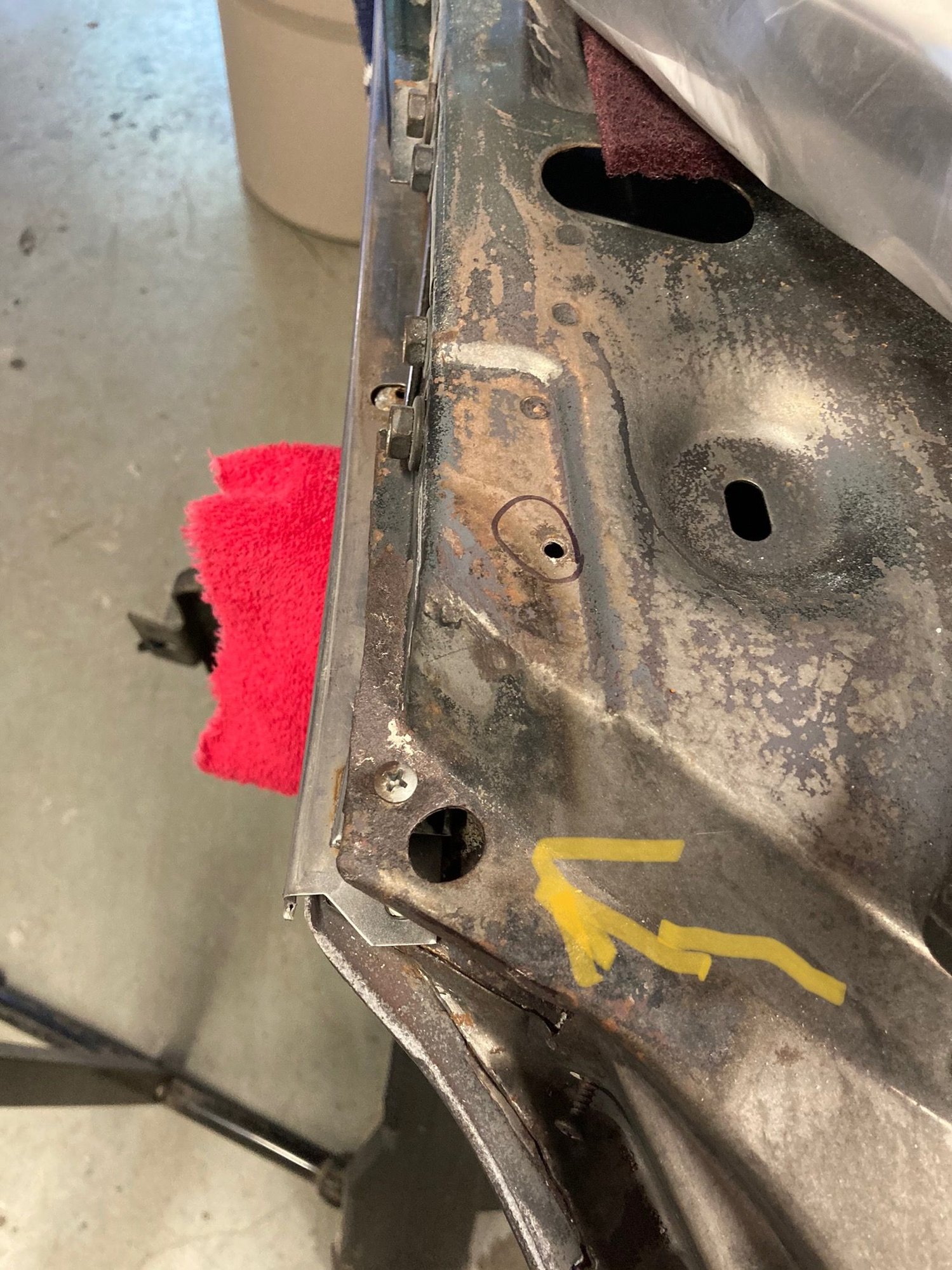

What is this hole for? It’s covered by weatherstripping. There is no screw or bolt that attaches to weatherstripping at this location. Hole is Top front edge of door.

I believe that hole is used to access the 7/16" nut that secures the glass channel to the regulator.
