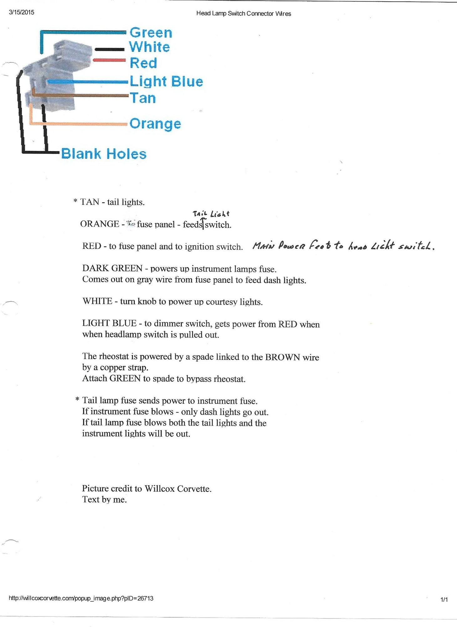

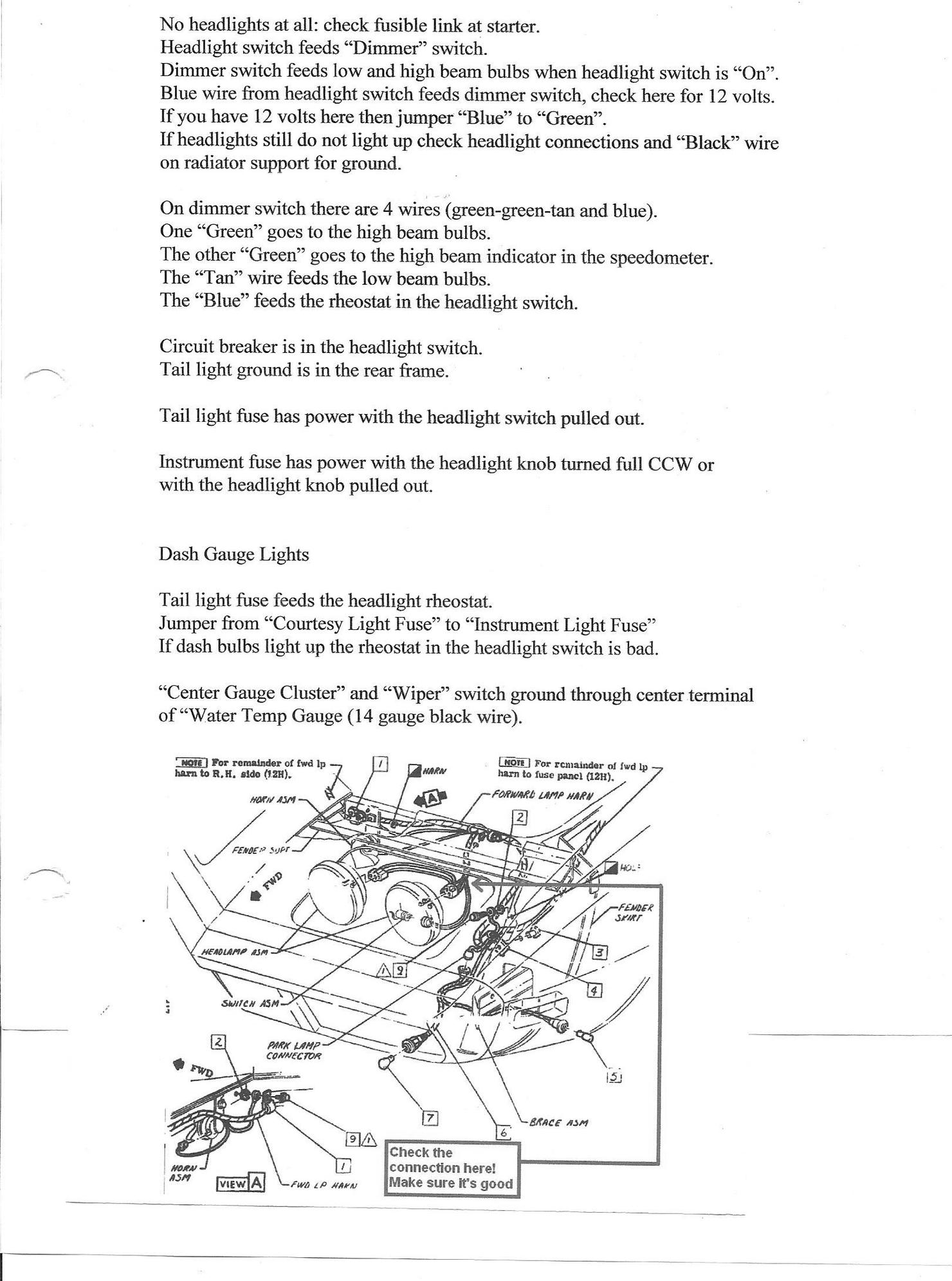

Hi guys, I have a problem with the front lights that I can't seem to solve.When I turn on the headlight switcher to pull out the lights and turn them on, my lights are pulled out, turn on all the lights that are supposed to turn on, even the front main lights, they stay off.Does anyone know why? Fuses are ok. Vacuum work too.
