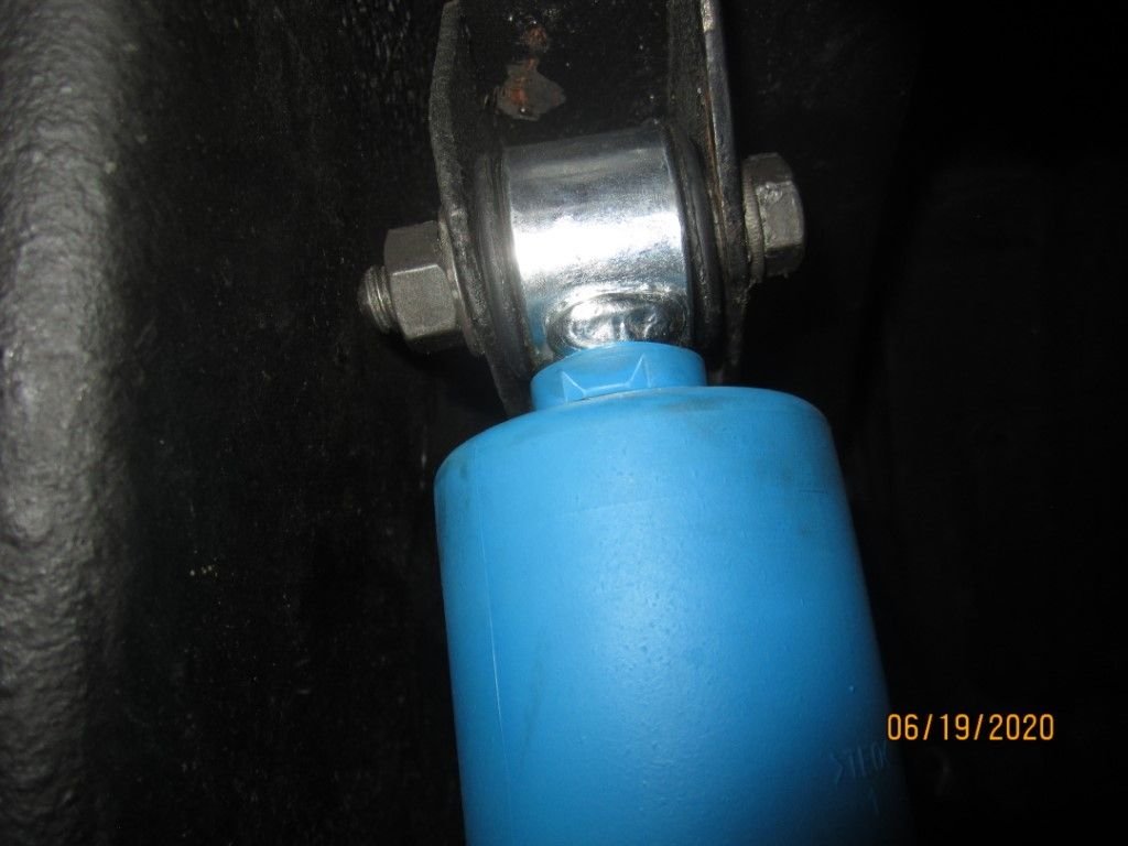

What way does the retainer face? It is a cupped washer of sorts.

cup faces out, a long nut is used with it

And be careful with the top bolt, it's got a washer under the head as well as the nut, I understand it was a left over from the C2 where it was really really close and on ours it's just really close to touching the battery/jack box. But I had to shorten a longer bolt to get a plain shank long enough to go through the bracket and thread short enough to fit between the bracket and the box.

Install as shown
Rookie question: Was there ever a time on GM cars when the cup faced the rubber (to keep it from splitting later on)?

No the curved radius was used to protect the rubber. Having it reversed would have caused the washer to cut/dig into the rubber bushing.
