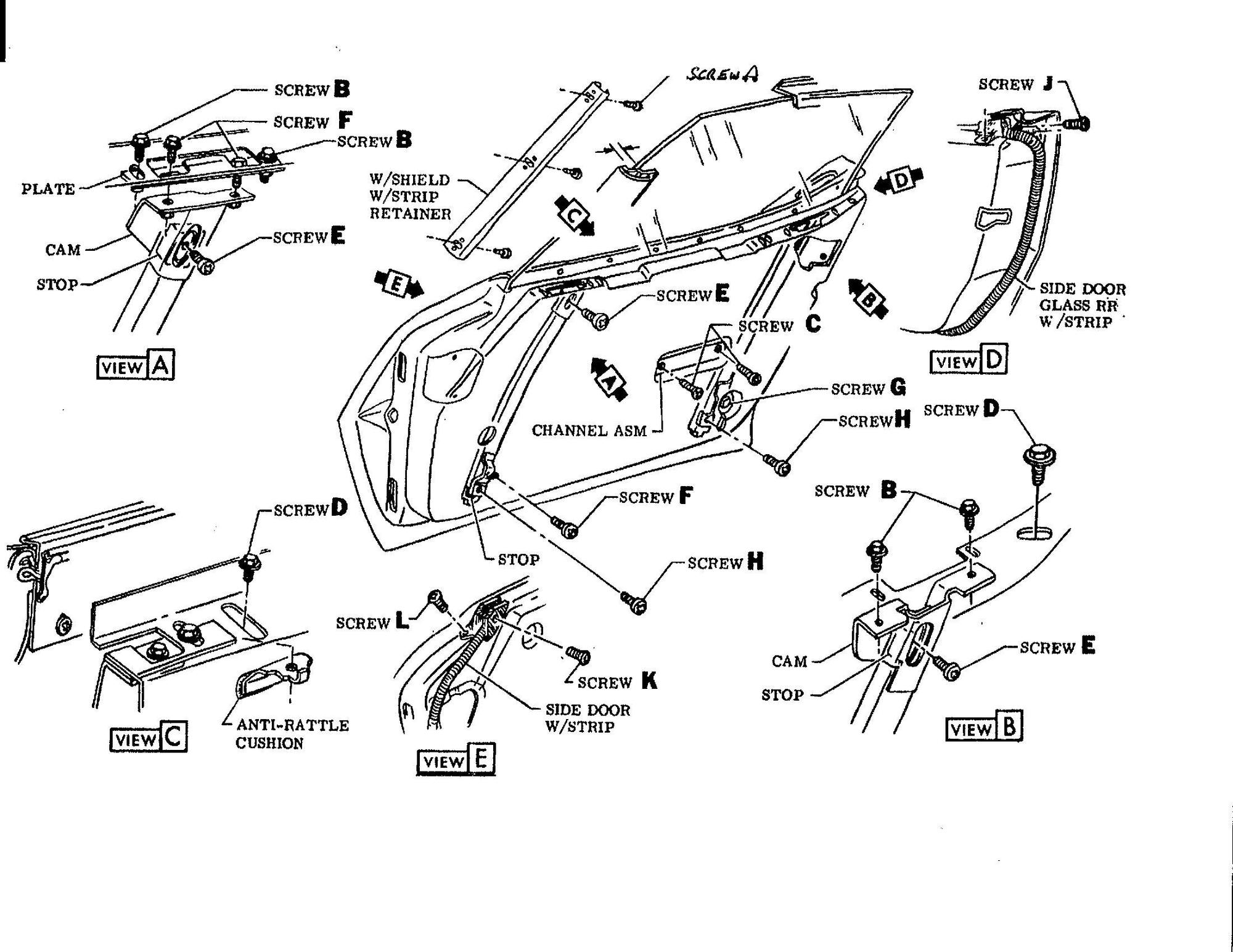

Default Does this help?
Old Oct 5, 2022 | 08:15 PM
Lt.Mike's Avatar
Lt.Mike
Joined: Mar 2022
Posts: 564
Likes: 185
Originally Posted by Peterbuilt
Yes that gives me something to print out and plan ahead with. Thanks !

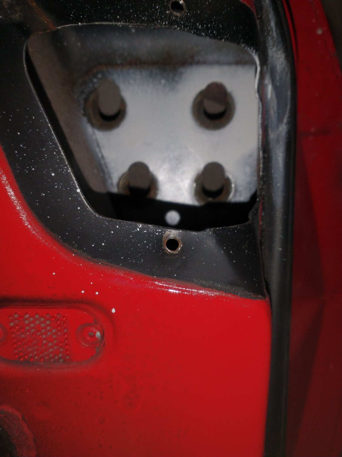

While you are in the door, take a look at the door open mechanism, locks, and hinges. Like they said,,,, get lots of degreaser spray the heck out of all the parts. Once the panel is off it isn't that bad to remove the door and refresh the hinge and the spring. The door comes off with the 4 bolts on the door. I spray painted a witness mark over the bolts so you know how to reinstall the door. NAPA has the brass hinge bushings. Do your research on how to install them, they are very easy to crush. The big ladder with straps worked very well to keep the door stable.
Oh no, not removing the doors.
The reveal on them is as perfect as it gets so I’m not opening that can of worms. From day one when this came home I made a list of things to be done and a complete regrease of the window mechanisms and locks was on it.
I am thinking some of these 55 year old parts (built in November of ‘67) are going to be worn beyond repair. I’m just glad that repos are available for them.
The ladder lift is a neat idea. I have either an engine hoist or a sliding electric crane I installed in the rafters of my barn shop to manage the heavy stuff.

It is a bit scary, but if you mark the hinge bolts it isn't that hard to get it back correct. I have done mine twice. If your hinges are good, no need. If your door sags or the springs don't hold the door open, it will only get worse.
