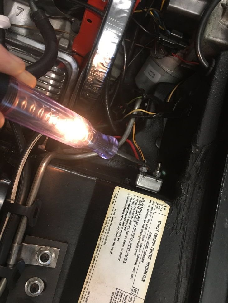

need location of power window circuit breaker on a 1972 corvette conv.

Check next to emission decal toward the engine on the brake bump out.
