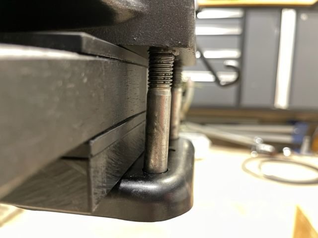

Quick question - installed Van Steel shortened composite spring on my 80-82 rear end - I pushed the spring back against the diff when installed - there's a gap between the spring and the rear bolts - I guess I would think that would not have a gap?

Certainly doesn't seem right. there would be nothing preventing it from rotating until it hit a bolt.
Best to give the guys at Vansteel a call in the morning and see what they say

The spring width installed seems to be 2 1/4" and the diff spacing is expecting 2 1/2" to mount a 2 1/4" spring in a diff for 2 1/2" you need to install the spacers.
like these.
C3 Corvette 1977-1979 Rear Leaf Spring Spacer - w/ FE 7 Option (corvettemods.com)
1977-1979 Corvette Leaf Spring Spacers Rear With FE7 Option | Eckler's Corvette (ecklerscorvette.com)
1977-1979 Corvette Rear Spring Shims with RPO FE7 Option (mamotorworks.com)
Most corvette vendors should have these. I didn't find them on vansteel website.
They install on both sides front / back side of spring.

I'm definitely seeing that in doing some research - I see that alot of composite springs come with a "box" around them making them the required 2.5" width. However, I can already see a problem with the spacer on the back side (facing front) as the 80-82 batwing has a small ledge that runs even with the rear post (single rear bolt) that is not going to allow the rolled end of the spacer to sit properly. It's almost like you need a flat spacer for that side. Perhaps I'll be able to mount both spacers on one side (rear of carrier where the two bolts are), that just manes the spring won't be "centered" between the front and rear bolts.

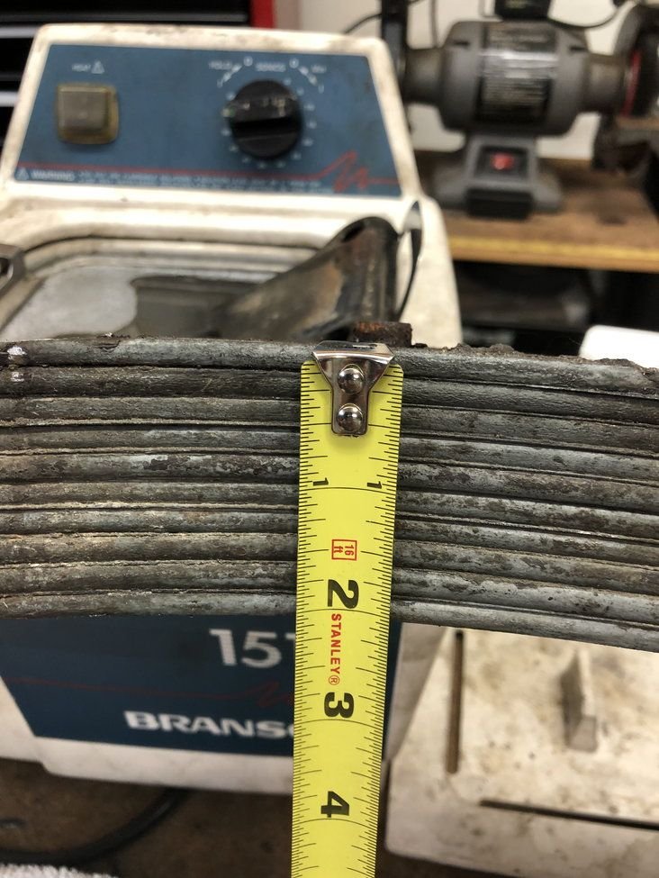

that's what i was thinking too.. got mine on ebay when i Gymkhana my 79 from 2.5 to 2.25
https://www.corvetteforum.com/forums...estions-2.html
How tall is that spacer? The other issue I see is if it's too tall in comparison to the thickness of my composite spring and spacer that's in there right now. Current installed height is 2.25"

well it seems that mine were 2.1 ish? and the spacer is smaller.. so ...should be OK?
