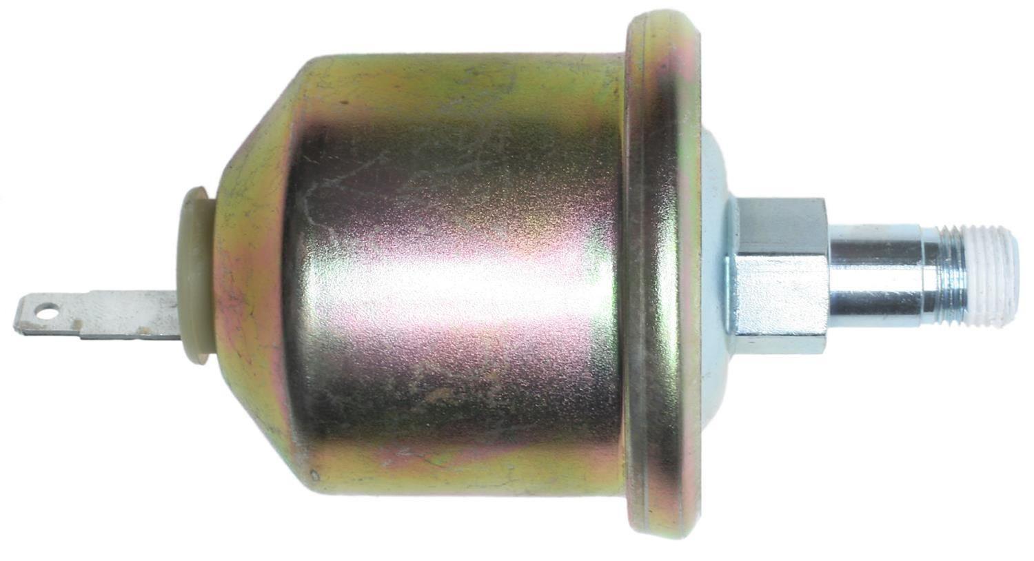

Thats your coolant temp sender.
This is what your Oil Pressure Sensor/Sender looks like ...

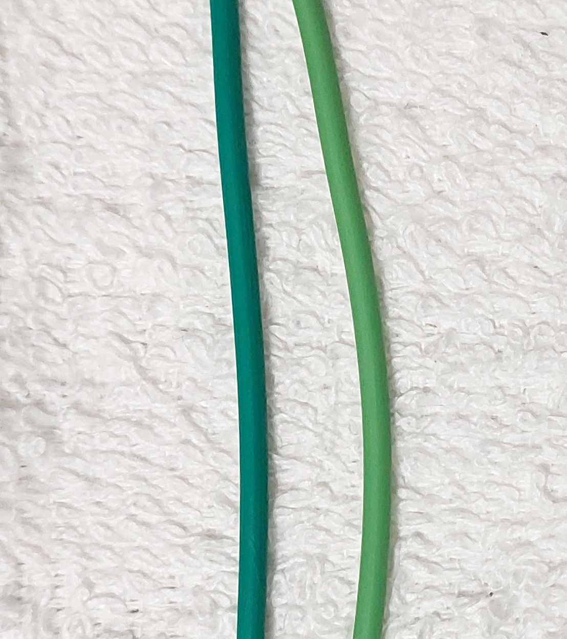

GM used a couple shades of Green.
Dk-GRN & Lt-GRN.
Spray a little brake clean on a rag and wipe the wire, most likely just a dirty Dk-GRN wire.
