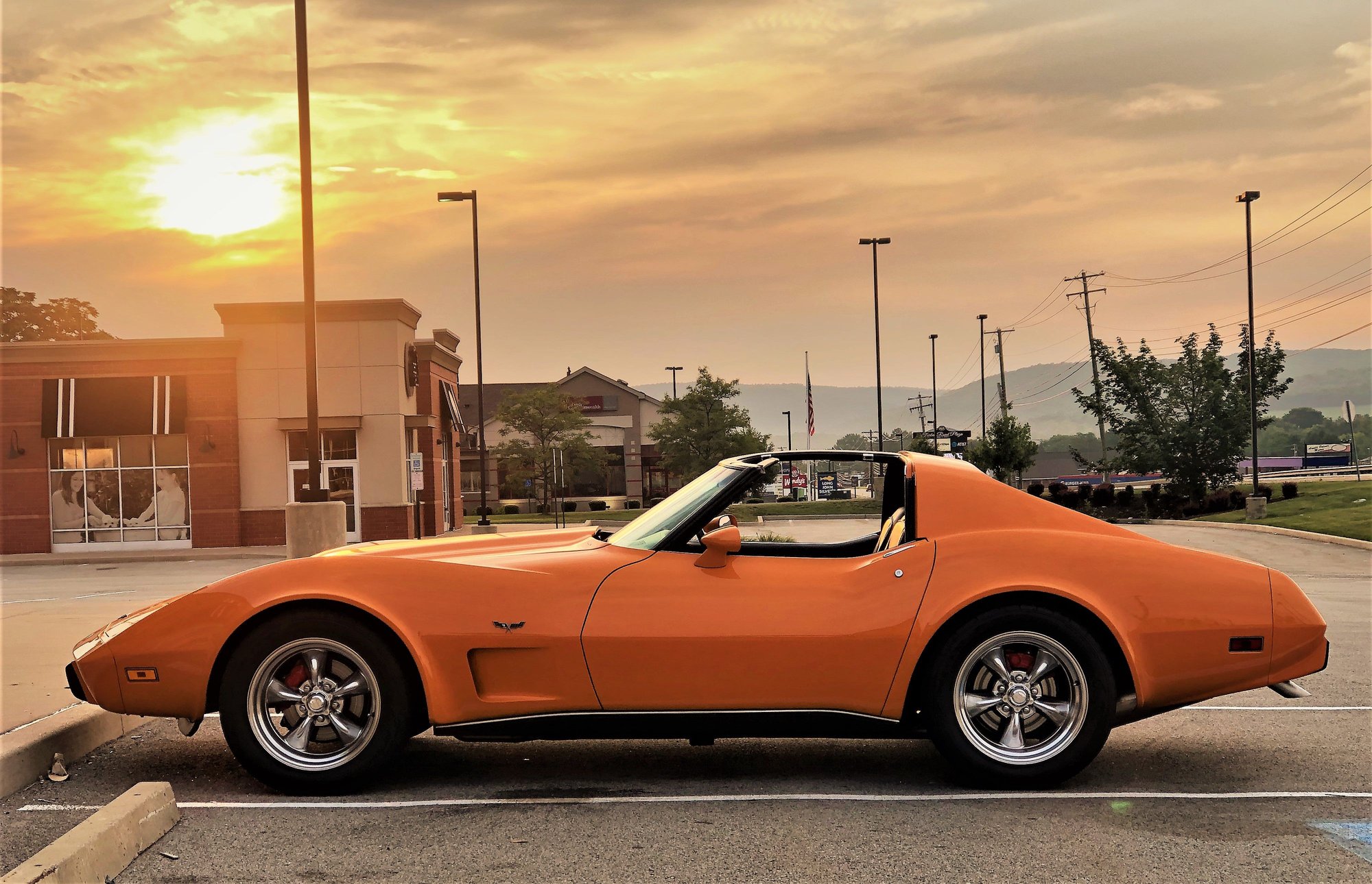

Old Sep 27, 2022 | 05:28 AM
Shovels and Vettes's Avatar
Shovels and Vettes
Joined: May 2008
Posts: 9,063
Likes: 2,736
Originally Posted by rabinaba
Hahaha! It’s not even about the car scraping. I daily drove a 350Z for 8 years, I can deal with worrying about scraping. I just genuinely don’t like the way the C3 looks slammed to the ground, especially with big 18” wheels. It just doesn’t look right to me, I’m trying to keep my upgrades classy.
I’d consider dropping it an inch, but I was planning on putting 17” rims on it. So I’ll have to see how that looks.
I was very resistant to going with bigger diameter wheels, because like you, I enjoy the classic look of 15 inch wheels and tires. BUT.....I wanted better tires on the pavement, and bought American Torq Thrust 17 inch wheels, with correct backspacing, etc. and put Nitto 555GT tires on it....10.5 inches of modern design sticky rubber on all four on the ground. Made a HUGE difference in handling, and I could not go back now. And honestly, the 17 inch wheels / tires, look pretty good......as for 18" and above.....it starts looking wrong to me. Too modern, and the classic look is given up to modern influences.
I also dropped the car app. one inch, and I think it looks perfect. The outside diameter of these tires is exactly the same diamater as the original tires the car was designed around, and the concentricity of the tire and wheel opening is perfect.

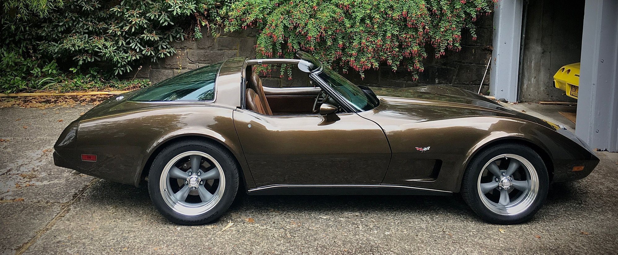

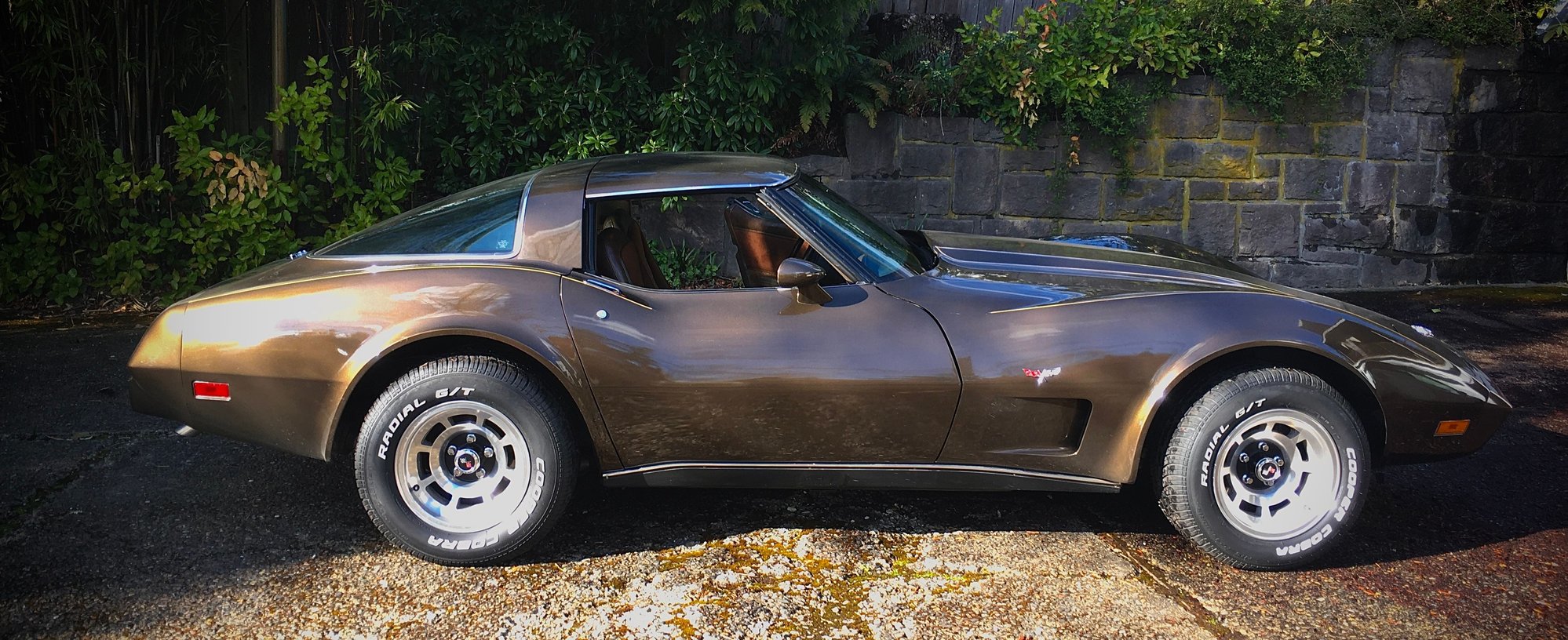

Old Sep 27, 2022 | 11:16 AM

Old Sep 27, 2022 | 12:37 PM

Here’s a before and after lowering 1” with Ridetech dual-rate springs in front and 8” bolts in rear. 15” to 18” wheels; same 27” diameter tires. Fender gap is now even all around the tire. Torque Thrust wheels are a classic look in themselves, which keep the 255/45/18 tires from looking too modern. Quick lane changes on the freeway feel much more stable. Tried multiple suspension adjustments to keep the car from feeling darty while crossing ruts in the road; this made the biggest difference.

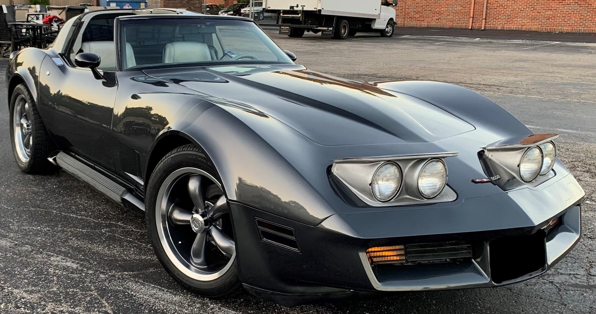

Old Sep 27, 2022 | 12:55 PM

This looks really nice as well. Let me ask you, since you have the same front bumper, after lowering the car and putting 18" wheels on, do the tires rub? Also, are those wheels the standard 27" height?

sci85's Avatar
sci85
Joined: May 2021
Posts: 225
Likes: 73
From: Missouri
No tire rub for me. It's actually pretty close to stock height in the front, maybe a 1/2" lower. I'd have to measure it again. Rear was dropped about 3/4" via longer bolts. 235/50R18 front, 275/40R18 on the rear running 18x8.5, 4.5" backspacing.
