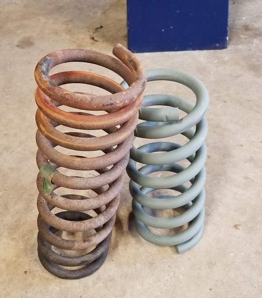

They probably are 550s. Perhaps Moog, perhaps not. They'll give you an inch drop in the front even uncut (both springs, and "after" photo for reference).
If you are starting from scratch, go with semi coil-overs in front. I'll be changing mine out at some point.

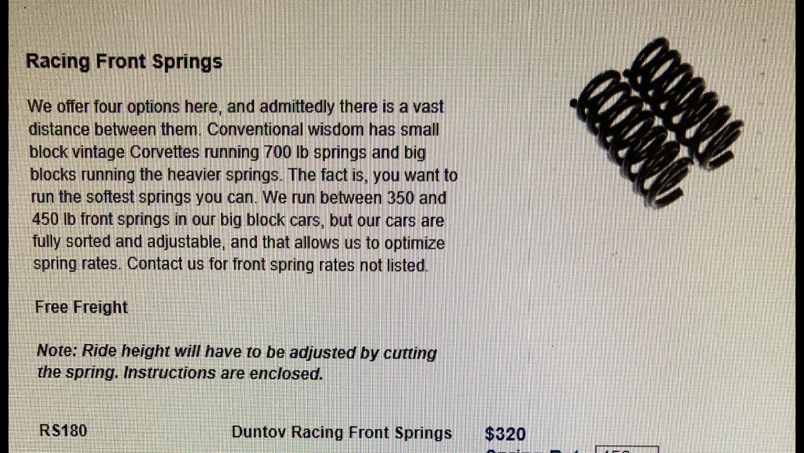

Heavy springs are a NO NO read this from Duntov racing

550 springs no. Did you not read post 28. All they are going to do is make it ride like a tank. One full coil off your old springs. It will still ride good and handle great. Spend the money on good shocks. And poly bushings on your sway bar

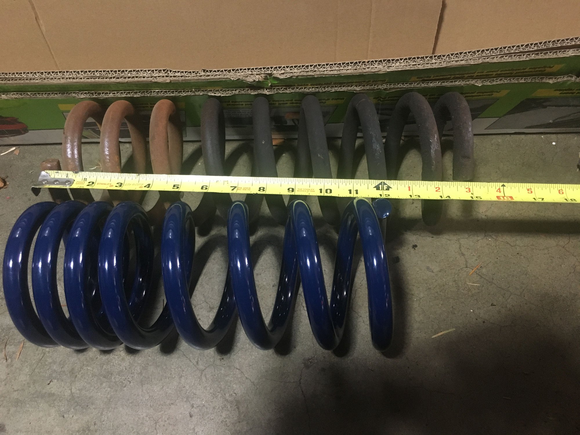

I know this thread is about a month old, but are these the Ridetech dual rate springs? I need some new springs (tried cutting a coil off my stock springs and it gives the ride height I like, but those springs are so tired and worn I’m afraid I’ll rip the oil pan off on a decent dip in the road) and am between the Ridetech and the 550lbs springs. Car is a ‘69 SB with aluminum heads and AC.
Old Oct 22, 2022 | 06:20 PM
  #40
rabinaba's Avatar
rabinaba
Joined: Aug 2022
Posts: 376
Likes: 57
The blue springs are in fact the RideTechs. I ended up going with them, but I haven’t gotten them on the car yet so I can’t tell you how they ride.
