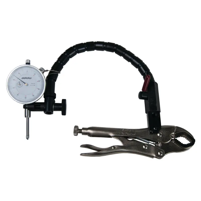

You do understand that driving with "pretty loose and chattering" can destroy stuff? If a motor isn't right shut it OFF! Cold lash and hot lash are only minor variances. You have to measure your motor cold and then check it when it's hot and record the differences. I won't go into a discussion of why 50 year old cam designs are VERY POOR choices along with weak springs and stamped rockers.
Part of Dukes PDF is referring to the 30-30 cam and I would question if the Crane cam has the same lobe design requiring altered solid lifter adjustment away from typical adjustment?
I worked at a historic road racing shop and learned a lot. One fact is the ambiguity on one persons .020 valve lash and another persons .020 valve lash. The tool to buy for setting valve lash is the magnetic or vice grip with dial indicator. I have some expensive dial indicators, but cheaper do work. How you use this tool is put the indicator on the rocker valve tip and set the dial to Zero, then you lift the rocker up and read the dial. You can run the rocker nut up or down to correctly set the lash every time.
This is just an example and you can find them for under $50. You want a stiff articulating arm and better dials always read the same consistently.
https://www.flexbar.com/products/fle...-indicator-kit
