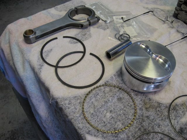

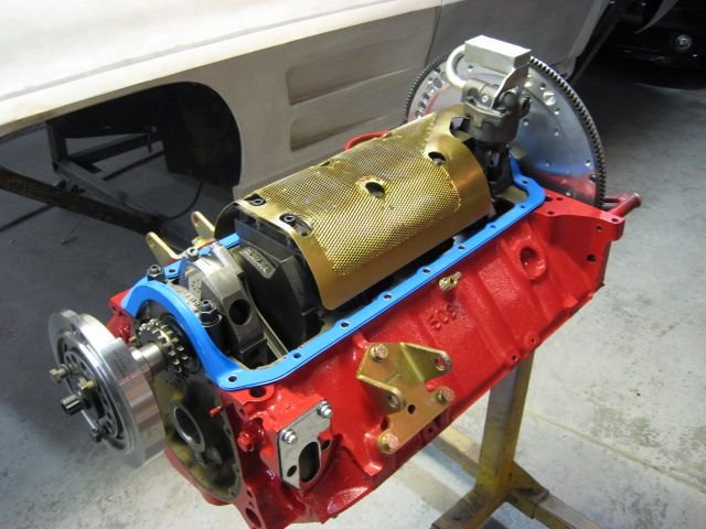

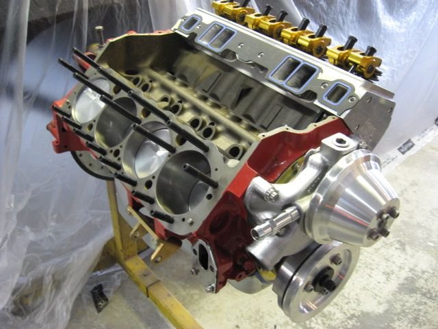

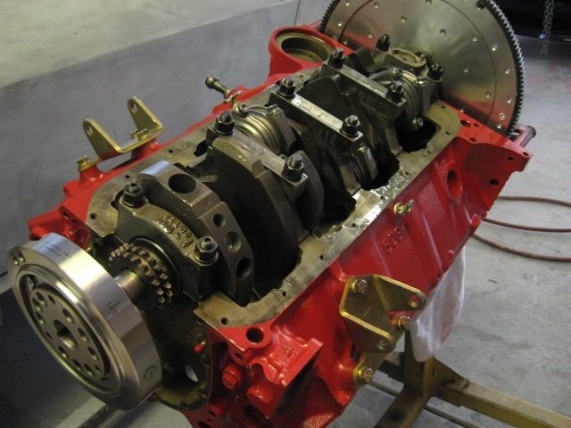

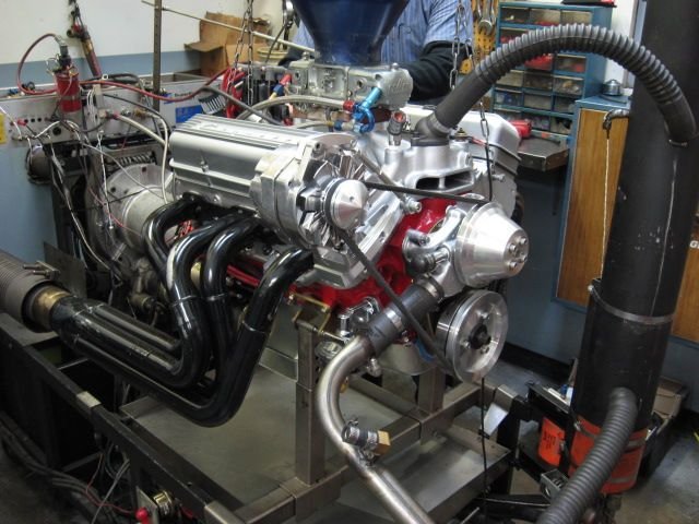

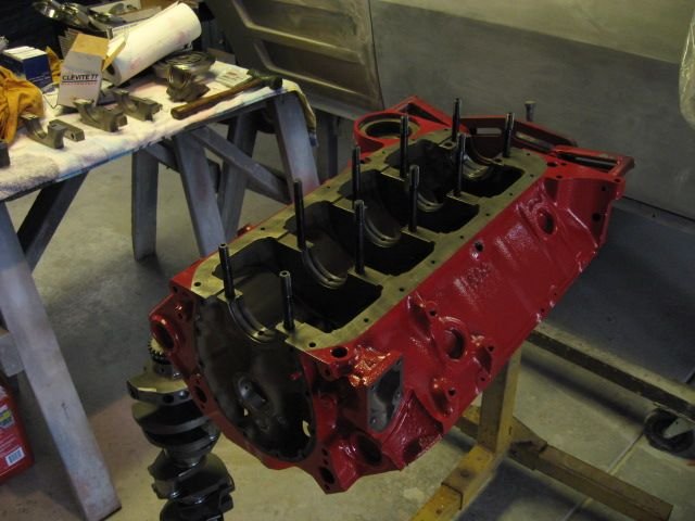

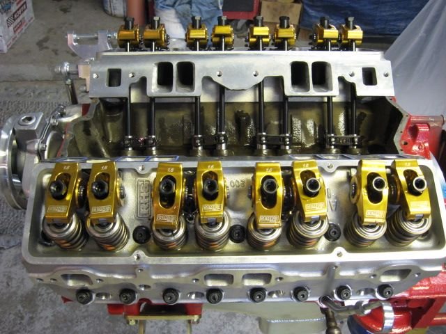

I'm running a 407 (400 SBC +.030 = 406.8) in my C2. Easy 500hp with 500 ft/lbs torque, so it's brutal on the street with the 3.73:1 rear and 4-speed. Solid roller with some nice forged pistons & rods (6-inch). I fabricated and installed main cap retaining bars and used studs on the bottom end of the 2-bolt block. RHS heads. I run 6,500 rpm shift points, but it has no problem with 7,000 rpm (although it's on the back-side of the power curve after 6500). I got the block and crank for free, because nobody wants a "stupid 400 truck engine." The 400 is a sweet, torquey setup that will rev with anything else. Do it!
On the dyno - it's an honest 500/500 motor:
All dropped in a nice all-stock car... nothing to see here:
