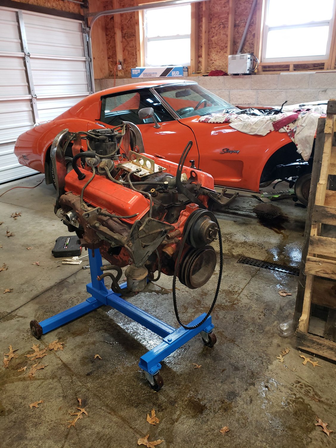

Just got the motor out today. Putting vortec heads, thumper cam, edelbrock 1406 carb. Of course intake and rocker arms etc. I am also doing a Borgeson conversion while the motor is out. Any tips or advice is welcome. This is the first motor upgrade I have ever done.

I would suggest a Quadrajet over the 1406 carb. Borgeson is a great upgrade. I love mine.

Why the thumper cam? Why not a cam that will actually make power?
Borgeson is a GREAT upgrade. Be sure to add a lot of caster, and get an alignment to make the most of it. I use SPC adjustable upper control arms.

Good call on the Borgeson. Why are you anti thumper cam. Do you think that with these mild upgrades a roller cam will really make much difference? Just curious what you mean. I am pretty much at the maximum lift with the thumper cam. Rockers are 1.52 ration and I can go up to .500 with these heads.

If you are going through the trouble of changing the cam, put in one that makes power, not just noise. There are plenty of choices that aren't roller cams. There's a specific Lunati cam that is similar to the LT-1/L82 cam that people seem to like. Or start a new thread and ask the Forum! You'll get lots of opinions.
Speaking of which, don't take my word for it on thumper cams.
Originally Posted by lars
Nope. Neither of the above. That "Thumpr" cam is just a heaping pile of bovine excrement. It has no purpose other than to sound "big." It produces no power under the best of conditions. Get rid of it and install a real cam.
https://www.corvetteforum.com/forums...mper-cams.html

the thumpr is a very tight lobe sep to make it sound like a really radical cam. the thumpr is designed to be idled in front of a bunch of people for the wow factor of the idle sound. as soon as you step on the gas, it sucks!

Another nix on the Thumper.

I take it you are posting your engine specs looking for an opinion. I will try to give my two cents worth without insulting anyone.
Vortec Heads are overrated. Much better ones out there. Needs special Intake.
Thumper Cam. **** cam.
Edelbrock carb. Half a **** carb.
Sorry. Just my 2 cents.

For the money and effort, I would go with aluminum heads, forget the Vortecs unless you already have them along with a low-rise intake to fit under the hood. I got a set of FREE Vortecs and a manifold. By the time I modified the heads to work with a higher lift cam, and bought another Vortec-specific intake because the free one wouldn't clear my hood, I wish I'd just gone with aluminum. The Vortecs are fine, but nothing spectacular. But they were free and I was on a budget. Still wish I'd gone aluminum.

IF you are staying below the .500 lift to save money, the Vortecs will save you money, but you will want a cam that will perform. GEt the smallest chambers you can so you can bump up your compression. CHeck the Comp Cams Extreme Energy line...490-/,490 lift with the split duration, More duration on the exhaust to get the gas out. its a hydraulic flat tappet, just make sure you google how to break in a flat tappet, and use good oil, high end filter, I like K&N, never a fram, I had one collapse and almost destroy and engine...kept dropping the oil pressure.
Also, Get big tube headers and 2.5 inch or 3 inch exhaust to help get the gas. Go with a Holley carb. You can make a Edelbrock work but you would want and AVS and it should be 700 to 750 cfm. Like everything they advertise the big number but they are actually smaller and you need 600 plus CFM, no need to choke your engine. They are easy to tune if you understand how they work. THe Holleys are more involved but are a better carb overall and most speed shops all carry Holley parts...not to many carry Edlebrock parts

If you Dont need to skimp, get some good 185-195 intake volume heads from Brodix, AFR or Trick flow, the chinese stuff wont flow that good out of the box and you will have to spend more to get them flowing close to the brand names. You get what you pay for and you can find them used in good shape for almost 1/2 to 3/4 what they are new, but you have to know what you are looking at. Make sure the valve springs are for hydraulic flat tappets, If you dont know what to look at or how to ask about springs and seat pressures then buy new and talk to the counter person at a speed shop, not an auto parts store. Or call the dealer directly. CompCams will get you into the right cam for the head and compression you have. I would figure out what your compression is and work around that to bump it up as far as you can
