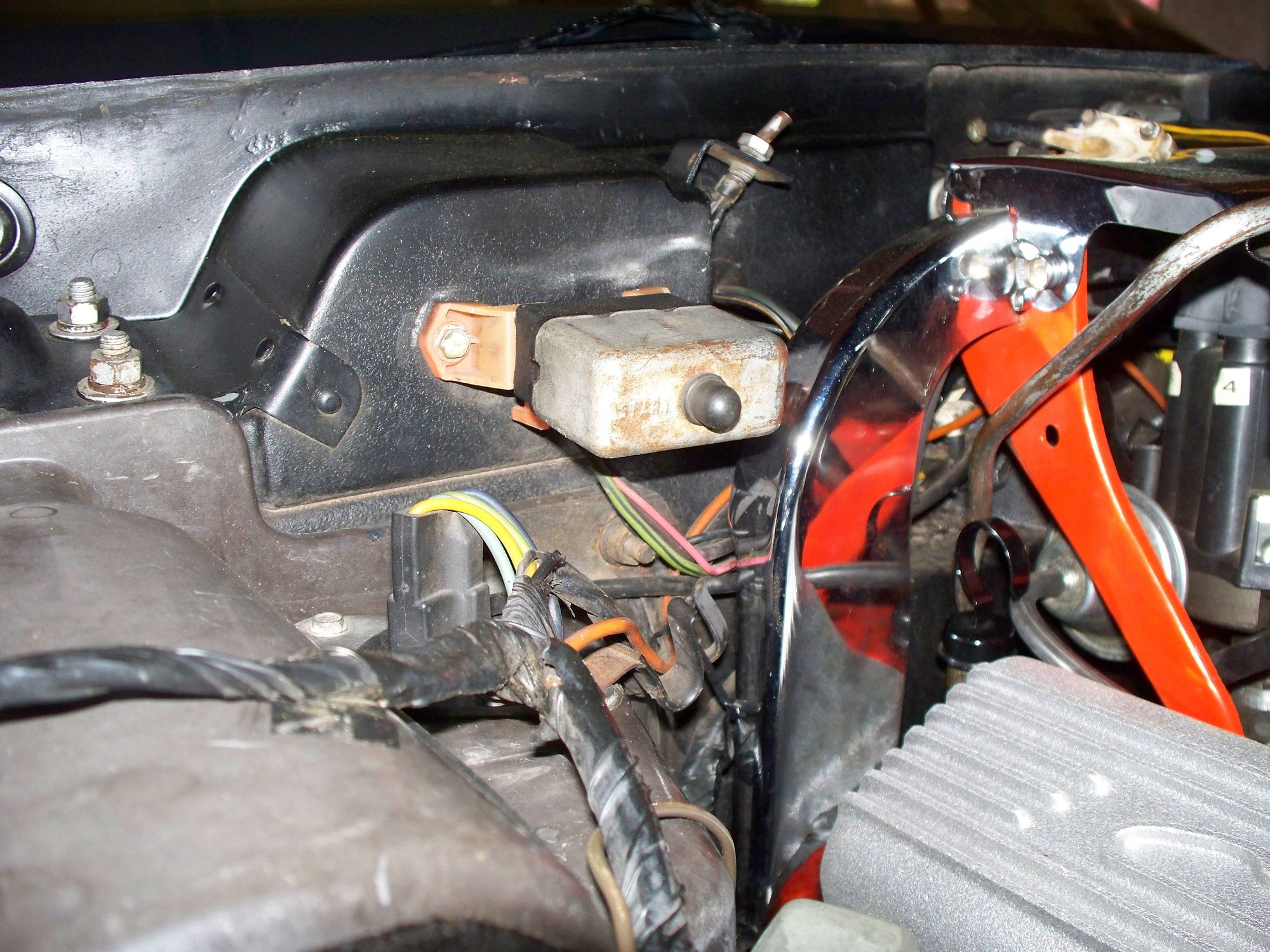

Some early '75s had a starter interrupt system, do you have this part on your firewall?:
I do not have that. That is the starter interlock override correct? That was what I was thinking it was from reading other forum posts but I did not have it on mine.

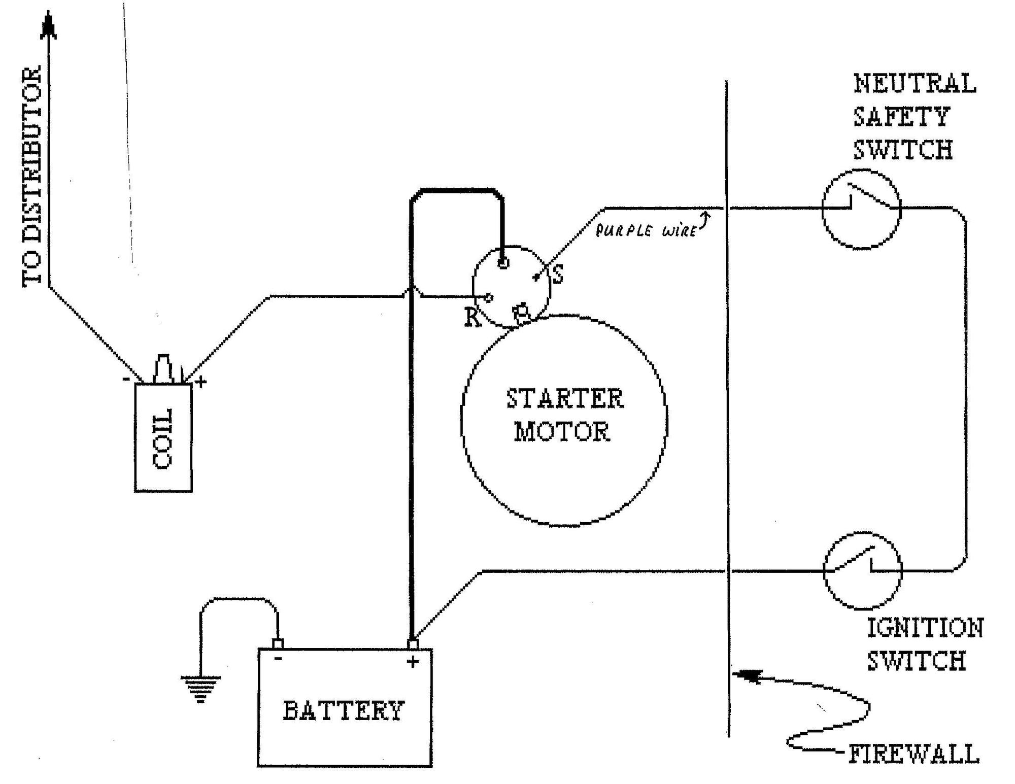

No starter interlock, good, that's one less thing to deal with.
Basic starter wiring:
Starter wires:
'75 schematic
http://wordpress.keystonestatecorvet...m/?page_id=118

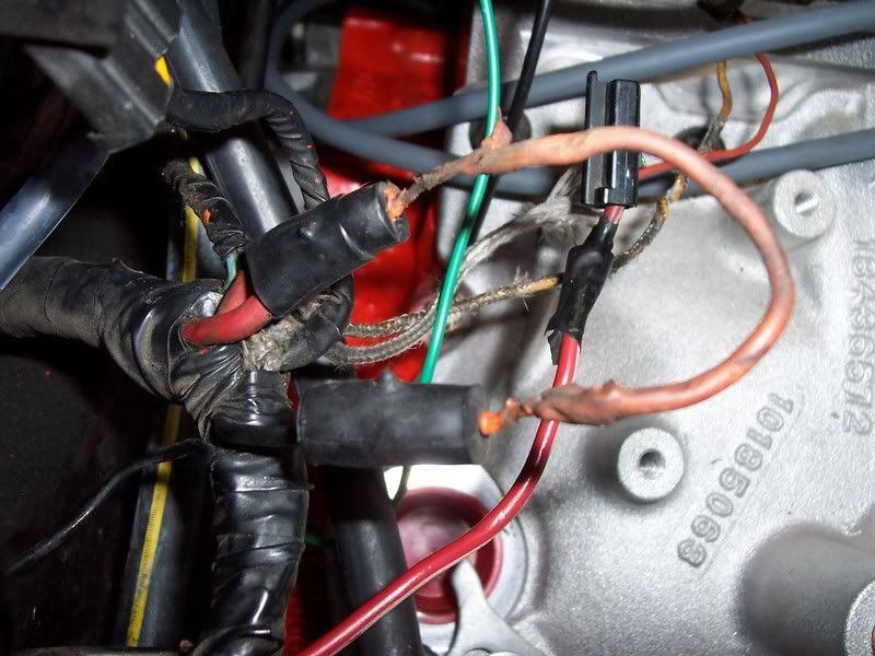

I checked all the wires going to the starter. I have the two big wires on the main post and the purple wire going to the S terminal. I read somewhere there are fusible links on those wires. Is that true?

Yes. The top solenoid post gets the main battery cable and 2 other wires, they bring power to the car and are protected with fusible links.
Here's an internet photo showing the fusible links ( black cylinders):

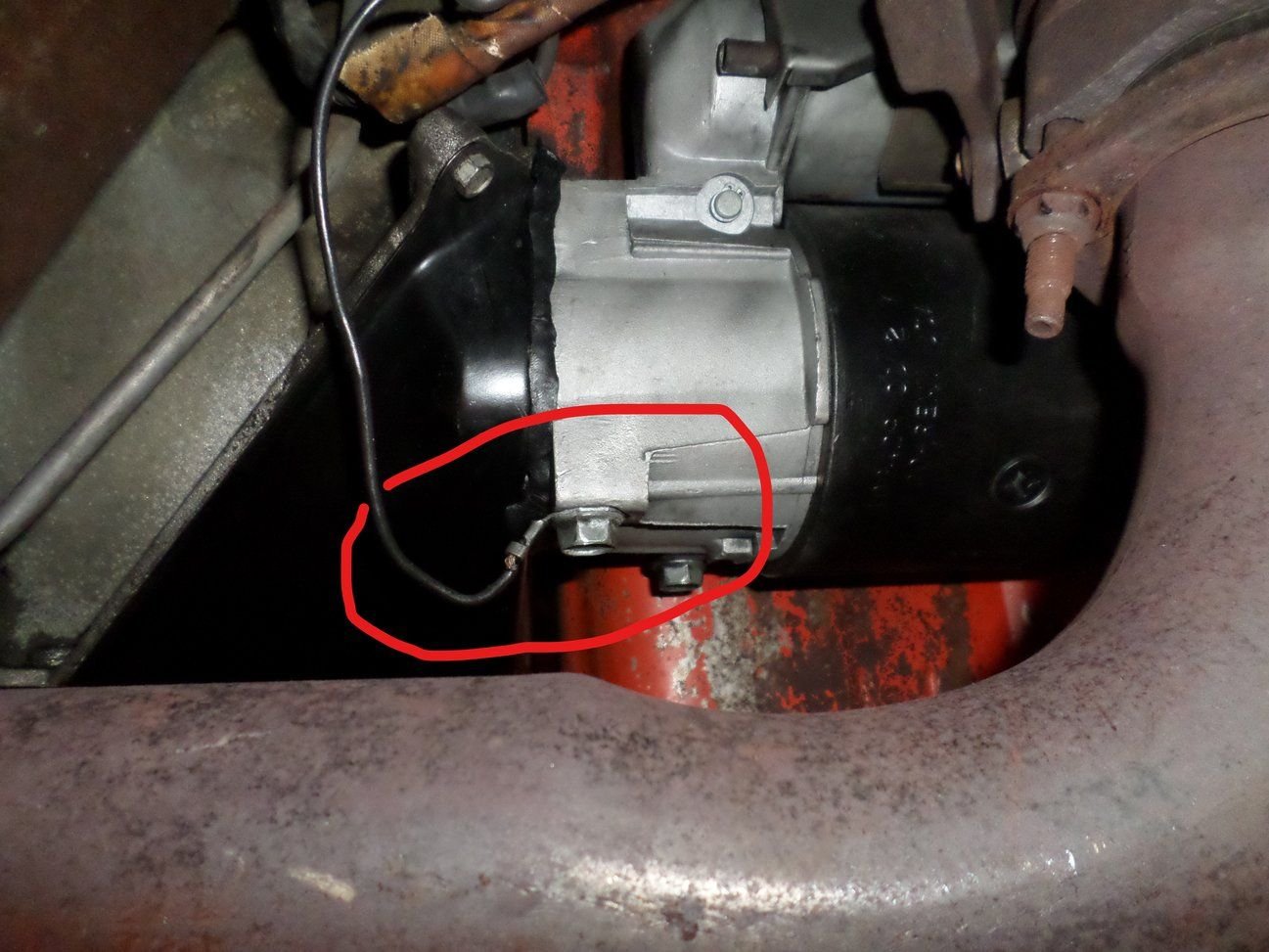

Down by the starter, there is a BLACK wire that gets connected to a starter or bell housing bolt.
