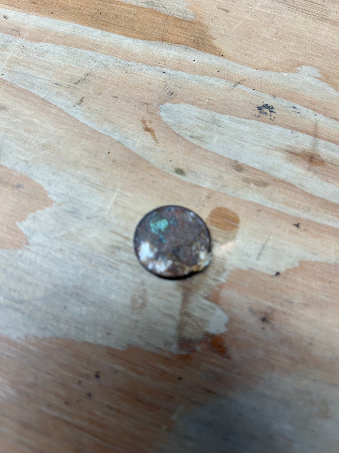

Originally Posted by Golferdad
A gallon of Evaporust from any auto part store,and let the parts sit 24 hrs,and clean as a penny.
This is the one and only thing I found hidden under the carpet.
Maybe I should clean it up and throw it under the new carpet for good luck!

Posts: 13,082
Likes: 3,399
From: SW Florida.
obviously needs to soak in something to come out like a new penny...

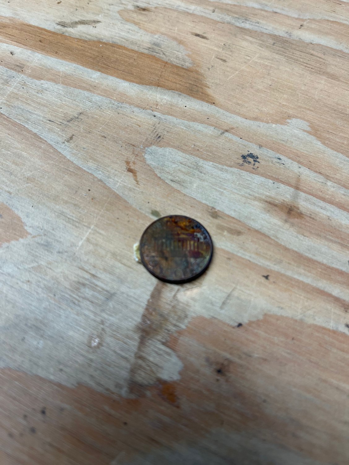

Old Nov 9, 2022 | 12:12 PM
  #36
Golferdad's Avatar
Golferdad
Joined: Feb 2022
Posts: 988
Likes: 183
From: South Carolina
Yea,a hr in Evaporust.although I think it’s about $35.00 a gallon.
