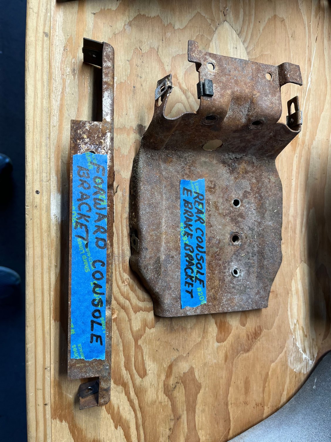

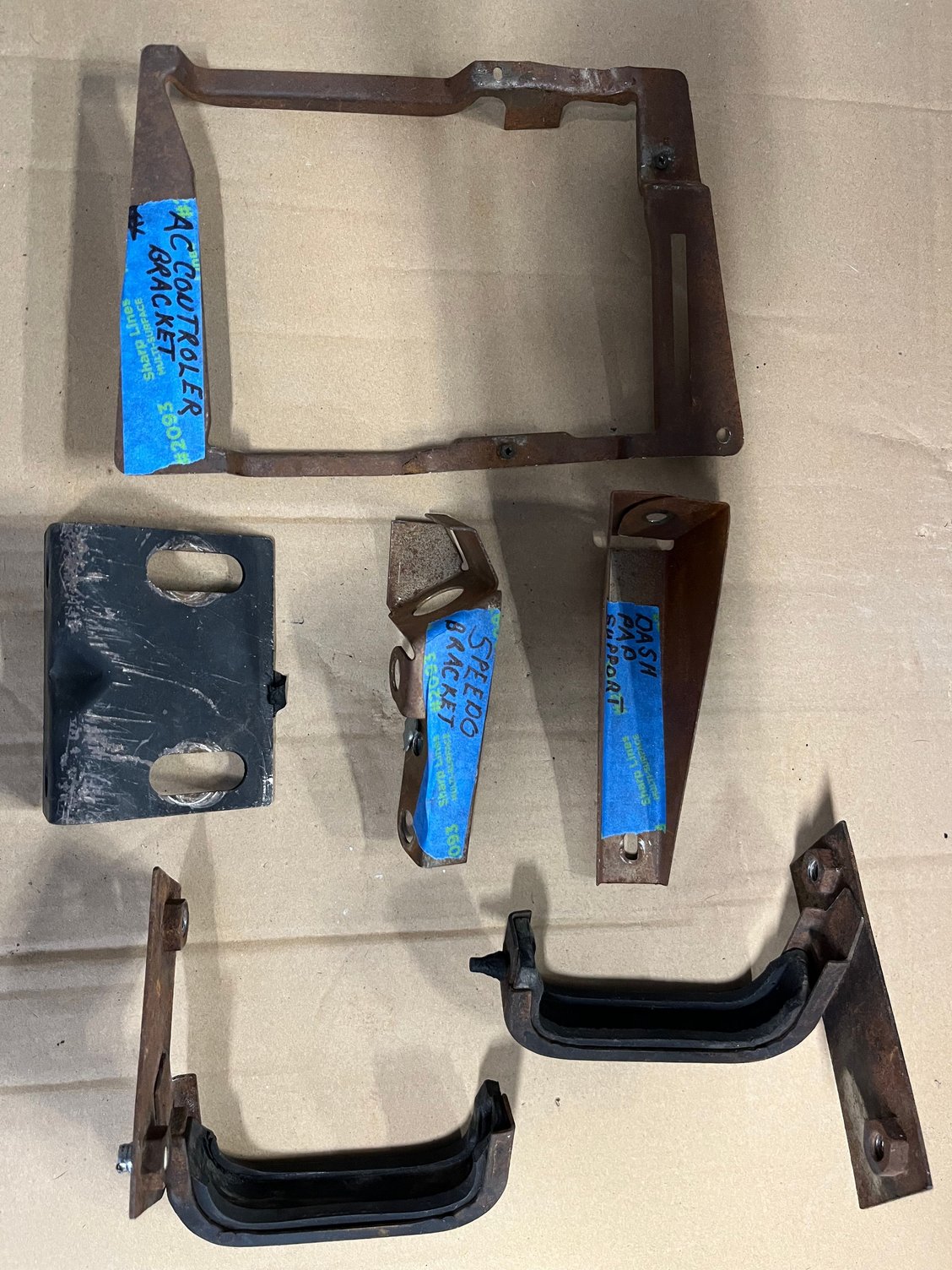

I’m doing some small things on my 73 project while I’m waiting to take the body and frame to the painter.
I have a box of small under the dash and interior brackets that were never painted at the factory and have built up some surface rust over the years.
They will never see the outside elements and I don’t think I need to spend the extra money for powder coating them so I plan to rattle can prime and paint them.
The brackets are delicate and include the ac controller bracket and dash support bracket shift console bracket and e brake assembly bracket.
I’m hesitant to use a wire wheel to clean and remove the rust and I was wondering what other method would work?
Is there a good dip available that will remove the rust?
What other method or product have you used to remove rust from small delicate parts?
