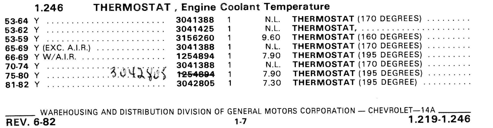

Understanding the range of thermostats and applications for emission, vacuum valves opening etc..
What is the ideal temperature for a thermostat not having to deal with emissions..?
my 79 L82 w ac as many others is 195f for lots of reasons emissions as well.. but i noted the large range for previous years, assuming performance and longevity of oils etc..was the priority..
I went with 180f as that is what i always remember when younger..
I am wondering now for a spirited all season driver, would it make sense to go even lower?? they even had 160f?? or maybe 170f to 74? Given the heat in the engine bay i could only think lower would be better but at what risk? if any with what cutoff?

it just seems to me that if GM put in 160° thermostats it could not hurt engine integrity. I can only assume that the temperatures came up for emissions purposes.
Seems like low hanging fruit on heat mitigation with these cars, and plenty to run my heater..
