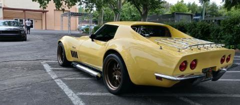

Default 69 vette
here's my 69 its in .

Originally Posted by 509 rat
here's my 69
that is a sweet ride, I dig the bronze wheels! What trans are you running?

Default 69 vette
Thanks its a t56 6 speed van steele suspension 1600 pound springs up front 650 in rear.

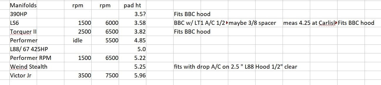

OK just so you are aware you lose a couple inches of possible manifold height.
Here are my manifold measurement notes I collected.
Looks like with an L88 hood you can run up to a 5.25" high intake.
There are many taller ones for a BBC that will not even fit under that hood.
AJRotham has a strong 10.50sec BB and runs a taller version of a L88 hood. Maybe a 4" rise vs 2.5" rise?
And I think you mentioned more HP than he has. You should look up his threads.
Good luck in your conversion, and enjoy your newfound torque & power!

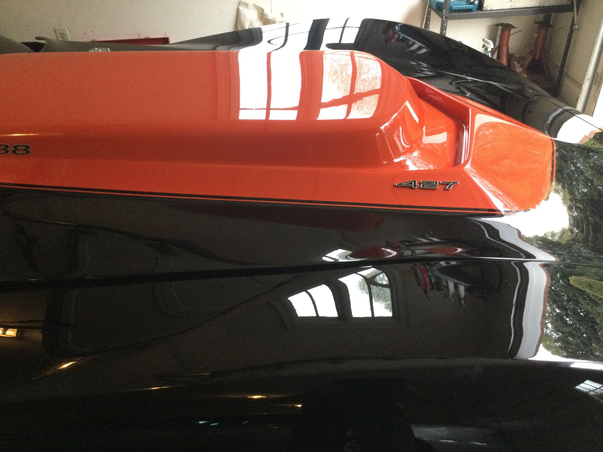

The main problem I have found with the L88 hood is that the intake needs the slope from back to front. The stock L88 hood doesn’t really give much clearance for taller intakes because they run out of room at the front. This is where the 5 degree slope helps. That’s why the 300-5 Holley Strip Dominator fits perfectly, whereas the Victor Junior doesn’t despite the rear being about the same height. I finally just modified my hood as the dyno really liked a 4 inch tall air cleaner over a 3 inch on my engine. I raised the front part of the L88 scoop, while leaving the windshield side at stock height. The one thing I didn’t like about the taller L88 hood is visibility. So my mod gave me more clearance where it is needed in front, but without the added height at the windshield. I am still running the Holley manifold though.
good info thanks you, I was running a Victor J on my sbc…. Looks like I may have some issues. I should clearing, I don’t have a stock L-88 just stock appearing I guess. It goes all the way to the windshield, I’m not sure if it’s taller than a stock one or not as I’ve never had one side by side.
Bill
interesting, I’d like to see a pic of that! I have looked at the much taller hoods and you are right, visibility looks limited. However raising the front part of the hood sounds like some challenging fiberglass work. I’ve done plenty of glass work but making that look right sounds tough.

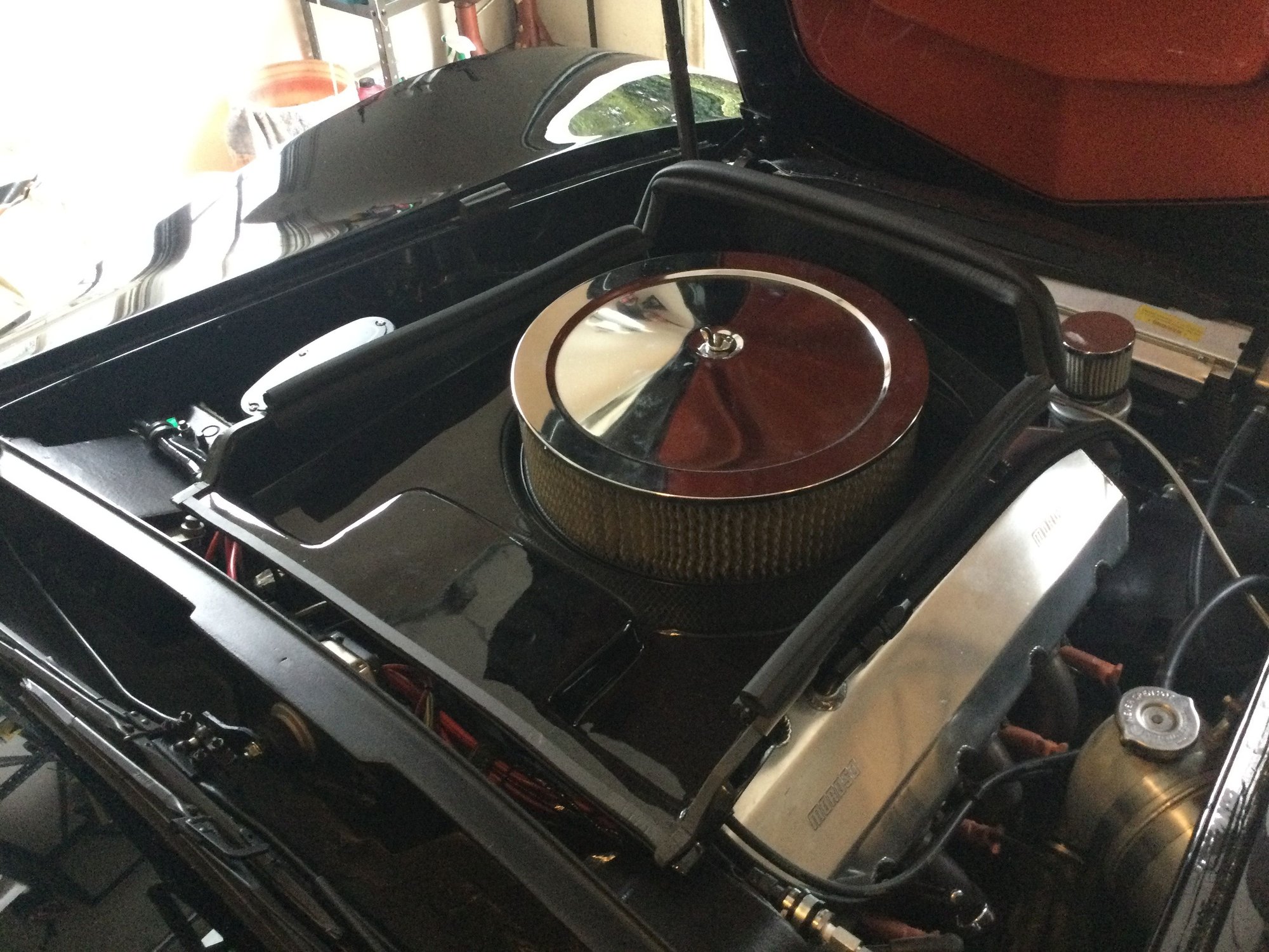

Here is my hood. I decided that instead of bonding the L88 airbox to the hood, I riveted the carb base to the airbox and am using it as a old air box. Works perfectly and that is a 4 inch tall air cleaner with the Holley Strip Dominator intake. Fits perfectly and is totally sealed to any air other than coming from the rear hood opening. The dyno loved the taller air cleaner. I think the reason is because of the L88 air cleaner base has a 2 inch drop, so the 4 inch clears some space above the carb throat.
Old Nov 12, 2022 | 01:05 PM
  #35
Amelio's Avatar
Amelio
Joined: Oct 2007
Posts: 816
Likes: 107
thats a sweet setup! What did you see power increase from the 3” to 4”? I currently run a 3” and the K&N lid on my small block.

Here is a nice 4" tall L88 hood for sale. "the Extra tall one"
You may need it if you want to run a tall BBC intake:
