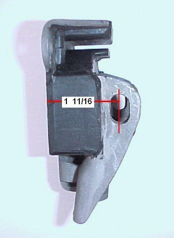

These are the dimensions of the motor mounts that you need.
You can buy them at a parts store.

I used Moroso 62530 solid mounts. Check for yourself, but the measurements seem to match @Peterbuilt's diagram. YMMV.
