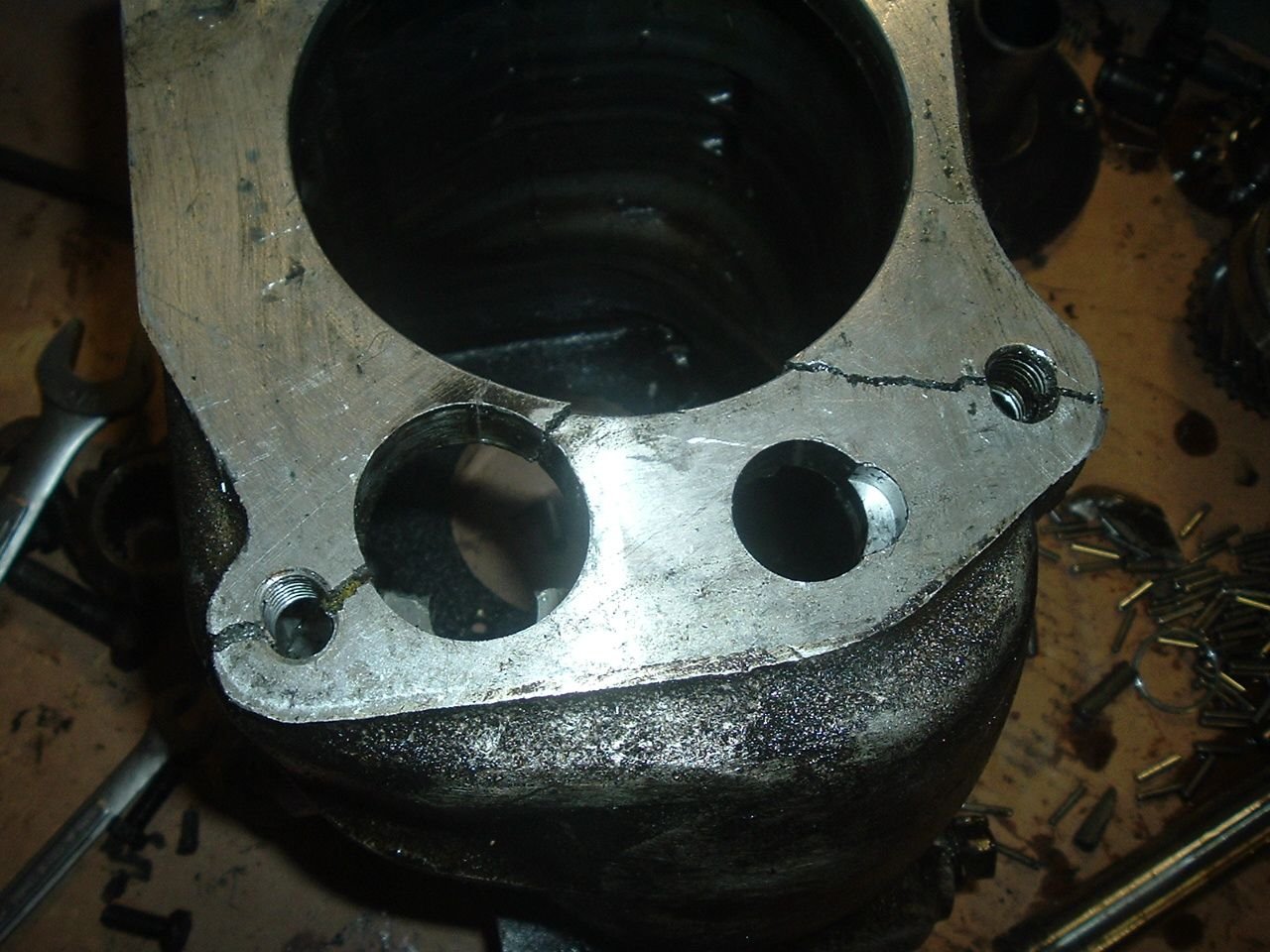

ST-10 after several passes at the strip and some hard abuse on the street. 375hp/350ci

so that was torque between the main and counter shafts just spreading the case until it split? any possibility a casting flaw in that case caused it and it was an anomaly, not the norm? looks like the drain plug was brazed. mebbe some eyediot thought he needed a hundred foot lbs to seal the drain plug?

Well possibly on the brazing but this was one of two that failed in my son's car. The other was a 50k mile untouched original. I like those transmissions, same with Muncies, but they won't hold up to a lot of hard use. The new cases are better and I have not seen one fail but who knows. TKO600 was used and replaced as power went up, G-Force was next. Not sure what goes up faster, the power or the price, probably the price. The G Force has 50 miles on it and may be up for sale, as a built TH400 is probably going in next.
