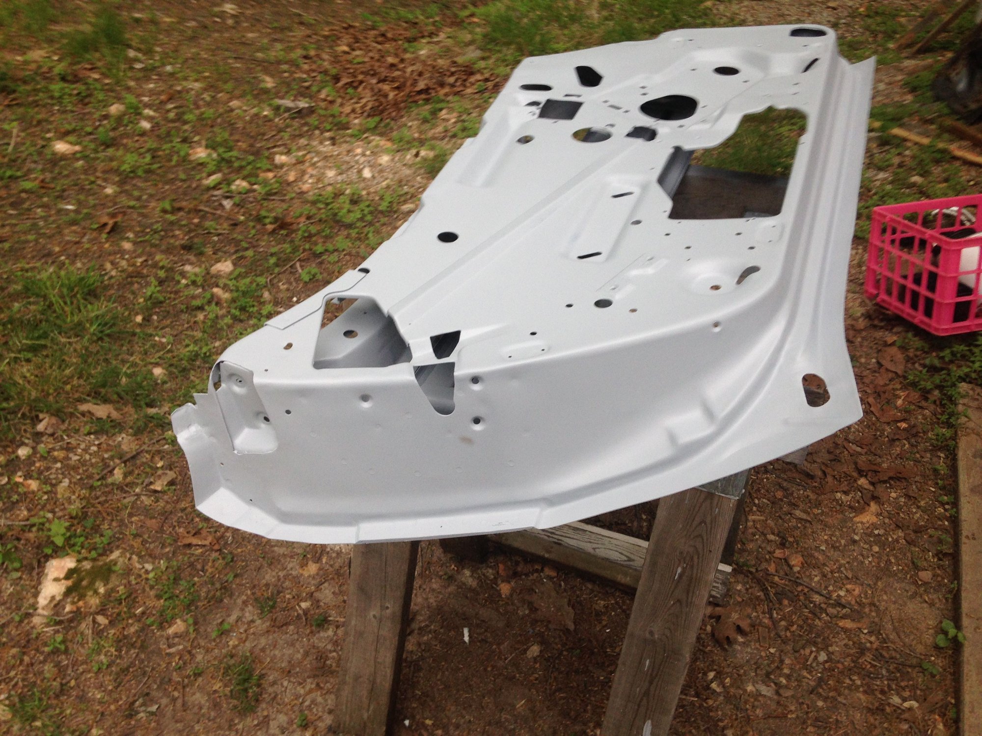

The early C3 convertibles did not have this alignment pin bolt. My 68 does not have them. Don't know when they first appeared. 69? 70? I assume this pin can be removed easily? Otherwise I believe the doors are the same. The window glass is not interchangeable.

That's what I've found as well, which is why I was confused. Attached is a pic of my door. So seems as though it should be easy to interchange the convertible and coupe doors - at least for 68 and 69.
Also, here is why I'm contemplating replacing the door (below).... Door opens and closes fine. I would prefer to not replace it, but this is what I'm dealing with. When you look at the door from the outside when it is closed, you can actually see where it is warped outward toward the bottom of the door. I didn't take pictures of that, but that's what it does. Absolutely abysmal bodywork by the previous owner.
