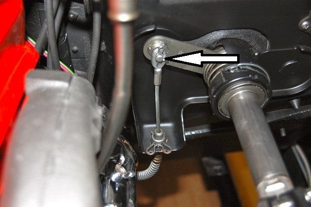

(I don't know if all C3s use the same components as my '72 so maybe this doesn't apply.) Disconnect the lock-out cable coming up from the transmission from the bracket on the firewall where the steering column enters the engine compartment.

Sorry for not getting back to you all earlier. My car is a 1979 with telescopic steering colum. I had contacted a locksmith in the past and he quoted me an outrageous price. ...like over $1,000. Im still laughing but I still need to unlock the steering.

Sorry you are still stuck....Here is a picture of the part of the steering lockout, not sure your's is exactly like this or not. The arrow is pointing to a cotter pin on a small shaft. Remove that pin, and then push the lever that the pin is holding 'up'. That might release your steering. If it is still locked then you'll have to take some of the column apart.

I called AAA today and they send a locksmith to my house. it only cost me $100.00 and AAA picked up the rest of the $300.00 tab.The guy pulled the steering wheel, horn assembly, hub and had a new switch in my colum in 15 min.Why I didn`t think of AAA before is beyound me! Thank you all for the help
