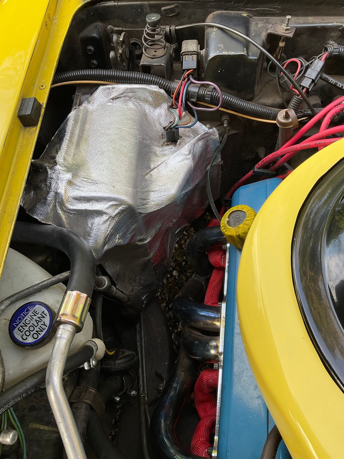

Here’s a pic of the clearance with Stan’s tri-y headers on a 78. Peel and stick insulation used on AC box to keep it cooler. Unfortunately these headers are now $1k more expensive than they were 10 yrs ago. These clear Borgeson as well. Mounting studs and Remflex gaskets for best seal.
Charlie
thanks for the pic and great info.
