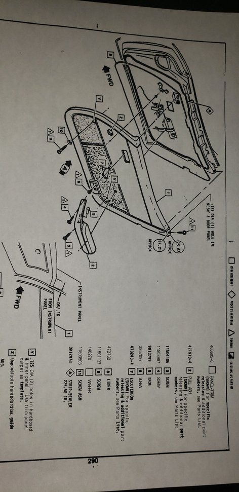

Old Nov 20, 2022 | 07:13 PM
rmrtrex's Avatar
rmrtrex
Joined: Apr 2021
Posts: 571
Likes: 101
From: Texas
Default Door card
Originally Posted by tdibiasio
Thank you....It is all original so no aftermarket stuff on this car. I would think that a loose ground would prevent the actuators from working. Instead they try locking all the time? Really strange. Wonder if anyone can test holding one of the power lock switches in the lock position to see what happens? Does it lock then try locking again as long as the switch is held? I'm will eventually take apart the door to see what's up but was hoping that it was something easy to fix. Any good videos on taking the door panel off of a 1980?
I am not a 100% on this but I don't think your car has that automatic feature of the doors locking. I have had 2 c3s a 1982 and a 1980, neither has had this setup. Granted my cars could have been the exception to the rule. As far as taking door card off. See picture

Old Nov 20, 2022 | 09:46 PM
tdibiasio's Avatar
tdibiasio
8th Gear
Joined: Nov 2022
Posts: 8
From: Austin, Texas
Thank you for the feedback and the diagram!
