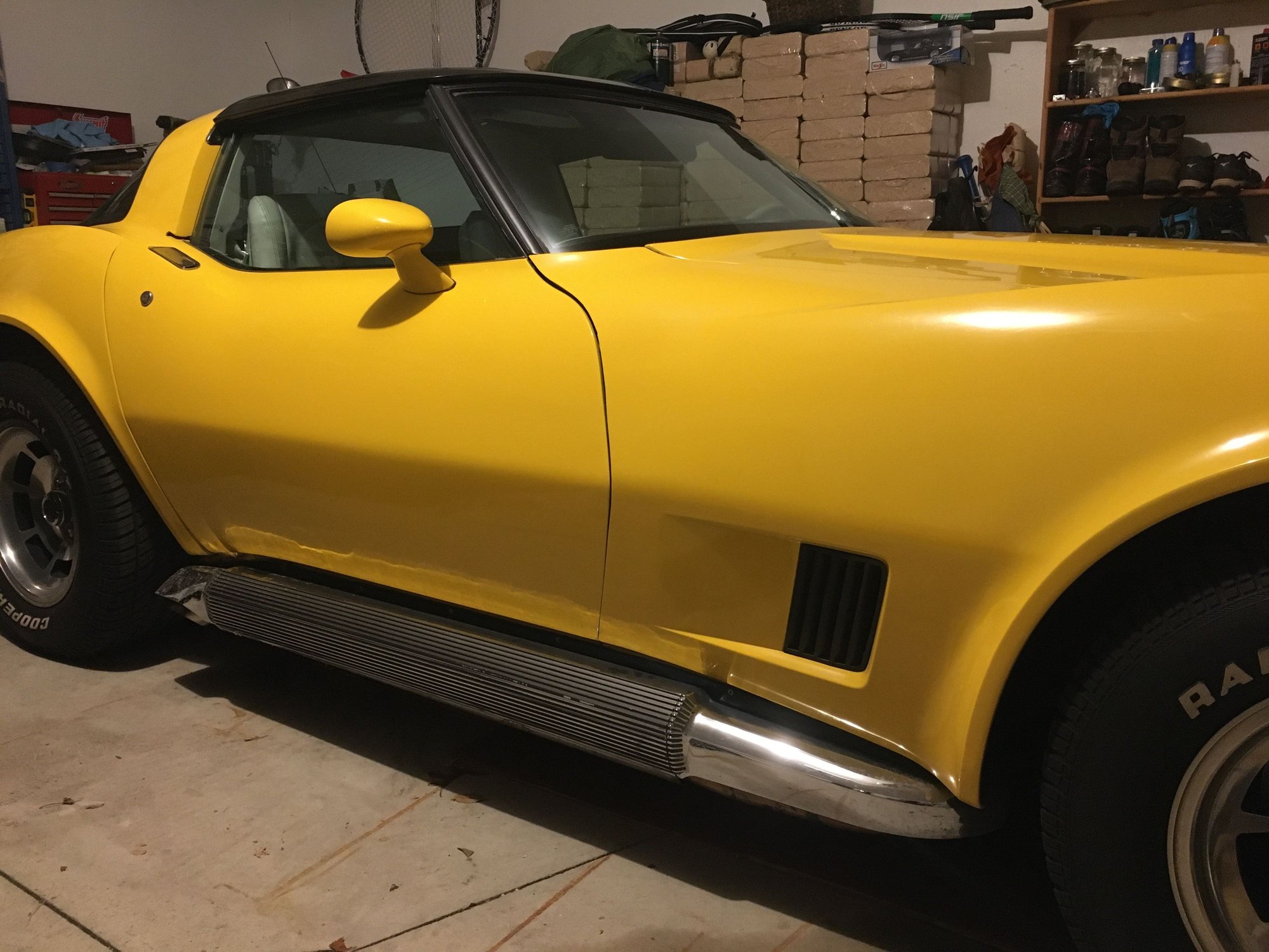

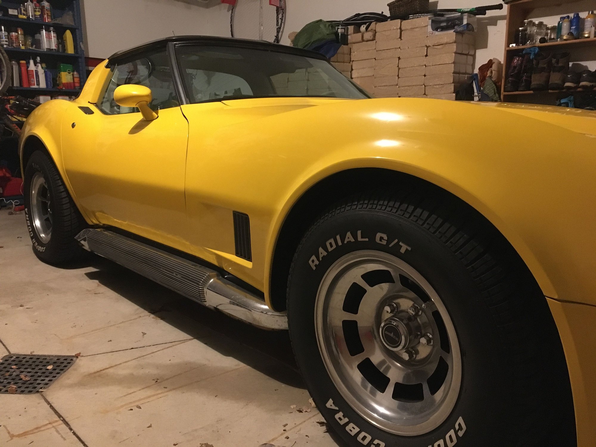

I have a 1980 car and I put the 1969 style side exhaust with original 69 covers because I like the look of the factory side pipe option from 1969. I got the stainless set from highfloperformance.com and they bolted right to the original exhaust manifold. Adding the covers required some modification on the front quarter and new threaded inserts under the original kick plate, but the change was not all that bad. I think they sell the ultra quiet pipes as well. I prefer a louder exhaust and it was perfect for me. I can post some photos if you want to see what it looks like.

Well...daylight would really have helped me out on these, but here are a couple of shots to help you make a decision.
