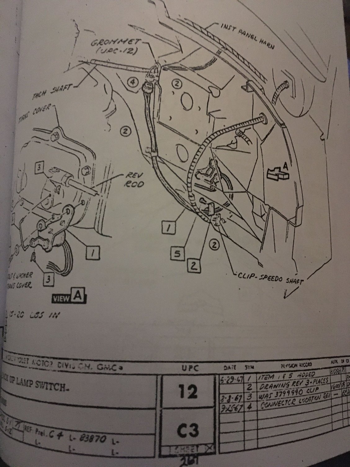

Not sure where that is but it looks like the reverse lamp wiring.
I know that because my ‘68
had no reverse lamps either because…. That wire was hanging in the breeze too. The guy doing the partial restoration neglected to reinstall the switch under the car.
that wire comes through where the tach cable goes thru the firewall hanging just below that.
I’ll look in the AIM and repost…

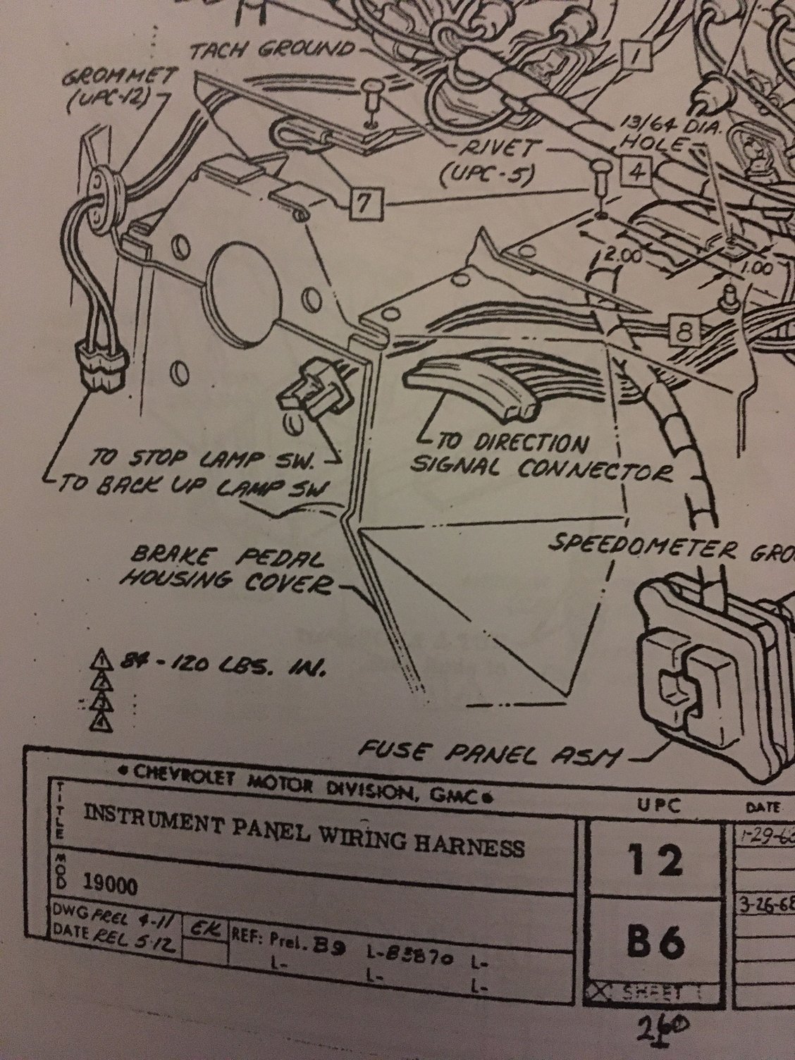

ok here are your two pages your looking for…
page 260, upc 12 B6
and page 267, upc 12 C3
* reading back thru I see this is in the center console area (?) then yes that would be the flashers connector which is the same as the backup lamps.

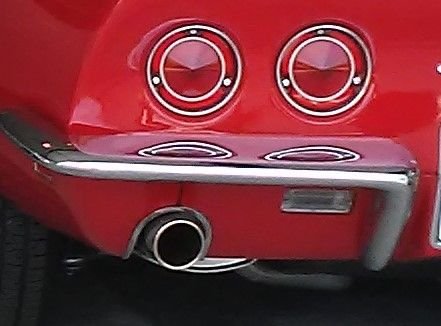

That's curious...I wonder if some 68's were initially built that way or some got changed over the years? Did they go to the BL's in the brake light assembly early on? Mine was built in mid August of 1968 and has the separate lights under the rear bumpers.

it’s probably a good bet that since ‘68 was the only C3 year with the back up lamps under the bumpers replacement panels weren’t made for it. Rather made to favor the numbers which would be the ‘68-‘73 years. If the ‘68 panels are available now it’s probably only been in recent years.
His was probably replaced after a fender bender many years ago with the only panel option available at the time.

Very interesting....I just noticed my 68 has the rectangular cut outs for the exhaust and no back-up lights. Just one more strange thing about this car !!!! I will crawl under to see if the wires are are there in the rear !

Rectangular cutouts says a ‘70-‘72 pan was installed . Either live with no backup lamps, install the correct pan or install ‘69 lamps that incorporate the backup lamps. It’d be a pain but I’d be inclined to install the correct pan.
Most prefer the ‘69 over the ‘68 but with I prefer it for all its one year only quirks .
