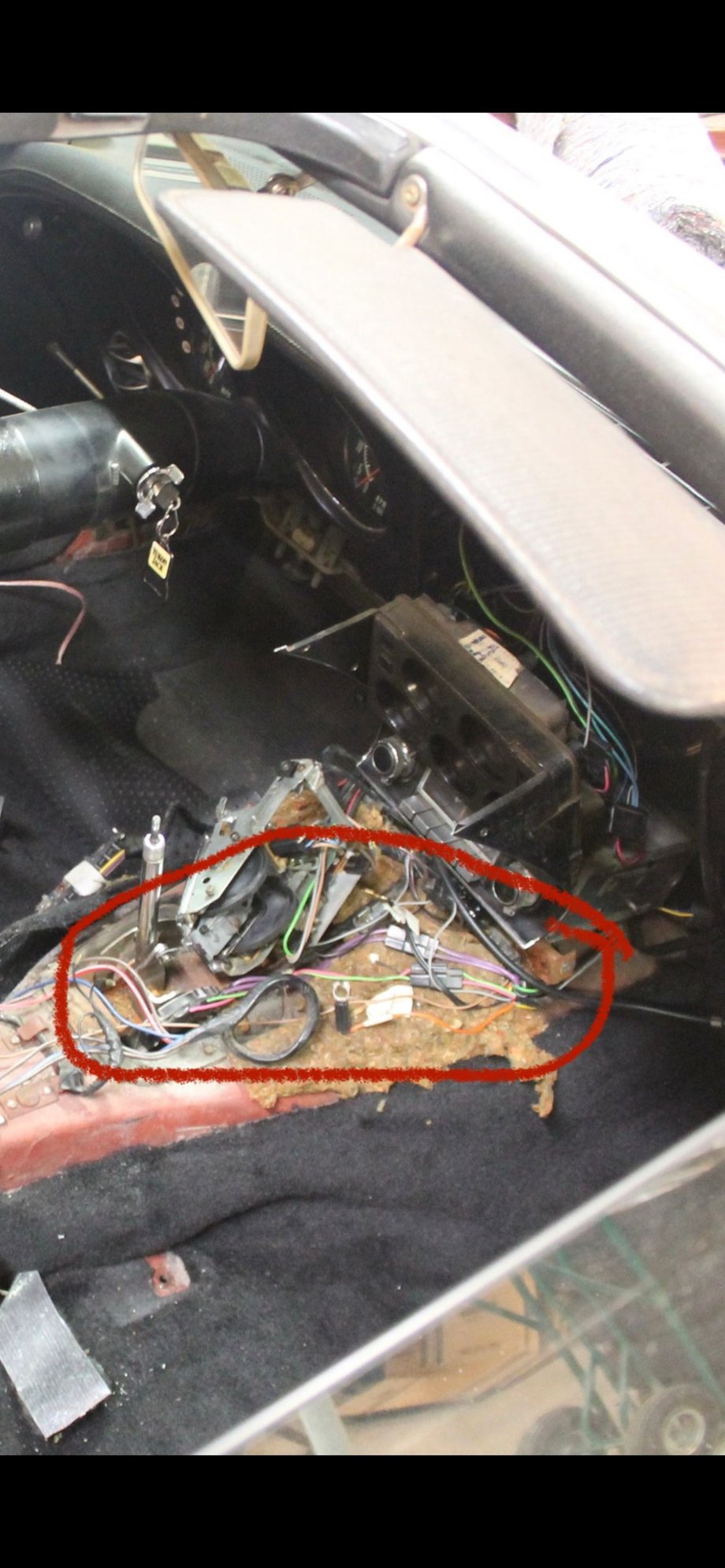

Can't find this in the AIM diagram. A plug with it appears to be P
ink & Light green wires on it !

68......It's in the harness going to the center gauge cluster and console !

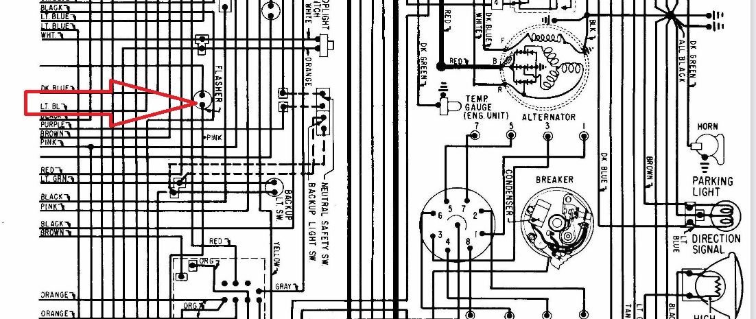

My first thought was for the turn signal flasher.

That was my first thought too. It does reach over as far as the passenger side where there is a clip for a flasher. But I also have a flasher under the center console with a heavy purple wire on one terminal & the other terminal has one heavy & one lighter red or pink wire on the other terminal. There is no flasher in the fuse block !

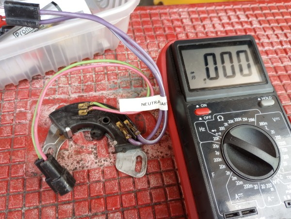

If it’s an automatic I’ll think it is shifter related.. Mine in the picture is a 70’ tho..

On the 4 speeds its your back up lights...probably still is

comes from under the dash area and should go through the firewall right of column through grommet and meet the back up switch at the trans in front of firewall

OK........It's definitely for the back up light switch ! But why is it inside of the car ? Not sure how I would get it thru the firewall with the plug on it. Not that it matters as there is no switch on the transmission anyway. And probably won't be after looking at the price for a switch and related parts. It would be nice to get it into the engine compartment where it belongs while I still have the dash apart ! Just one more strange things about this car. I just noticed the passenger side dash pad has the map pockets. I'm pretty sure 68's did not have those !!!!!

Sure looks like the colors for the back-up lights. I have not had them on mine for like 35+ years--- was not hooked up when I go the car with the M-21, and I did not bother hooking them up when I installed the Richmond ROD. I recently installed a 200-4R and I did use the other 2 leads for the Park & Neutral start interlock (was for clutch before I went to automatic).
